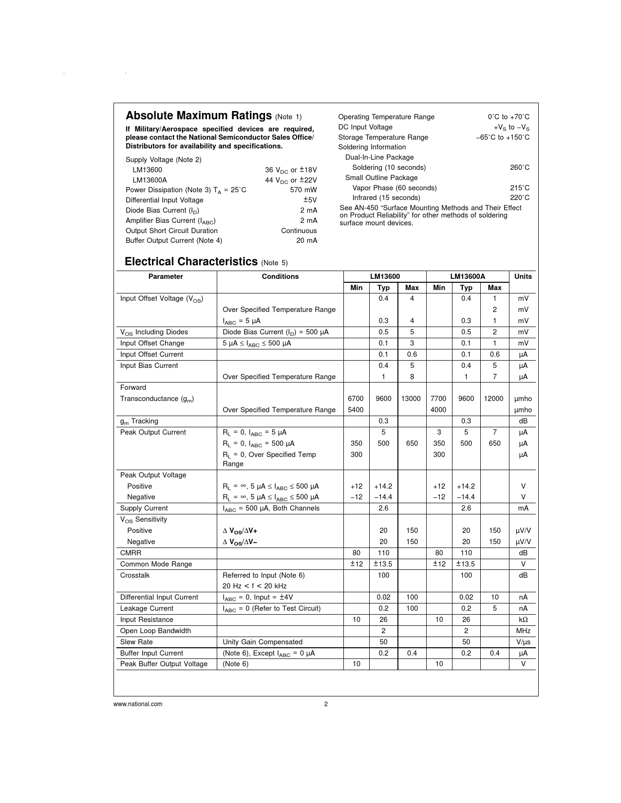

Absolute Maximum Ratings. If Military/Aerospace specified devices are required,
Absolute Maximum Ratings If Military/Aerospace specified devices are required,
(Note 1) Operating Temperature Range 0˚C to +70˚C
DC Input Voltage +V to −V S S
please contact the National Semiconductor Sales Office/
Storage Temperature Range −65˚C to +150˚C
Distributors for availability and specifications.
Soldering Information Supply Voltage (Note 2) Dual-In-Line Package LM13600 36 V or ±18V Soldering (10 seconds) 260˚C DC LM13600A 44 V or ±22V Small Outline Package DC Power Dissipation (Note 3) T = 25˚C 570 mW Vapor Phase (60 seconds) 215˚C A Differential Input Voltage ±5V Infrared (15 seconds) 220˚C Diode Bias Current (I ) 2 mA See AN-450 “Surface Mounting Methods and Their Effect D on Product Reliability” for other methods of soldering Amplifier Bias Current (I ) 2 mA ABC surface mount devices. Output Short Circuit Duration Continuous Buffer Output Current (Note 4) 20 mA
Electrical Characteristics
(Note 5)
Parameter Conditions LM13600 LM13600A Units Min Typ Max Min Typ Max
Input Offset Voltage (V ) 0.4 4 0.4 1 mV OS Over Specified Temperature Range 2 mV I = 5 µA 0.3 4 0.3 1 mV ABC V Including Diodes Diode Bias Current (I ) = 500 µA 0.5 5 0.5 2 mV OS D Input Offset Change 5 µA ≤ I ≤ 500 µA 0.1 3 0.1 1 mV ABC Input Offset Current 0.1 0.6 0.1 0.6 µA Input Bias Current 0.4 5 0.4 5 µA Over Specified Temperature Range 1 8 1 7 µA Forward Transconductance (g ) 6700 9600 13000 7700 9600 12000 µmho m Over Specified Temperature Range 5400 4000 µmho g Tracking 0.3 0.3 dB m Peak Output Current R = 0, I = 5 µA 5 3 5 7 µA L ABC R = 0, I = 500 µA 350 500 650 350 500 650 µA L ABC R = 0, Over Specified Temp 300 300 µA L Range Peak Output Voltage Positive R = ∞, 5 µA ≤ I ≤ 500 µA +12 +14.2 +12 +14.2 V L ABC Negative R = ∞, 5 µA ≤ I ≤ 500 µA −12 −14.4 −12 −14.4 V L ABC Supply Current I = 500 µA, Both Channels 2.6 2.6 mA ABC V Sensitivity OS Positive ∆
V /
V+
20 150 20 150 µV/V
OS
Negative ∆
V /
V−
20 150 20 150 µV/V
OS
CMRR 80 110 80 110 dB Common Mode Range ±12 ±13.5 ±12 ±13.5 V Crosstalk Referred to Input (Note 6) 100 100 dB 20 Hz < f < 20 kHz Differential Input Current I = 0, Input = ±4V 0.02 100 0.02 10 nA ABC Leakage Current I = 0 (Refer to Test Circuit) 0.2 100 0.2 5 nA ABC Input Resistance 10 26 10 26 kΩ Open Loop Bandwidth 2 2 MHz Slew Rate Unity Gain Compensated 50 50 V/µs Buffer Input Current (Note 6), Except I = 0 µA 0.2 0.4 0.2 0.4 µA ABC Peak Buffer Output Voltage (Note 6) 10 10 V www.national.com 2
