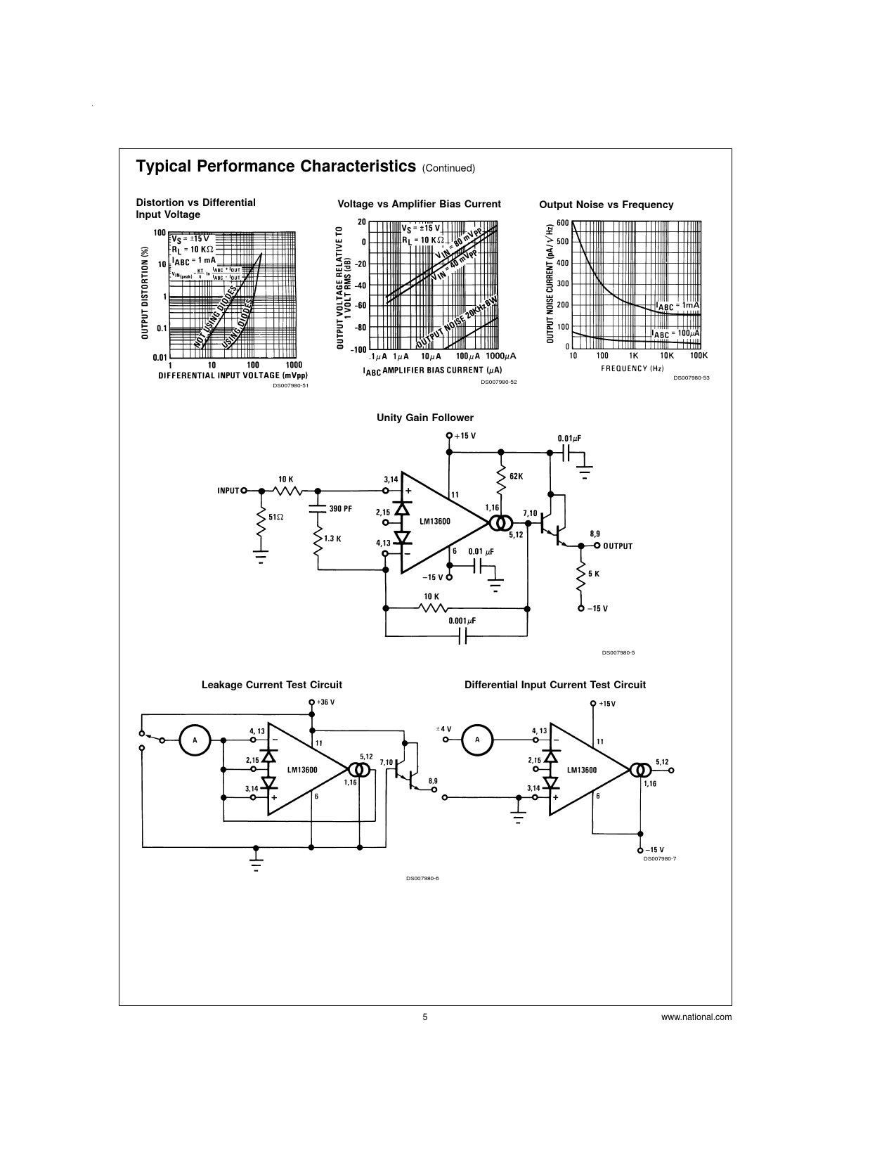

DescriptionDual Operational Transconductance Amplifiers with Linearizing Diodes and Buffers

Typical Performance Characteristics. Distortion vs Differential. Voltage vs Amplifier Bias Current. Output Noise vs Frequency
Typical Performance Characteristics Distortion vs Differential Voltage vs Amplifier Bias Current Output Noise vs Frequency
(Continued)
Distortion vs Differential Voltage vs Amplifier Bias Current Output Noise vs Frequency Input Voltage
DS007980-53 DS007980-52 DS007980-51
Unity Gain Follower
DS007980-5
Leakage Current Test Circuit Differential Input Current Test Circuit
DS007980-7 DS007980-6 5 www.national.com
