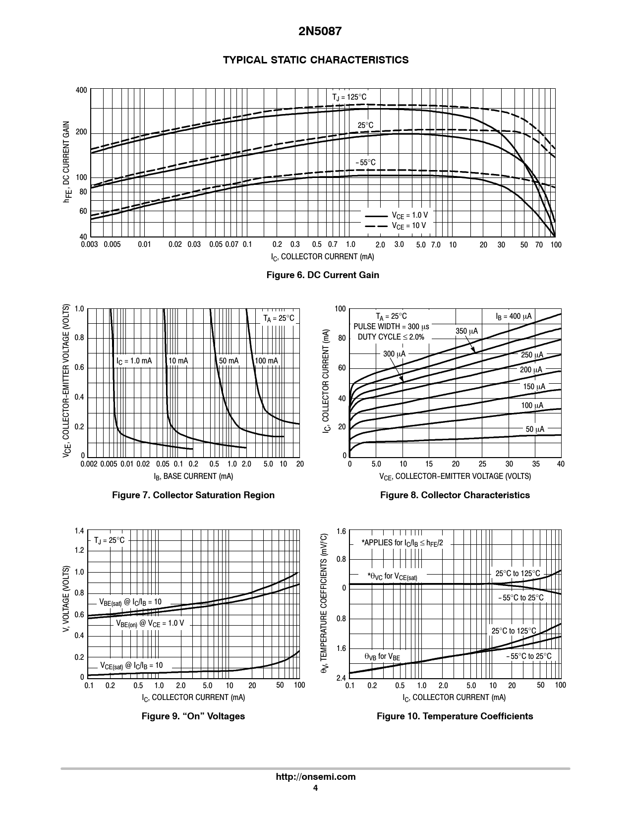

2N5087. TYPICAL STATIC CHARACTERISTICS. Figure 6. DC Current Gain. Figure 7. Collector Saturation Region
2N5087 TYPICAL STATIC CHARACTERISTICS Figure 6 DC Current Gain Figure 7 Collector Saturation Region
400 TJ = 125°C 25°C 200 -55°C 100 FE 80 h , DC CURRENT GAIN 60 VCE = 1.0 V VCE = 10 V 40 0.003 0.005 0.01 0.02 0.03 0.05 0.07 0.1 0.2 0.3 0.5 0.7 1.0 2.0 3.0 5.0 7.0 10 20 30 50 70 100 IC, COLLECTOR CURRENT (mA)
1.0 TS) 100 T T I A = 25°C A = 25°C B = 400 mA (VOL PULSE WIDTH = 300 ms 350 mA 0.8 80 DUTY CYCLE ≤ 2.0% TAGE 300 mA 250 mA IC = 1.0 mA 10 mA 50 mA 100 mA 0.6 60 200 mA 150 mA 0.4 40 100 mA 0.2 , COLLECTOR CURRENT (mA) 20 I C 50 mA , COLLECTOR-EMITTER VOL CEV 0 0 0.002 0.005 0.01 0.02 0.05 0.1 0.2 0.5 1.0 2.0 5.0 10 20 0 5.0 10 15 20 25 30 35 40 IB, BASE CURRENT (mA) VCE, COLLECTOR-EMITTER VOLTAGE (VOLTS)
Figure 7. Collector Saturation Region Figure 8. Collector Characteristics
1.4 1.6 T C) J = 25°C ° *APPLIES for IC/IB ≤ hFE/2 1.2 0.8 TS) 1.0 *q 25°C to 125°C VC for VCE(sat) (VOL 0 0.8 - 55°C to 25°C VBE(sat) @ IC/IB = 10 TAGE 0.6 0.8 , VOL VBE(on) @ VCE = 1.0 V V TURE COEFFICIENTS (mV/ 25°C to 125°C 0.4 1.6 0.2 q TEMPERA VB for VBE - 55°C to 25°C V , CE(sat) @ IC/IB = 10 Vθ 0 2.4 0.1 0.2 0.5 1.0 2.0 5.0 10 20 50 100 0.1 0.2 0.5 1.0 2.0 5.0 10 20 50 100 IC, COLLECTOR CURRENT (mA) IC, COLLECTOR CURRENT (mA)
Figure 9. “On” Voltages Figure 10. Temperature Coefficients http://onsemi.com 4
