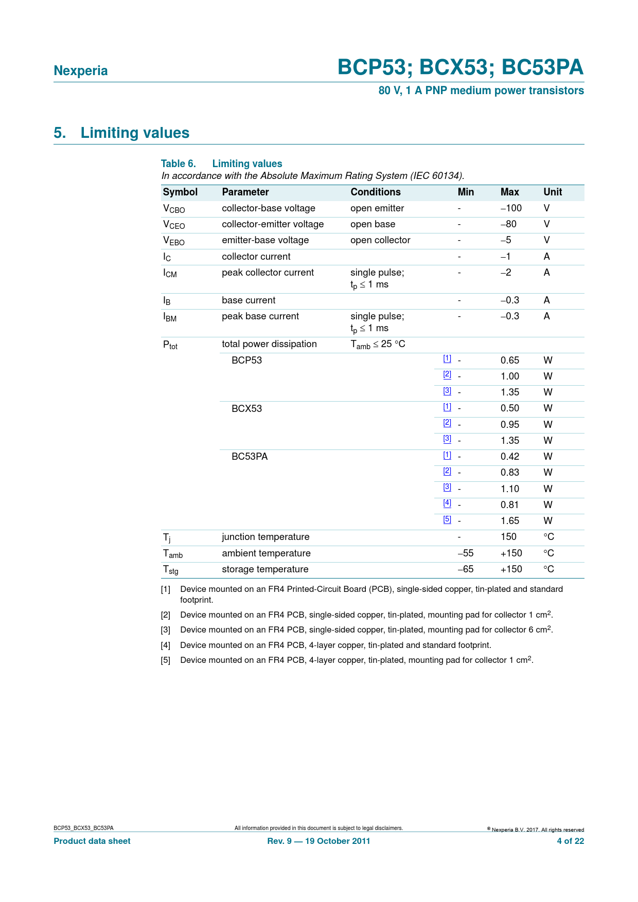

Nexperia. BCP53; BCX53; BC53PA. 80 V, 1 A PNP medium power transistors. Limiting. values. Table 6. Limiting values. Symbol. Parameter
Nexperia BCP53; BCX53; BC53PA 80 V, 1 A PNP medium power transistors Limiting values Table 6 Limiting values Symbol Parameter
link to page 4 link to page 4 link to page 4 link to page 4 link to page 4 link to page 4 link to page 4 link to page 4 link to page 4 link to page 4 link to page 4
Nexperia BCP53; BCX53; BC53PA 80 V, 1 A PNP medium power transistors 5. Limiting values Table 6. Limiting values
In accordance with the Absolute Maximum Rating System (IEC 60134).
Symbol Parameter Conditions Min Max Unit
VCBO collector-base voltage open emitter - 100 V VCEO collector-emitter voltage open base - 80 V VEBO emitter-base voltage open collector - 5 V IC collector current - 1 A ICM peak collector current single pulse; - 2 A t  p 1 ms IB base current - 0.3 A IBM peak base current single pulse; - 0.3 A t  p 1 ms P  tot total power dissipation Tamb 25 C BCP53 [1] - 0.65 W [2] - 1.00 W [3] - 1.35 W BCX53 [1] - 0.50 W [2] - 0.95 W [3] - 1.35 W BC53PA [1] - 0.42 W [2] - 0.83 W [3] - 1.10 W [4] - 0.81 W [5] - 1.65 W Tj junction temperature - 150 C Tamb ambient temperature 55 +150 C Tstg storage temperature 65 +150 C [1] Device mounted on an FR4 Printed-Circuit Board (PCB), single-sided copper, tin-plated and standard footprint. [2] Device mounted on an FR4 PCB, single-sided copper, tin-plated, mounting pad for collector 1 cm2. [3] Device mounted on an FR4 PCB, single-sided copper, tin-plated, mounting pad for collector 6 cm2. [4] Device mounted on an FR4 PCB, 4-layer copper, tin-plated and standard footprint. [5] Device mounted on an FR4 PCB, 4-layer copper, tin-plated, mounting pad for collector 1 cm2. BCP53_BCX53_BC53PA All information provided in this document is subject to legal disclaimers. © Nexperia B.V. 2017. All rights reserved
