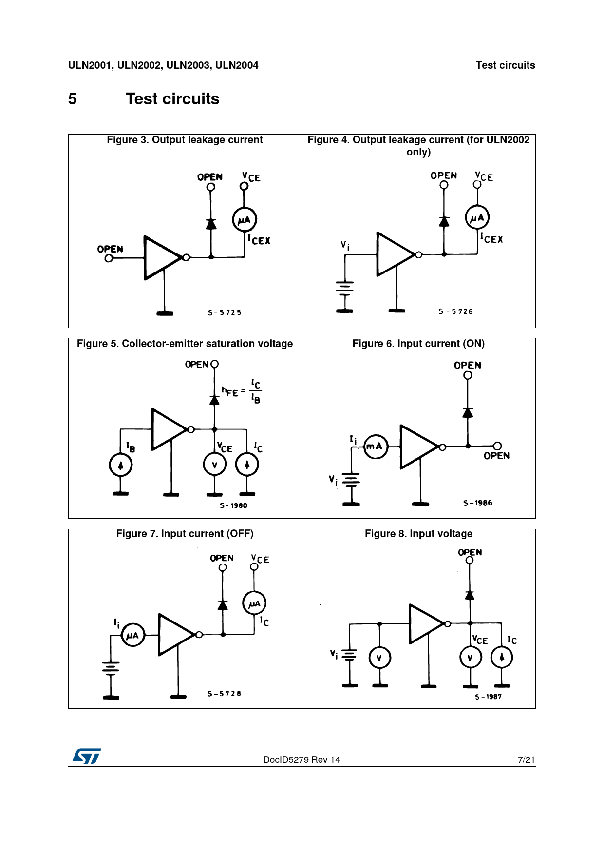

Pages / Page21 / 7 — ULN2001, ULN2002, ULN2003, ULN2004. Test circuits. Figure 3. Output …
File Format / SizePDF / 846 Kb
ULN2001, ULN2002, ULN2003, ULN2004. Test circuits. Figure 3. Output leakage current
ULN2001, ULN2002, ULN2003, ULN2004 Test circuits Figure 3 Output leakage current
ULN2001, ULN2002, ULN2003, ULN2004 Test circuits 5 Test circuits Figure 3. Output leakage current Figure 4. Output leakage current (for ULN2002 only) Figure 5. Collector-emitter saturation voltage Figure 6. Input current (ON) Figure 7. Input current (OFF) Figure 8. Input voltage
DocID5279 Rev 14 7/21 21 Document Outline 1 Diagram Figure 1. Schematic diagram 2 Pin configuration Figure 2. Pin connections (top view) 3 Maximum ratings Table 1. Absolute maximum ratings Table 2. Thermal data 4 Electrical characteristics Table 3. Electrical characteristics 5 Test circuits Figure 3. Output leakage current Figure 4. Output leakage current (for ULN2002 only) Figure 5. Collector-emitter saturation voltage Figure 6. Input current (ON) Figure 7. Input current (OFF) Figure 8. Input voltage Figure 9. Clamp diode leakage current Figure 10. Clamp diode forward voltage 6 Typical performance characteristics Figure 11. Collector current vs. saturation voltage (TJ = 25 °C) Figure 12. Collector current vs. saturation voltage Figure 13. Input current vs. input voltage Figure 14. Input current vs. input voltage (Ta = 25 °C) Figure 15. Collector current vs. input current Figure 16. hFE vs. output current Figure 17. Peak collector current vs. duty cycle (DIP-16) Figure 18. Peak collector current vs. duty cycle (SO-16) 7 Package information 7.1 DIP-16L package information Figure 19. DIP-16L package outline Table 4. DIP-16L mechanical data 7.2 SO-16 Narrow package information Figure 20. SO-16 package outline Table 5. SO-16 Narrow mechanical data Figure 21. SO-16 Narrow tape and reel drawing Table 6. SO-16 Narrow tape and reel mechanical data 7.3 TSSOP16 package information Figure 22. TSSOP16 package outline Table 7. TSSOP16 mechanical data Figure 23. TSSOP16 recommended footprint (dimensions are in mm) Figure 24. TSSOP16 tape and reel drawing Table 8. TSSOP16 tape and reel mechanical data 8 Order codes Table 9. Order codes 9 Revision history Table 10. Revision history
