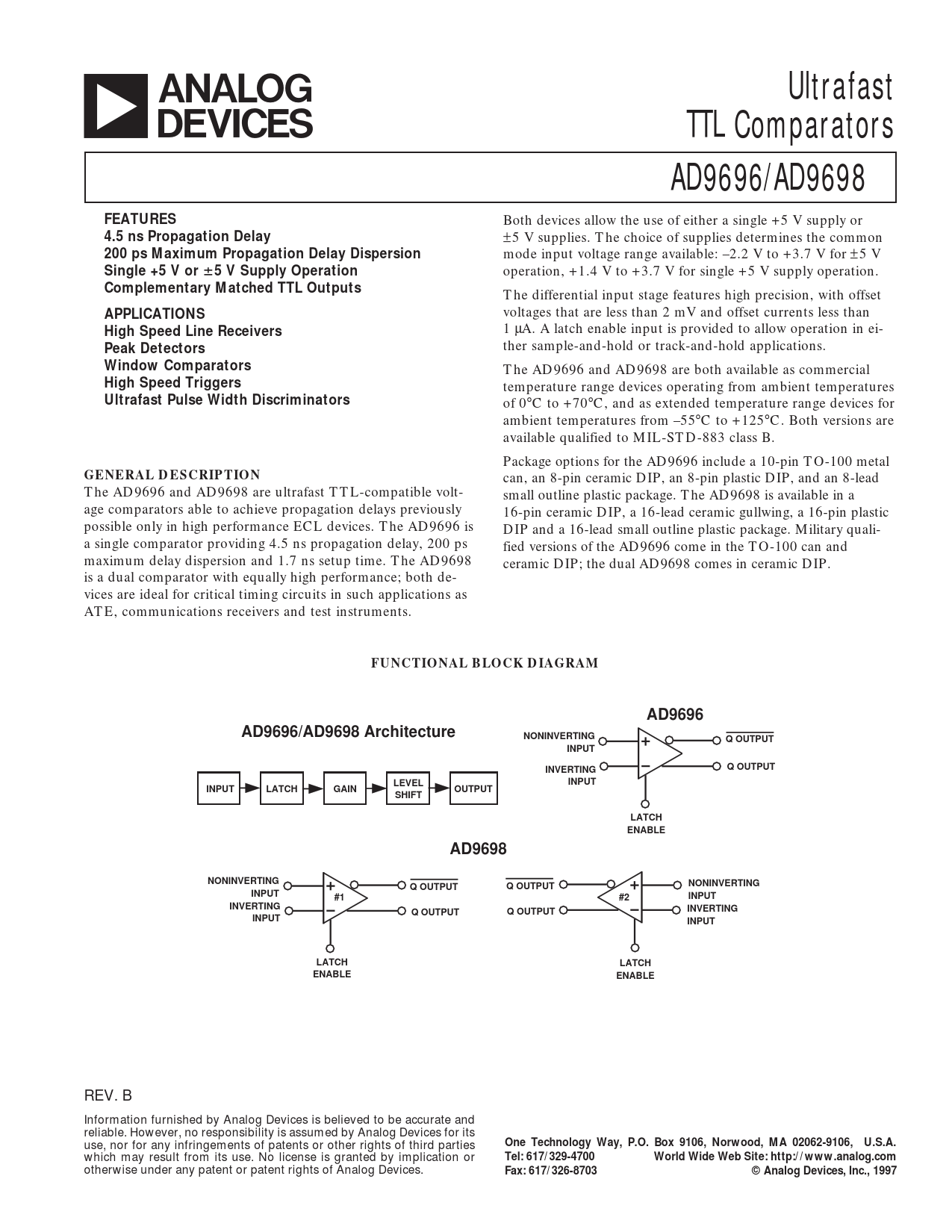

Ultrafast TTL Comparators AD9696/AD9698 FEATURES
Both devices allow the use of either a single +5 V supply or
4.5 ns Propagation Delay
±5 V supplies. The choice of supplies determines the common
200 ps Maximum Propagation Delay Dispersion
mode input voltage range available: –2.2 V to +3.7 V for ± 5 V
Single +5 V or
6
5 V Supply Operation
operation, +1.4 V to +3.7 V for single +5 V supply operation.
Complementary Matched TTL Outputs
The differential input stage features high precision, with offset
APPLICATIONS
voltages that are less than 2 mV and offset currents less than
High Speed Line Receivers
1 µA. A latch enable input is provided to allow operation in ei-
Peak Detectors
ther sample-and-hold or track-and-hold applications.
Window Comparators
The AD9696 and AD9698 are both available as commercial
High Speed Triggers
temperature range devices operating from ambient temperatures
Ultrafast Pulse Width Discriminators
of 0°C to +70°C, and as extended temperature range devices for ambient temperatures from –55°C to +125°C. Both versions are available qualified to MIL-STD-883 class B. Package options for the AD9696 include a 10-pin TO-100 metal
GENERAL DESCRIPTION
can, an 8-pin ceramic DIP, an 8-pin plastic DIP, and an 8-lead The AD9696 and AD9698 are ultrafast TTL-compatible volt- small outline plastic package. The AD9698 is available in a age comparators able to achieve propagation delays previously 16-pin ceramic DIP, a 16-lead ceramic gullwing, a 16-pin plastic possible only in high performance ECL devices. The AD9696 is DIP and a 16-lead small outline plastic package. Military quali- a single comparator providing 4.5 ns propagation delay, 200 ps fied versions of the AD9696 come in the TO-100 can and maximum delay dispersion and 1.7 ns setup time. The AD9698 ceramic DIP; the dual AD9698 comes in ceramic DIP. is a dual comparator with equally high performance; both de- vices are ideal for critical timing circuits in such applications as ATE, communications receivers and test instruments.
FUNCTIONAL BLOCK DIAGRAM AD9696 AD9696/AD9698 Architecture NONINVERTING Q OUTPUT INPUT INVERTING Q OUTPUT LEVEL INPUT INPUT LATCH GAIN OUTPUT SHIFT LATCH ENABLE AD9698 NONINVERTING Q OUTPUT NONINVERTING Q OUTPUT INPUT #1 #2 INPUT INVERTING Q OUTPUT INVERTING Q OUTPUT INPUT INPUT LATCH LATCH ENABLE ENABLE
