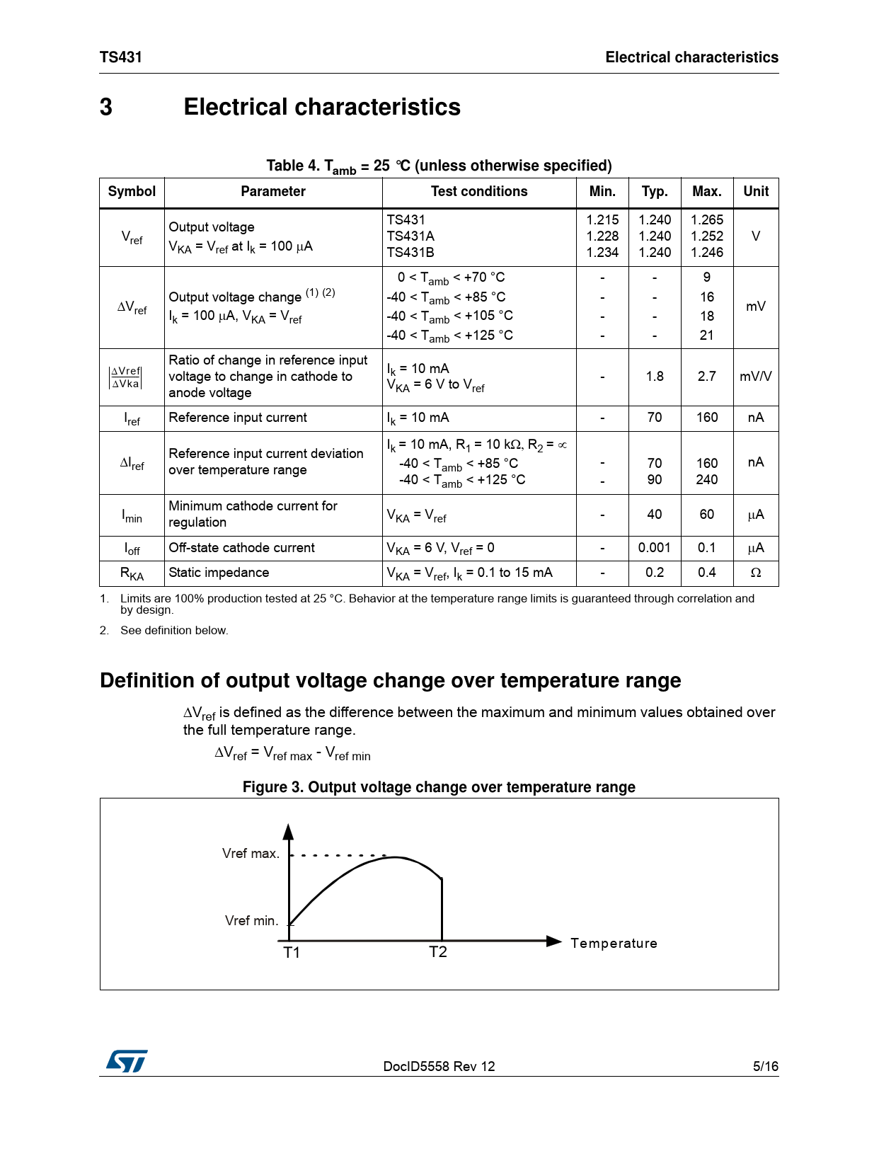

TS431. Electrical characteristics. 3 Electrical. characteristics. Table 4. Tamb = 25 °C (unless otherwise specified). Symbol
TS431 Electrical characteristics 3 Electrical characteristics Table 4 Tamb = 25 °C (unless otherwise specified) Symbol
TS431 Electrical characteristics 3 Electrical characteristics Table 4. Tamb = 25 °C (unless otherwise specified) Symbol Parameter Test conditions Min. Typ. Max. Unit
Output voltage TS431 1.215 1.240 1.265 Vref TS431A 1.228 1.240 1.252 V VKA = Vref at Ik = 100 A TS431B 1.234 1.240 1.246 0 < Tamb < +70 °C - - 9 Output voltage change (1) (2) -40 < T - - 16 V amb < +85 °C ref mV Ik = 100 A, VKA = Vref -40 < Tamb < +105 °C - - 18 -40 < Tamb < +125 °C - - 21 Ratio of change in reference input Vref I -------- voltage to change in cathode to k = 10 mA - 1.8 2.7 mV/V Vka V anode voltage KA = 6 V to Vref Iref Reference input current Ik = 10 mA - 70 160 nA Ik = 10 mA, R1 = 10 k R2 =   Reference input current deviation Iref - nA over temperature range -40 < Tamb < +85 °C 70 160 -40 < Tamb < +125 °C - 90 240 Minimum cathode current for Imin V regulation KA = Vref - 40 60 A Ioff Off-state cathode current VKA = 6 V, Vref = 0 - 0.001 0.1 A RKA Static impedance VKA = Vref, Ik = 0.1 to 15 mA - 0.2 0.4 1. Limits are 100% production tested at 25 °C. Behavior at the temperature range limits is guaranteed through correlation and by design. 2. See definition below.
Definition of output voltage change over temperature range
Vref is defined as the difference between the maximum and minimum values obtained over the full temperature range. Vref = Vref max - Vref min
Figure 3. Output voltage change over temperature range
Vref max. Vref min. Temperature T1 T2 DocID5558 Rev 12 5/16 16 Document Outline 1 Pinout Figure 1. Pinout Z TO92 (plastic package) Figure 2. Pinout L SOT23-5 (plastic micropackage) 2 Absolute maximum ratings and operating conditions Table 1. Absolute maximum ratings Table 2. Operating conditions Table 3. Thermal data 3 Electrical characteristics Table 4. Tamb = 25 °C (unless otherwise specified) Definition of output voltage change over temperature range Figure 3. Output voltage change over temperature range Figure 4. Reference voltage vs. temperature Figure 5. Test circuit for VKA = Vref Figure 6. Cathode voltage vs. cathode current Figure 7. Cathode voltage vs. cathode current Figure 8. Reference input current vs. temperature Figure 9. Static impedance vs. temperature Figure 10. Off-state current vs. temperature Figure 11. Test circuit for off-state current measurement Figure 12. Ratio of change in reference input voltage to change in VKA voltage vs. temperature Figure 13. Test circuit for VKA > Vref Figure 14. Phase and gain vs. frequency Figure 15. Test circuit for phase and gain measurement Figure 16. Pulse response at Ik = 100 µA Figure 17. Test circuit for pulse response at Ik = 100 µA Figure 18. Pulse response at Ik = 1 mA Figure 19. Test circuit for pulse response at Ik = 1 mA Figure 20. Equivalent input noise vs. frequency 4 Application information 5 Package information 5.1 SOT23-5 package information Figure 21. SOT23-5 package outline Table 5. SOT23-5 package mechanical data 5.2 TO92 (tape ammopack and tape and reel) package information Figure 22. TO92 (tape ammopack and tape and reel) package outline Table 6. TO92 (tape ammopack and tape and reel) package mechanical data 5.3 TO92 (bulk) package information Figure 23. TO92 (bulk) package outline Table 7. TO92 (bulk) package mechanical data 6 Ordering information Table 8. Order codes 7 Revision history Table 9. Document revision history
