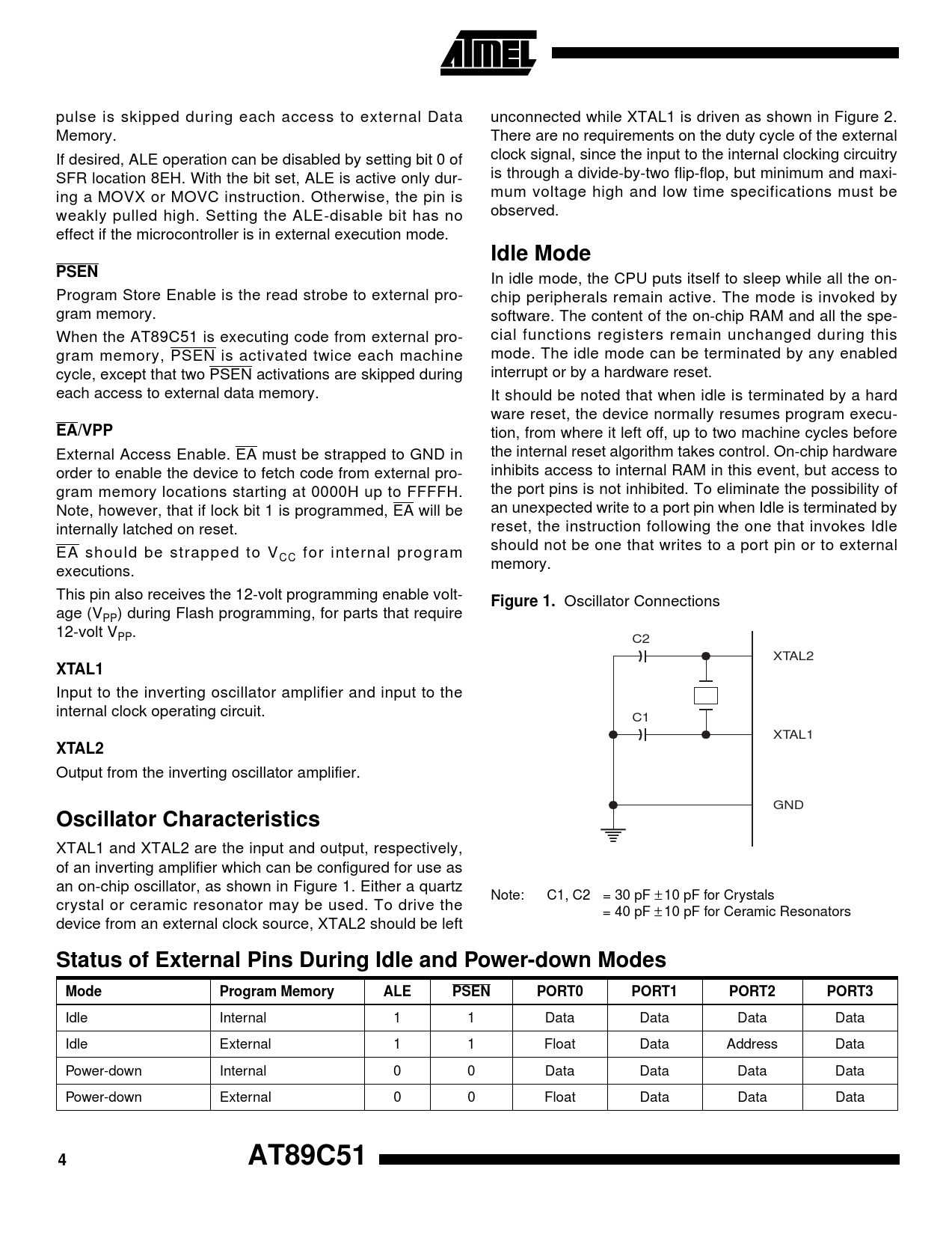

Figure 1.
Oscillator Connections age (VPP) during Flash programming, for parts that require 12-volt VPP. C2 XTAL2
XTAL1
Input to the inverting oscillator amplifier and input to the internal clock operating circuit. C1 XTAL1
XTAL2
Output from the inverting oscillator amplifier. GND
Oscillator Characteristics
XTAL1 and XTAL2 are the input and output, respectively, of an inverting amplifier which can be configured for use as an on-chip oscillator, as shown in Figure 1. Either a quartz Note: C1, C2 = 30 pF ± 10 pF for Crystals crystal or ceramic resonator may be used. To drive the = 40 pF ± 10 pF for Ceramic Resonators device from an external clock source, XTAL2 should be left
Status of External Pins During Idle and Power-down Modes Mode Program Memory ALE PSEN PORT0 PORT1 PORT2 PORT3
Idle Internal 1 1 Data Data Data Data Idle External 1 1 Float Data Address Data Power-down Internal 0 0 Data Data Data Data Power-down External 0 0 Float Data Data Data
