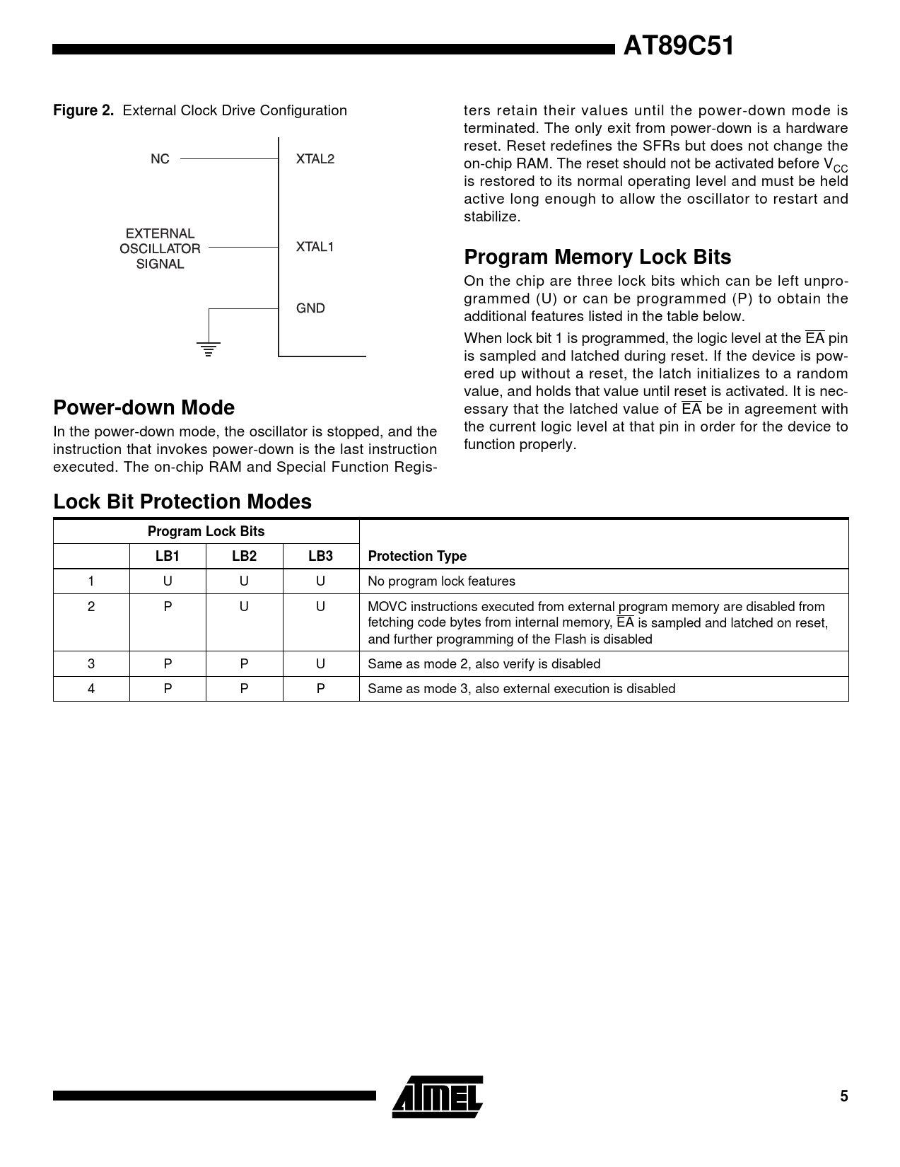

AT89C51. Figure 2. Program Memory Lock Bits. Power-down Mode. Lock Bit Protection Modes. Program Lock Bits. LB1. LB2. LB3
AT89C51 Figure 2 Program Memory Lock Bits Power-down Mode Lock Bit Protection Modes Program Lock Bits LB1 LB2 LB3
AT89C51 Figure 2.
External Clock Drive Configuration ters retain their values until the power-down mode is terminated. The only exit from power-down is a hardware reset. Reset redefines the SFRs but does not change the on-chip RAM. The reset should not be activated before VCC is restored to its normal operating level and must be held active long enough to allow the oscillator to restart and stabilize.
On the chip are three lock bits which can be left unpro- grammed (U) or can be programmed (P) to obtain the additional features listed in the table below. When lock bit 1 is programmed, the logic level at the EA pin is sampled and latched during reset. If the device is pow- ered up without a reset, the latch initializes to a random value, and holds that value until reset is activated. It is nec-
Power-down Mode
essary that the latched value of EA be in agreement with In the power-down mode, the oscillator is stopped, and the the current logic level at that pin in order for the device to instruction that invokes power-down is the last instruction function properly. executed. The on-chip RAM and Special Function Regis-
Lock Bit Protection Modes Program Lock Bits LB1 LB2 LB3 Protection Type
1 U U U No program lock features 2 P U U MOVC instructions executed from external program memory are disabled from fetching code bytes from internal memory, EA is sampled and latched on reset, and further programming of the Flash is disabled 3 P P U Same as mode 2, also verify is disabled 4 P P P Same as mode 3, also external execution is disabled
