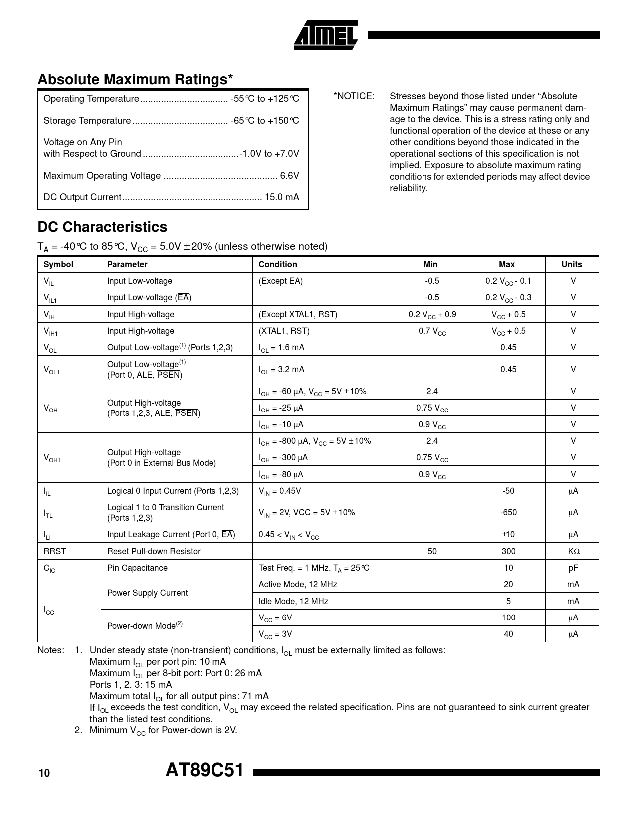

Absolute Maximum Ratings*. DC Characteristics. Symbol. Parameter. Condition. Min. Max. Units. AT89C51
Absolute Maximum Ratings* DC Characteristics Symbol Parameter Condition Min Max Units AT89C51
Operating Temperature.. -55°C to +125°C *NOTICE: Stresses beyond those listed under “Absolute Maximum Ratings” may cause permanent dam- Storage Temperature ... -65°C to +150°C age to the device. This is a stress rating only and functional operation of the device at these or any Voltage on Any Pin other conditions beyond those indicated in the with Respect to Ground ...-1.0V to +7.0V operational sections of this specification is not implied. Exposure to absolute maximum rating Maximum Operating Voltage .. 6.6V conditions for extended periods may affect device reliability. DC Output Current.. 15.0 mA
DC Characteristics
TA = -40°C to 85°C, VCC = 5.0V ± 20% (unless otherwise noted)
VIL Input Low-voltage (Except EA) -0.5 0.2 VCC - 0.1 V V Input Low-voltage (EA) -0.5 0.2 V - 0.3 V IL1 CC V Input High-voltage (Except XTAL1, RST) 0.2 V + 0.9 V + 0.5 V IH CC CC VIH1 Input High-voltage (XTAL1, RST) 0.7 VCC VCC + 0.5 V V Output Low-voltage(1) (Ports 1,2,3) I = 1.6 mA 0.45 V OL OL Output Low-voltage(1) V I = 3.2 mA 0.45 V OL1 (Port 0, ALE, PSEN) OL I = -60 µA, V = 5V ± 10% 2.4 V OH CC Output High-voltage V I = -25 µA 0.75 V V OH (Ports 1,2,3, ALE, PSEN) OH CC IOH = -10 µA 0.9 VCC V I = -800 µA, V = 5V ± 10% 2.4 V OH CC Output High-voltage V I = -300 µA 0.75 V V OH1 (Port 0 in External Bus Mode) OH CC IOH = -80 µA 0.9 VCC V I Logical 0 Input Current (Ports 1,2,3) V = 0.45V -50 µA IL IN Logical 1 to 0 Transition Current I V = 2V, VCC = 5V ± 10% -650 µA TL (Ports 1,2,3) IN I Input Leakage Current (Port 0, EA) 0.45 < V < V ±10 µA LI IN CC RRST Reset Pull-down Resistor 50 300 KΩ CIO Pin Capacitance Test Freq. = 1 MHz, TA = 25°C 10 pF Active Mode, 12 MHz 20 mA Power Supply Current Idle Mode, 12 MHz 5 mA ICC V = 6V 100 µA CC Power-down Mode(2) V = 3V 40 µA CC Notes: 1. Under steady state (non-transient) conditions, IOL must be externally limited as follows: Maximum I per port pin: 10 mA OL Maximum I per 8-bit port: Port 0: 26 mA OL Ports 1, 2, 3: 15 mA Maximum total I for all output pins: 71 mA OL If I exceeds the test condition, V may exceed the related specification. Pins are not guaranteed to sink current greater OL OL than the listed test conditions. 2. Minimum V for Power-down is 2V. CC
