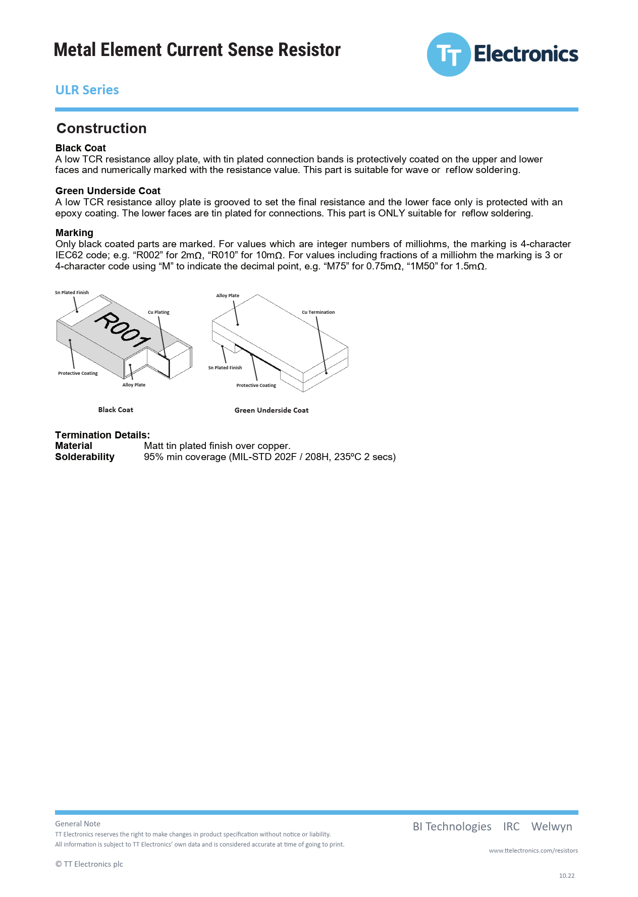

1. For higher resistance values please refer to LRMA series. 2. Package sizes 1206 and 2010 are uncoated on the top surface and unmarked. ULRB2 /

R resistance al oy plate, with tin plated connection bands is protectively coated on the upper and lower

f Aa low Ace los T wa C n R T d re C n R u si m s reseta i ri n st c c aanl e lcy al e m oy p alarkela loy d te pl w , at iet w ,h itth wh it etin h re p tinsila s pl tte a d at n e cc d eon c v n o a n l e u c n et e .io c Tn ti h o ib n san bp d aa nrst d i s s p i s r s uo p irt te a c otbel tiev cti feoly v r c el w o y a a c v te o e d at o e r o d n roetfh n l e t o u h w p e s p u o p ledr p ea er rind n ang l d. ower lower faces and numerical y marked with the resistance value. This part is suitable for wave or reflow soldering. faces and numerical y marked with the resistance value. This part is suitable for wave or reflow soldering.

R resistance al oy plate is grooved to set the final resistance, the lower faces are tin plated for A lo con w nec T ti C o R ns, re a s n idsita t insce p

al oy rotectiv p el a y te co iaste g d ro o o n vte h d e t u o pp s e e r ta tnhdelo fin w a e l r f r a es ceis s ta a n n c d e, nu th m eri low cal e y rmface arkesd a wre ith tin he pl reastie s d ta f n o c re con va A ll nuoee.wctTiTohiCnss R ,pr aaenrtsidisstita iOnsNcpL e rotectiv Yal slu o iytapl eblaltyeefcoiosa r gte ref rodloo owvnesdth olt e doeur s ipnetpgte.hre afnid nallorweesir stfaace nc se aanndd ntu h m e l eoriwca er lfya m cearke onl d y i wsith pr tohte ectre e sdist wiatnhce an va e lpuoex.y Th coisatipnagr.t is Th O e NloLY wersufiata c b e lseafroer tirenflpolw at s e o d lfdoerricng on.nections. This part is ONLY suitable for reflow soldering.

CR resistance al oy plate is grooved to set the final resistance and the lower face only is protected with an AOnly black coated parts are marked. For values which are integer numbers of mil iohms, the marking is 4-character e l p ow xy TC co R ati re n s g. is Tta h n e cle o a w l erofya p c leaste aris e tgiro n o pl vae t d e to f s r e c t t onhne fcitna o ln r s e . s T is hita s npcaert ain s d O th N e LYlosw uietra fba l ce e fo o r nrly eflis o p w ro s t oledcete ri d ngw . ith an eIp Eox C y62cocaotdine;g.e T.gh.e“ lRo0w0e2r” ffaocre2s a m re,“tin R0p1la0t”efdorfo1r0con m n.eFcotriovns al .u Tehsiisn pclaurtdi is ngOfN raLcYtiosu nsitaofble a fo mi rli roehflo m wth seold m earriknign.gis 3 or
Markin
4-char
g
acter code using “M” to indicate the decimal point, e.g. “M75” for 0.75m , “1M50” for 1.5m .

Matt tin plated finish over a barrier Matt tin plated finish over copper. layer

95% min coverage (MIL-STD 202F / 208H, 235ºC 2 secs)
