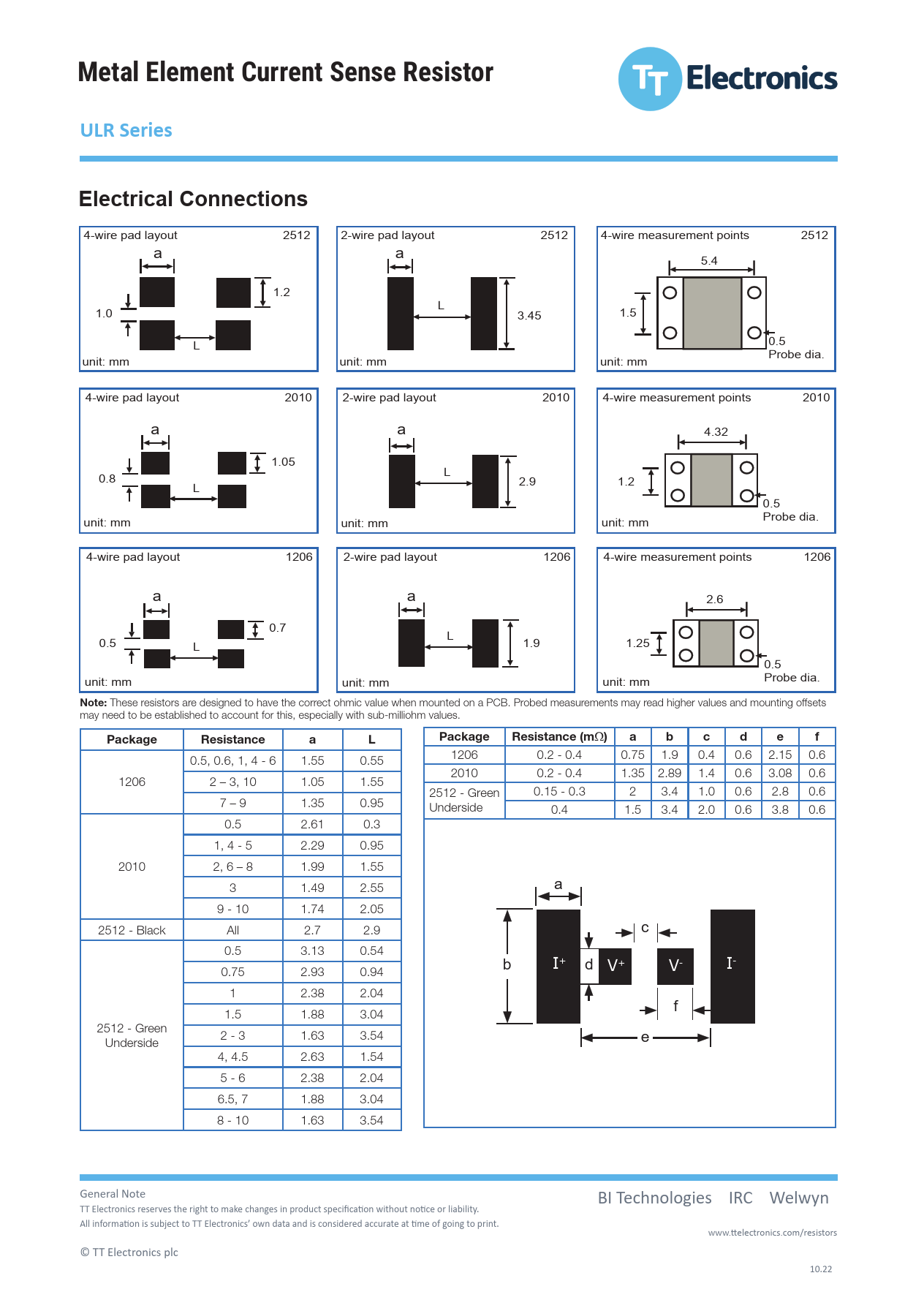

ULR Series Electrical Connections Electrical Connections
4-wire pad layout 5 2 2 1
2-wire pad layout 2 1 5 2 4-wire measurement points 2 1 5 2 2512 a 4-wire measurement points 5 2 a 2 1 4-wire pad layout 2 1 5 2 2-wire pad layout 5 2 2 1 4-wire measurement points 5.4 2 1 5 2 2-wire pad layout 2 1 5 2 a 4-wire measurement points 5.4 5 2 a 2 1 1.2 5.4 5.4 L Metal Element 1.0 3.45 1.5 L 1.2 Cur 3.45rent Sense Resistor 1.5 L 1.0 L 3.45 1.5 0.5 L u3.45 m m : ti n ULR Series 1.5 n u i 0.5 m m : t m m : ti n u Probe dia. ti n u :L Probe dia. 0.5 mm :t i n u m m u i n 0.5 : t m m n u : ti m m Probe dia. 4 i w - e r l d a p t u o y a 0 1 0 2 2 a p e ri w - d a l u o y t 0 2 0 1 i w - 4 m e r a e r u s m e s t n i o p t n e 0 1 0 2
u ti n : m m Probe dia. t 2010 e ri w - 4 a e m e r u s e m t n p n i o s t 0 2 10 w - 4 e ri d a p ay a l t u o 0 1 0 2 w - 2 e ri
al d a p t u o y a 0 1 0 2 w - 4 e m e ri a e r u s p t n e m 2-wire pad layout 2 2 1 5 4.32 n i o s t 0 2 0 1 4-wire measurement points 2 1 5 2 ut 1 0 2 0 4 e ri w - e m a e r u s t n e m 4.32 i o p s t n 0 1 0 2 a a a 1.05 4-wire pad layout 2 1 5 2 a 2-wire pad layout 2 1 5 2 4.32 4-wire measurement points 5.4 5 2 2 1 0.8 L L a 4.32 L a 2.9 1.2 1.05 1.2 5.4 2.9 1.2 0.8 L L 0.5 1.0 3.45 1.5 L unit: mm L 2.9 1.2 1.2 unit: mm 0.5 unit: mm Probe dia. 2.9 1.2 unit: mm Probe dia. L 0.5 1.0 L 3.45 1.5 0.5 unit: mm 4 i w - e r l d a p t u o y a 0 2 1 6 unit: mm 2 0.5 w - p e ri a l d a o y ut 0 2 1 6 unit: mm Probe dia. m e ri w - 4 s a e t n e m e r u s t n i o p 1 0 2 Probe dia.6 n u m : ti m n u m m : ti m : ti n u m Probe dia. t 1206 i w - 4 L unit: mm e r r u s a e m e m e n p t n i o s t 0 2 1 6 0.5 w - 4 e ri d a p y a l t u o 6 0 2 1 w - 2 e ri l d a p t u o y a 6 0 2 1 w - 4 e m e ri a e r u s p t n e m n i o s t 2 1 Probe dia.6 0 n u ti : m m 4 i w - e r l d a p a n u ti m m : t u o y a 0 1 0 2 i w - 2 d a p e r l a m m : ti n u y a t u o 2 1 0 0 ri w - 4 s a e m e 2.6 t n i o p t n e m e r u s 2 0 1 0 ut 0 2 1 6 ri w - 4 e a e m su p t n e m e r n i o s t 6 0 2 1 2.6 w - 4 e ri d a p a ay a l t u o 0.7 0 1 0 2 i w - 2 e r p d aal a u o y a t 2 0 1 0 w - 4 m e ri e r u s a e e m 2.6 t n p 4.32 n i o s t 20 0 1 0.5 L 1.9 1.25 L 2.6 L 1.9 a 1.25 0.7 1.05 a 4.32 0.5 0.5 L L 0.8 1.9 1.25 L L unit: mm unit: mm 0.5 2.9 unit: mm 1.2 Probe dia. L 1.9 1.25 1.05 unit: mm Probe dia. 0.5 L 0.5 unit: mm 0.8 unit: mm 0.5 2.9 unit: mm 1.2 Probe dia. unit: mm L unit: mm unit: mm Probe dia. unit: mm Probe dia.
Note:
These resistors are designed to have the correct ohmic value when mounted on a PCB. Probed measurements may r 0.5 ead higher values and mounting offsets may need to be established to account for this, especially with sub-milliohm values. 4

L Suggested Alternative 4-
0.55
(mΩ) Wire Design Methods
0.5, 0.6 1.55 0.55 0.5 6 - 8 0.75 3.13 1.99 2.93 0.52 1.55 b I+ d 0.94 9 - 10
(mΩ)
2 - 3 1.74 1.05 I- V+ V- 2.05 1.55 2512 - Black All 9 - 10 2.7 1.74 2.9 2.05 1 1, 4 – 6 1.55 0.55 0.75 1 2.93 2.38 0.94 2010 - Green 4 - 6 1.55 0.55 2.04 1206 0.5 3.13 0.52 2 - 3 2 – 3, 10 1.05 f 1.55 1 2.38 2.04 7 - 9 1.35 0.95 0.75 1.5 2.93 1.88 0.94 3.04 2010 - Green 4 - 6 1.55 0.55 2512 - Green 1.5 1.88 3.04 10 7 – 9 1.05 1.35 1.55 2512 - Green 0.95 Note: Nominal values; tolerances not included 2 - 3 1.63 3.54 Underside 1 2.38 2.04 7 - 9e 1.35 0.95 Underside 2 - 3 1.63 3.54 1 2.29 0.95 0.5, 1, 4 - 5 2.29 0.95 1.5 4, 4.5 1.88 2.63 3.04 1.54 10 1.05 1.55 Note: Nominal values; tolerances not included

Suggested Alternative 4-Wire Design Methods
Sense traces on Solder pads beneath the chip 6 - 8 1.99 1.55 9 - 10 1.74 2.05 Sense traces on Solder pads beneath the chip
