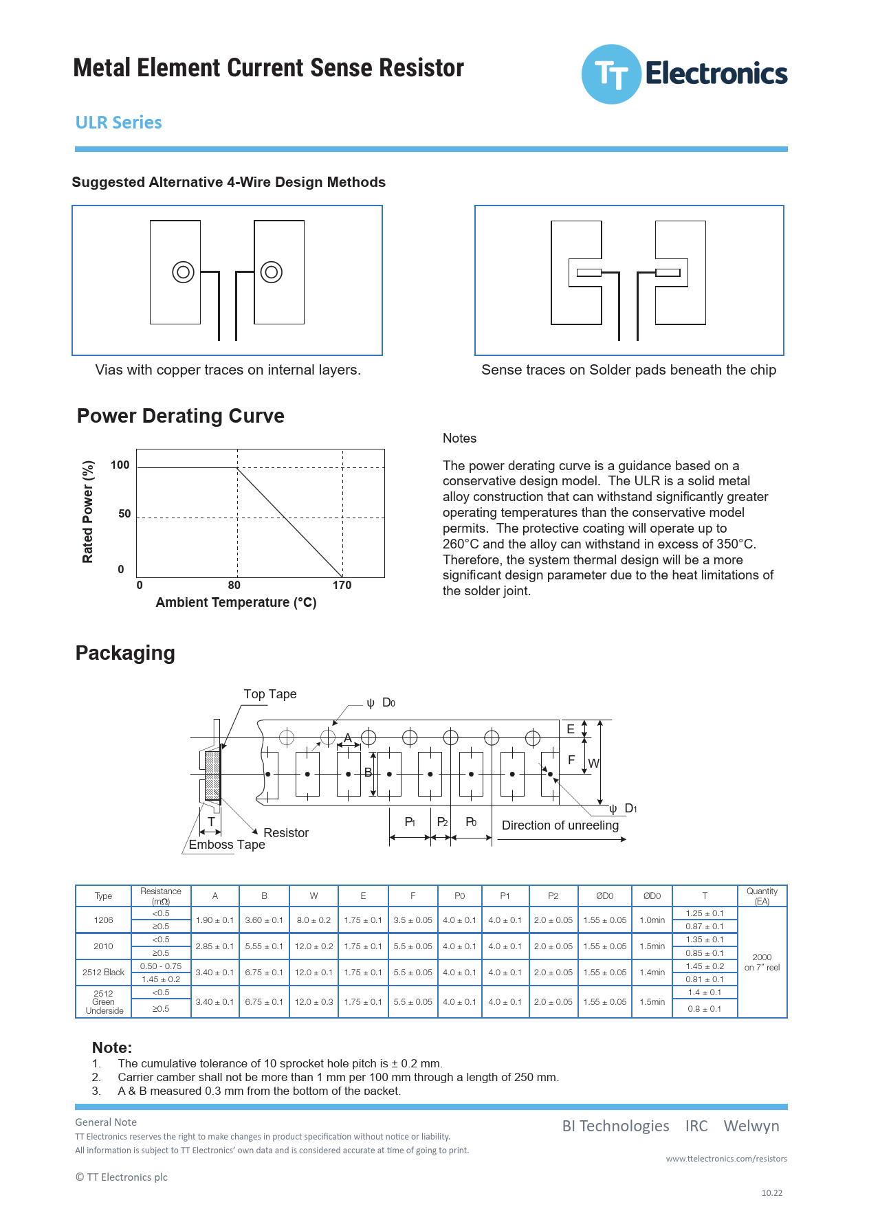

Suggested Alternative 4-Wire Design Methods
9 - 10 1.74 2.05 Note: Nominal values; tolerances not included Note: Nominal values; tolerances not included

ULR Issue April 2011 Sheet 3 of 6 A low TCR resistance alloy plate with plated connection A low TCR alloy plate is grooved to set the nal resistance. ULR Series bands is protectively coated and numerically marked with The lower faces are solder plated for connections, and the top the resistance value, as described in Product Marking. This surface is protectively coated and numerically marked with the version has standard plated connection and is suitable for Vias with copper traces on internal layers. resistance value, as described in Product Marking. This part Sense traces on Solder pads beneath the chip wave or IR re ow soldering processes. is suitable for wave and IR re ow soldering processes. Wave re ow requires the solder mask to be dimensioned according to
General Note
page 2 using the W and D dimensions of the part.
Power Derating Curve
TT electronics reserves the right to make changes in product specification without notice or liability. All information is subject to TT electronics’ own data and is consider Notes ed accurate at time of going to print. www.bitechnologies.com www.irctt.com www.welwyn-tt.com
100 © TT electronics plc
The power derating curve is a guidance based on a conservative design model. The ULR is a solid metal 03.14
100
alloy construction that can withstand signifi cantly greater
50
operating temperatures than the conservative model permits. The protective coating will operate up to
50
260°C and the alloy can withstand in excess of 350°C.
Rated Power (%)
Therefore, the system thermal design will be a more
0
signifi cant design parameter due to the heat limitations of
0 80 170 Rated Power (%)
the solder joint.
0 Ambient Temperature (°C) 0 80 170 Ambient Temperature (°C) Packaging
Top Tape
Plastic Tape Speci fication
ψ D0 Top Tape ψ E A D0 F E W A B F W B ψ D1 T P1 P2 P0 Direction of unreeling Resistor Emboss Tape ψ D1 T P1 P2 P0 Direction of unreeling Resistor Emboss Tape Type Resistance (mΩ) A B W E F P P P ΦD ΦD T Quantity 0 1 2 0 1 (EA) 1206 1 -10 1.90 ± 0.1 3.60 ± 0.1 8.0 ± 0.2 1.75 ± 0.1 3.5 ± 0.05 4.0 ± 0.1 4.0 ± 0.1 2.0 ± 0.05 1.55 ± 0.05 1.0min. 0.87 ± 0.1 2,000 Type Resistance P P ΦD ΦD T Quantity 1 2 0 1 Resistance Quantity 2010 Type 1 -10 (mΩ) A B W E F P0 2.85 ± 0.1 A 5.55 ± 0.1 B 12.0 ± 0.2 W 1.75 ± 0.1 E 5.5 ± 0.05 F 4.0 ± 0.1 P0 4.0 ± 0.1 P1 2.0 ± 0.05 P2 1.55 ± 0.05 ØD0 1.4min ØD0 0.85 ± 0.1 T 2,000 (EA) (mΩ) (EA) 1206 1 -10 1.90 ± 0.1 3.60 ± 0.1 8.0 ± 0.2 1.75 ± 0.1 3.5 ± 0.05 4.0 ± 0.1 4.0 ± 0.1 2.0 ± 0.05 1.55 ± 0.05 1.0min. 0.87 ± 0.1 2,000 2512 0.50 - 0.75 <0.5 1.45 ± 0.2 1.25 ± 0.1 1206 1.90 ± 0.1 3.60 ± 0.1 8.0 ± 0.2 1.75 ± 0.1 3.5 ± 0.05 4.0 ± 0.1 4.0 ± 0.1 2.0 ± 0.05 1.55 ± 0.05 1.0min Black ≥0.5 3.40 ± 0.1 6.75 ± 0.1 12.0 ± 0.1 1.75 ± 0.1 5.5 ± 0.05 4.0 ± 0.1 4.0 ± 0.1 2.0 ± 0.05 1.55 ± 0.05 1.4min 0.87 ± 0.1 2,000 2010 1 - 10 1 -10 2.85 ± 0.1 5.55 ± 0.1 12.0 ± 0.2 1.75 ± 0.1 5.5 ± 0.05 4.0 ± 0.1 4.0 ± 0.1 2.0 ± 0.05 1.55 ± 0.05 1.4min 0.81 ± 0.1 0.85 ± 0.1 2,000 <0.5 1.35 ± 0.1 2512 2010 0.50 - 0.75 2.85 ± 0.1 5.55 ± 0.1 12.0 ± 0.2 1.75 ± 0.1 5.5 ± 0.05 4.0 ± 0.1 4.0 ± 0.1 2.0 ± 0.05 1.55 ± 0.05 1.5min 1.45 ± 0.2 0.50 -15 ≥0.5 3.40 ± 0.1 6.75 ± 0.1 12.0 ± 0.1 1.75 ± 0.1 5.5 ± 0.05 4.0 ± 0.1 4.0 ± 0.1 2.0 ± 0.05 1.55 ± 0.05 1.4min 0.81 ± 0.1 0.85 ± 0.1 2,000 Green Black 2000 1 - 10 0.50 - 0.75 0.81 ± 0.1 1.45 ± 0.2 on 7” reel 2512 2512 Black 3.40 ± 0.1 6.75 ± 0.1 12.0 ± 0.1 1.75 ± 0.1 5.5 ± 0.05 4.0 ± 0.1 4.0 ± 0.1 2.0 ± 0.05 1.55 ± 0.05 1.4min 1.45 ± 0.2 0.81 ± 0.1 Green 0.15 -10 3.40 ± 0.1 6.75 ± 0.1 12.0 ± 0.1 1.75 ± 0.1 5.5 ± 0.05 4.0 ± 0.1 4.0 ± 0.1 2.0 ± 0.05 1.55 ± 0.05 1.4min 0.81 ± 0.1 2,000 Underside 2512 <0.5 1.4 ± 0.1 Green 0.1- 0.4 3.40 ± 0.1 6.75 ± 0.1 12.0 ± 0.3 1.75 ± 0.1 5.5 ± 0.05 4.0 ± 0.1 4.0 ± 0.1 2.0 ± 0.05 1.55 ± 0.05 1.5min ≥0.5 1.2 ± 0.1 1225 Underside 3.40 ± 0.1 6.75 ± 0.1 12.0 ± 0.3 1.75 ± 0.1 5.5 ± 0.05 4.0 ± 0.1 4.0 ± 0.1 2.0 ± 0.05 1.55 ± 0.05 1.5min 0.8 ± 0.1 2,000 0.5-3.0 0.80 ± 0.1
Note:
1. The cumulative tolerance of 10 sprocket hole pitch is ± 0.2 mm.
Wire and Film
2.
Technologies Division
• 4222 South Staples Street • Corpus Christi Carrier camber shall not be more than 1 mm per 100 mm through a Texas 78411 USA length of 250 mm. Telephone: 361 992 7900 • Facsimile: 361 992 3377 • 3. A Website: www.irctt.com & B measured 0.3 mm from the bottom of the packet. ULR Issue April 2011 Sheet 4 of 6
Wire and Film
4. T
measured at a point on the inside bottom of the packet to the top surface of the carrier.
