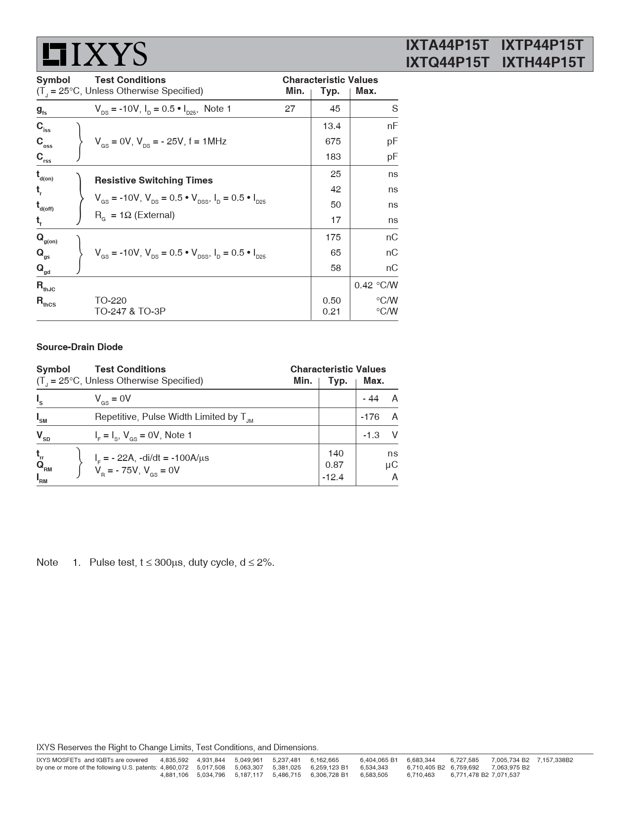

IXTA44P15T IXTP44P15T IXTQ44P15T IXTH44P15T. Symbol. Test Conditions Characteristic Values. Min. Typ. Max. iss. oss. rss. d(on)
IXTA44P15T IXTP44P15T IXTQ44P15T IXTH44P15T Symbol Test Conditions Characteristic Values Min Typ Max iss oss rss d(on)
(T = 25°C, Unless Otherwise Specified)
Min. Typ. Max.
J
g
V = -10V, I = 0.5 • I , Note 1 27 45 S
fs
DS D D25
C
13.4 nF
iss C
V = 0V, V = - 25V, f = 1MHz 675 pF
oss
GS DS
C
183 pF
rss t
25 ns
d(on) Resistive Switching Times t
42 ns
r
V = -10V, V = 0.5 • V , I = 0.5 • I
t
GS DS DSS D D25 50 ns
d(off) t
R = 1Ω (External) G 17 ns
f Q
175 nC
g(on) Q
V = -10V, V = 0.5 • V , I = 0.5 • I 65 nC
gs
GS DS DSS D D25
Q
58 nC
gd R
0.42 °C/W
thJC R
TO-220 0.50 °C/W
thCS
TO-247 & TO-3P 0.21 °C/W
Source-Drain Diode Symbol Test Conditions Characteristic Values
Min. Typ. Max.
J
I
V = 0V - 44 A
S
GS
I
Repetitive, Pulse Width Limited by T -176 A
SM
JM
V
I = I , V = 0V, Note 1 -1.3 V
SD
F S GS
t
140 ns
rr
I = - 22A, -di/dt = -100A/μs
Q
F 0.87 μC
RM
V = - 75V, V = 0V
I
R GS -12.4 A
RM
