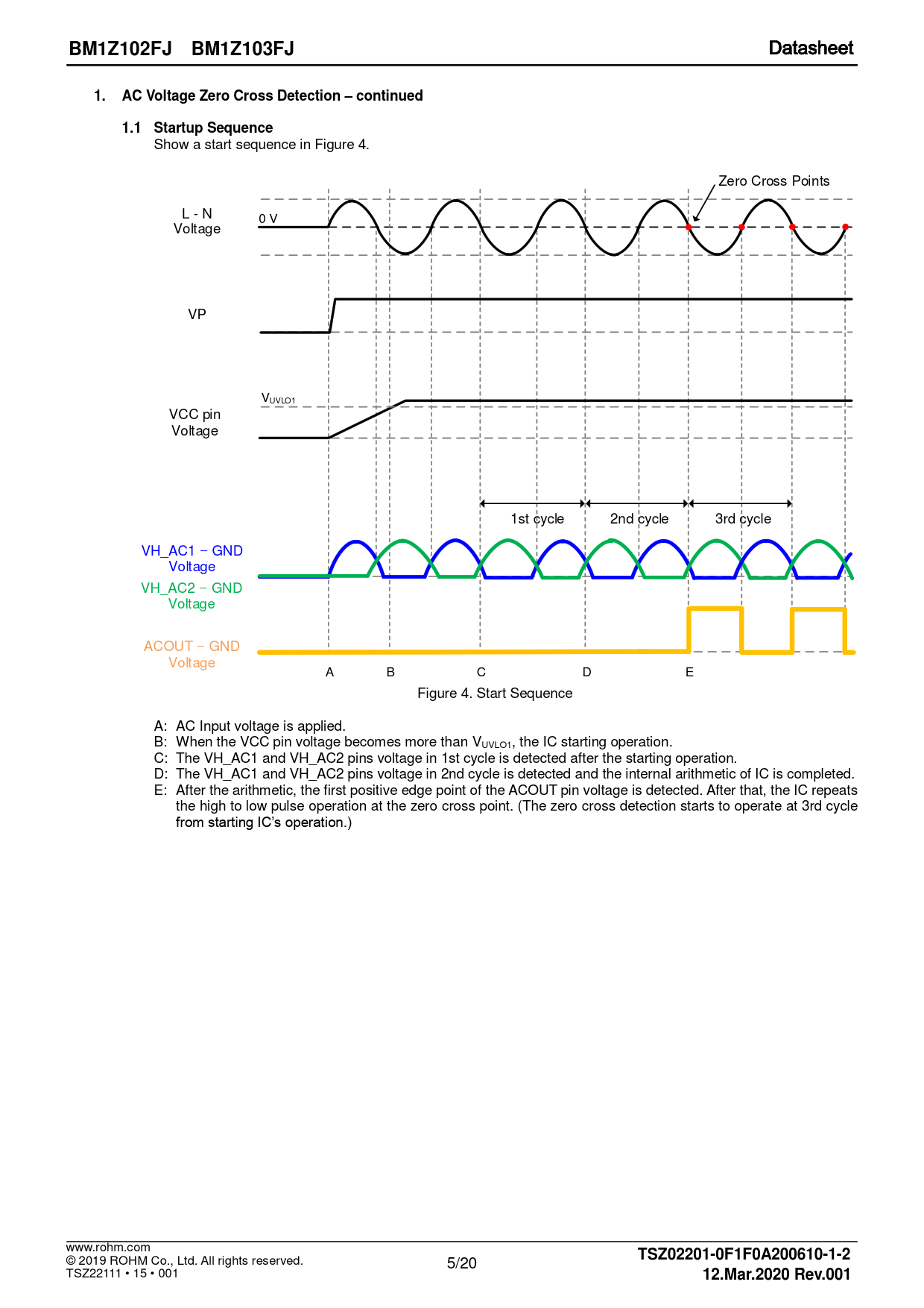

Show a start sequence in Figure 4. Zero Cross Points L - N 0 V Voltage VP VUVLO1 VCC pin Voltage 1st cycle 2nd cycle 3rd cycle VH_AC1 – GND Voltage VH_AC2 – GND Voltage ACOUT – GND Voltage A B C D E Figure 4. Start Sequence A: AC Input voltage is applied. B: When the VCC pin voltage becomes more than VUVLO1, the IC starting operation. C: The VH_AC1 and VH_AC2 pins voltage in 1st cycle is detected after the starting operation. D: The VH_AC1 and VH_AC2 pins voltage in 2nd cycle is detected and the internal arithmetic of IC is completed. E: After the arithmetic, the first positive edge point of the ACOUT pin voltage is detected. After that, the IC repeats the high to low pulse operation at the zero cross point. (The zero cross detection starts to operate at 3rd cycle from starting IC’s operation.) www.rohm.com
