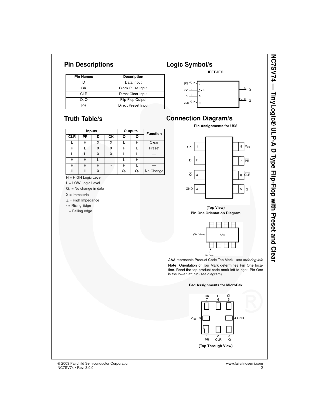

Logic Symbol/s
Logic Symbol/s
IEEE/IEC Pin Names Description D Data Input CK Clock Pulse Input CLR Direct Clear Input Q, Q Flip-Flop Output PR Direct Preset Input Connection Diagram/s Truth Table/s Pin Assignments for US8
Inputs Outputs CLR PR D CK L H X H L X Function Q Q X L H Clear X H L Preset L L X X H H — H H L -L H — H H H -H L — H H X ¯ Qn Qn No Change H = HIGH Logic Level
L = LOW Logic Level
Qn = No change in data
X = Immaterial
Z = High Impedance
-= Rising Edge
¯ = Falling edge (Top View)
Pin One Orientation Diagram AAA represents Product Code Top Mark -see ordering info
Note: Orientation of Top Mark determines Pin One location. Read the top product code mark left to right, Pin One
is the lower left pin (see diagram).
