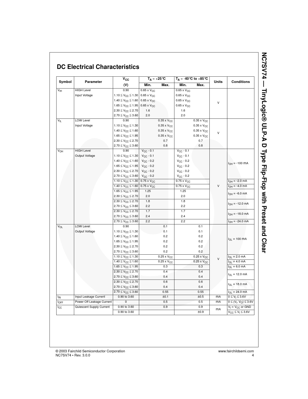

ManufacturerON Semiconductor
DescriptionTinyLogic ULP-A D-Type Flip-Flop with Preset and Clear
Pages / Page13 / 5 — Symbol. VIH Parameter. HIGH Level. Input Voltage VIL LOW Level. Input …
File Format / SizePDF / 553 Kb
Symbol. VIH Parameter. HIGH Level. Input Voltage VIL LOW Level. Input Voltage VOH HIGH Level. Output Voltage VOL LOW Level
Symbol VIH Parameter HIGH Level Input Voltage VIL LOW Level Input Voltage VOH HIGH Level Output Voltage VOL LOW Level
Symbol
VIH Parameter
HIGH Level
Output Voltage IIN Input Leakage Current IOFF Power Off Leakage Current ICC Quiescent Supply Current VCC TA = +25°C (V) Min. 0.90 Max. TA = -40°C to +85°C
Min. 0.65 x VCC 0.65 x VCC 1.10  VCC  1.30 0.65 x VCC 0.65 x VCC 1.40  VCC  1.60 0.65 x VCC 0.65 x VCC 1.65  VCC  1.95 0.65 x VCC 0.65 x VCC 2.30  VCC  2.70 1.6 2.70  VCC  3.60 2.0 Max. 1.6
2.0
0.35 x VCC 0.35 x VCC 1.10  VCC  1.30 0.35 x VCC 0.35 x VCC 1.40  VCC  1.60 0.35 x VCC 0.35 x VCC 1.65  VCC  1.95 0.35 x VCC 0.35 x VCC 2.30  VCC  2.70 0.7 0.7 2.70  VCC  3.60 0.8 V 0.8 0.90 VCC -0.1 VCC -0.1 1.10  VCC  1.30 VCC -0.1 VCC -0.1 1.40  VCC  1.60 VCC -0.2 VCC -0.2 1.65  VCC  1.95 VCC -0.2 VCC -0.2 2.30  VCC  2.70 VCC -0.2 VCC -0.2 2.70  VCC  3.60 VCC -0.2 IOH = -100 mA VCC -0.2 1.10  VCC  1.30 0.75 x VCC 0.75 x VCC 1.40  VCC  1.60 0.75 x VCC 0.75 x VCC 1.65  VCC  1.95 1.25 1.25 2.30  VCC  2.70 2.0 2.0 2.30  VCC  2.70 1.8 1.8 2.70  VCC  3.60 2.2 2.2 2.30  VCC  2.70 1.7 1.7 2.70  VCC  3.60 2.4 2.4 2.70  VCC  3.60 2.2 IOH = -2.0 mA
V IOH = -4.0 mA
IOH = -6.0 mA
IOH = -12.0 mA
IOH = -18.0 mA
IOH = -24.0 mA 2.2 0.90 0.1 0.1 1.10  VCC  1.30 0.1 0.1 1.40  VCC  1.60 0.2 0.2 1.65  VCC  1.95 0.2 0.2 2.30  VCC  2.70 0.2 0.2 2.70  VCC  3.60 0.2 0.2 1.10  VCC  1.30 0.25 x VCC 0.25 x VCC 1.40  VCC 1.60 0.25 x VCC 0.25 x VCC 1.65  VCC  1.95 0.3 0.3 2.30  VCC  2.70 0.4 0.4 2.70  VCC  3.60 0.4 0.4 2.30  VCC  2.70 0.6 0.6 2.70  VCC  3.60 0.4 0.4 2.70  VCC  3.60 0.55 0.55 0.90 to 3.60 ±0.1 ±0.5 0 0.5 0.5 0.90 to 3.60 0.9 0.9 © 2003 Fairchild Semiconductor Corporation
NC7SV74 • Rev. 3.0.0 Conditions V 0.90 0.90 to 3.60 Units ±0.9 IOL = 100 mA V IOL = 2.0 mA
IOL = 4.0 mA
IOL = 6.0 mA
IOL = 12.0 mA
IOL = 18.0 mA
IOL = 24.0 mA mA
mA 0  VI  3.6V mA VCC  VI  3.6V 0  (VI, VO)  3.6V
VI = VCC or GND www.fairchildsemi.com
4 NC7SV74 — TinyLogic® ULP-A D Type Flip-Flop with Preset and Clear DC Electrical Characteristics
