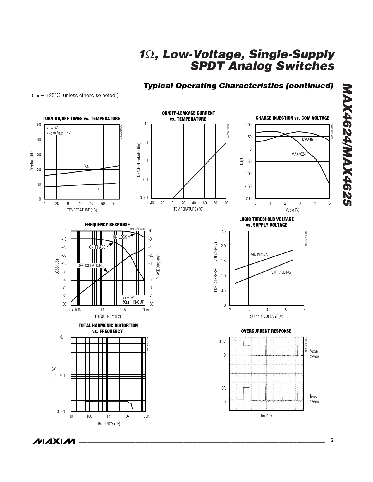

, Low-Voltage, Single-Supply SPDT Analog Switches MAX4624/MAX4625 _____________________________Typical Operating Characteristics (continued)
(TA = +25°C, unless otherwise noted.)
ON/OFF-LEAKAGE CURRENT TURN-ON/OFF TIMES vs. TEMPERATURE vs. TEMPERATURE CHARGE INJECTION vs. COM VOLTAGE
50 10 100 V+ = 5V VNO or VNC = 3V MAX4624TOC5 50 40 MAX4624TOC4 MAX4624 toc06 MAX4625 1 0 30 MAX4624 (ns) 0.1 -50 /t OFF t Q (pC) ON t ON 20 ON/OFF-LEAKAGE (nA) -100 0.01 10 t -150 OFF 0 0.001 -200 -40 -20 0 20 40 60 80 -40 -20 0 20 40 60 80 100 0 1 2 3 4 5 TEMPERATURE (°C) TEMPERATURE (°C) VCOM (V)
LOGIC THRESHOLD VOLTAGE FREQUENCY RESPONSE vs. SUPPLY VOLTAGE
MAX4624 toc07 0 10 2.5 ON-LOSS -10 -0 MAX4624 toc08 -20 ON-PHASE -10 2.0 -30 -20 VIN RISING 1.5 -40 -30 OFF-ISOLATION LOSS (dB) -50 -40 VIN FALLING 1.0 PHASE (degrees) -60 -50 -70 -60 LOGIC THRESHOLD VOLTAGE (V) 0.5 -80 -70 V+ = 5V -90 50Ω = IN/OUT -80 0 30k 100k 1M 10M 100M 2 3 4 5 6 FREQUENCY (Hz) SUPPLY VOLTAGE (V)
TOTAL HARMONIC DISTORTION vs. FREQUENCY OVERCURRENT RESPONSE
0.1 3.3V MAX4624 toc09 MAX4624 toc10 VCOM 0 2V/div 0.01 THD (%) 1.5A ICOM 0 1A/div 0.001 10 100 1k 10k 100k 1ms/div FRQUENCY (Hz)
