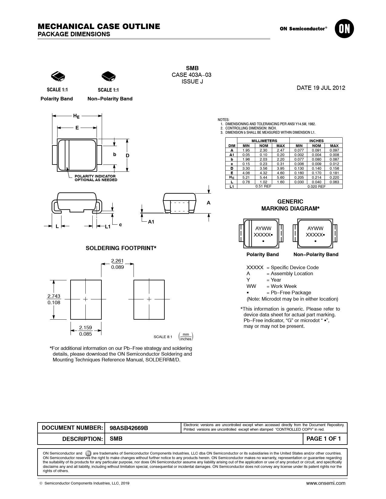

PACKAGE DIMENSIONS. SMB. SCALE 1:1. Polarity Band. Non−Polarity Band. MILLIMETERS. INCHES. DIM. MIN. NOM. MAX. POLARITY INDICATOR
MECHANICAL CASE OUTLINE
PACKAGE DIMENSIONS SMB
CASE 403A−03 ISSUE J DATE 19 JUL 2012
SCALE 1:1 SCALE 1:1 Polarity Band Non−Polarity Band HE
NOTES: 1. DIMENSIONING AND TOLERANCING PER ANSI Y14.5M, 1982.
E
2. CONTROLLING DIMENSION: INCH. 3. DIMENSION b SHALL BE MEASURED WITHIN DIMENSION L1.
MILLIMETERS INCHES DIM MIN NOM MAX MIN NOM MAX A
1.95 2.30 2.47 0.077 0.091 0.097
b D A1
0.05 0.10 0.20 0.002 0.004 0.008
b
1.96 2.03 2.20 0.077 0.080 0.087
c
0.15 0.23 0.31 0.006 0.009 0.012
D
3.30 3.56 3.95 0.130 0.140 0.156
E
4.06 4.32 4.60 0.160 0.170 0.181
POLARITY INDICATOR HE
5.21 5.44 5.60 0.205 0.214 0.220
OPTIONAL AS NEEDED L
0.76 1.02 1.60 0.030 0.040 0.063
L1
0.51 REF 0.020 REF
A GENERIC MARKING DIAGRAM* c A1 L L1
AYWW AYWW XXXXXG XXXXXG G G
SOLDERING FOOTPRINT* Polarity Band Non−Polarity Band
2.261 0.089 XXXXX = Specific Device Code A = Assembly Location Y = Year WW = Work Week G = Pb−Free Package 2.743 (Note: Microdot may be in either location) 0.108 *This information is generic. Please refer to device data sheet for actual part marking. Pb−Free indicator, “G” or microdot “ G”, may or may not be present. 2.159 0.085 SCALE 8:1 ǒ mm Ǔ inches *For additional information on our Pb−Free strategy and soldering details, please download the ON Semiconductor Soldering and Mounting Techniques Reference Manual, SOLDERRM/D.
DOCUMENT NUMBER: 98ASB42669B
Electronic versions are uncontrolled except when accessed directly from the Document Repository. Printed versions are uncontrolled except when stamped “CONTROLLED COPY” in red.
DESCRIPTION: SMB PAGE 1 OF 1
