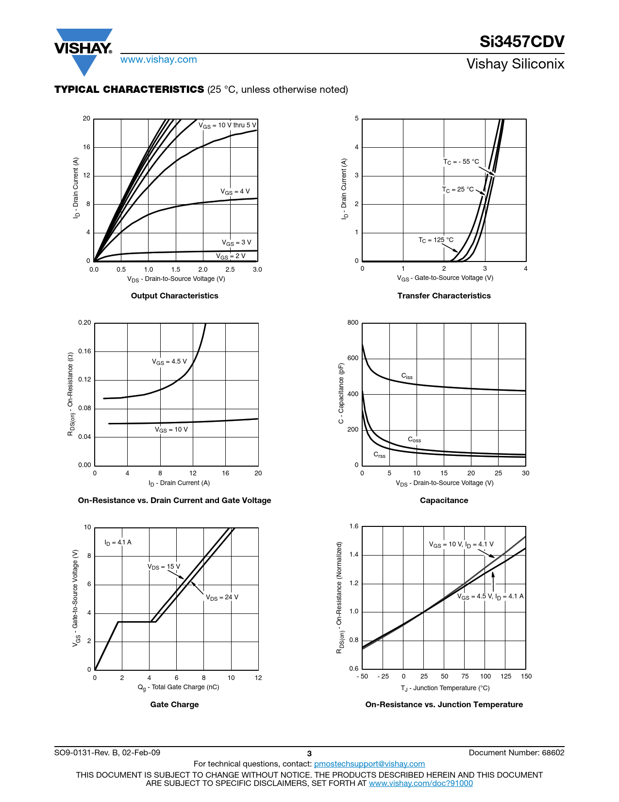

Si3457CDV. TYPICAL CHARACTERISTICS. Output Characteristics. Transfer Characteristics
Si3457CDV TYPICAL CHARACTERISTICS Output Characteristics Transfer Characteristics
Si3457CDV
(25 °C, unless otherwise noted) 20 5 VGS = 10 V thru 5 V 16 4 TC = - 55 °C 12 3 V T GS = 4 V C = 25 °C 8 2 - Drain Current (A) - Drain Current (A) I D I D 4 1 V TC = 125 °C GS = 3 V VGS = 2 V 0 0 0.0 0.5 1.0 1.5 2.0 2.5 3.0 0 1 2 3 4 V V DS - Drain-to-Source Voltage (V) GS - Gate-to-Source Voltage (V)
0.20 800 0.16 ) Ω 600 VGS = 4.5 V C 0.12 iss 400 - On-Resistance ( 0.08 C - Capacitance (pF) DS(on) VGS = 10 V 200 R 0.04 Coss Crss 0.00 0 0 4 8 12 16 20 0 5 10 15 20 25 30 ID - Drain Current (A) VDS - Drain-to-Source Voltage (V)
On-Resistance vs. Drain Current and Gate Voltage Capacitance
10 1.6 ID = 4.1 A VGS = 10 V, ID = 4.1 V 8 1.4 VDS = 15 V oltage (V) (Normalized) 6 1.2 V V DS = 24 V GS = 4.5 V, ID = 4.1 A 4 1.0 - On-Resistance - Gate-to-Source V GS 2 0.8 V DS(on)R 0 0.6 0 2 4 6 8 10 12 - 50 - 25 0 25 50 75 100 125 150 Qg - Total Gate Charge (nC) TJ - Junction Temperature (°C)
Gate Charge On-Resistance vs. Junction Temperature
