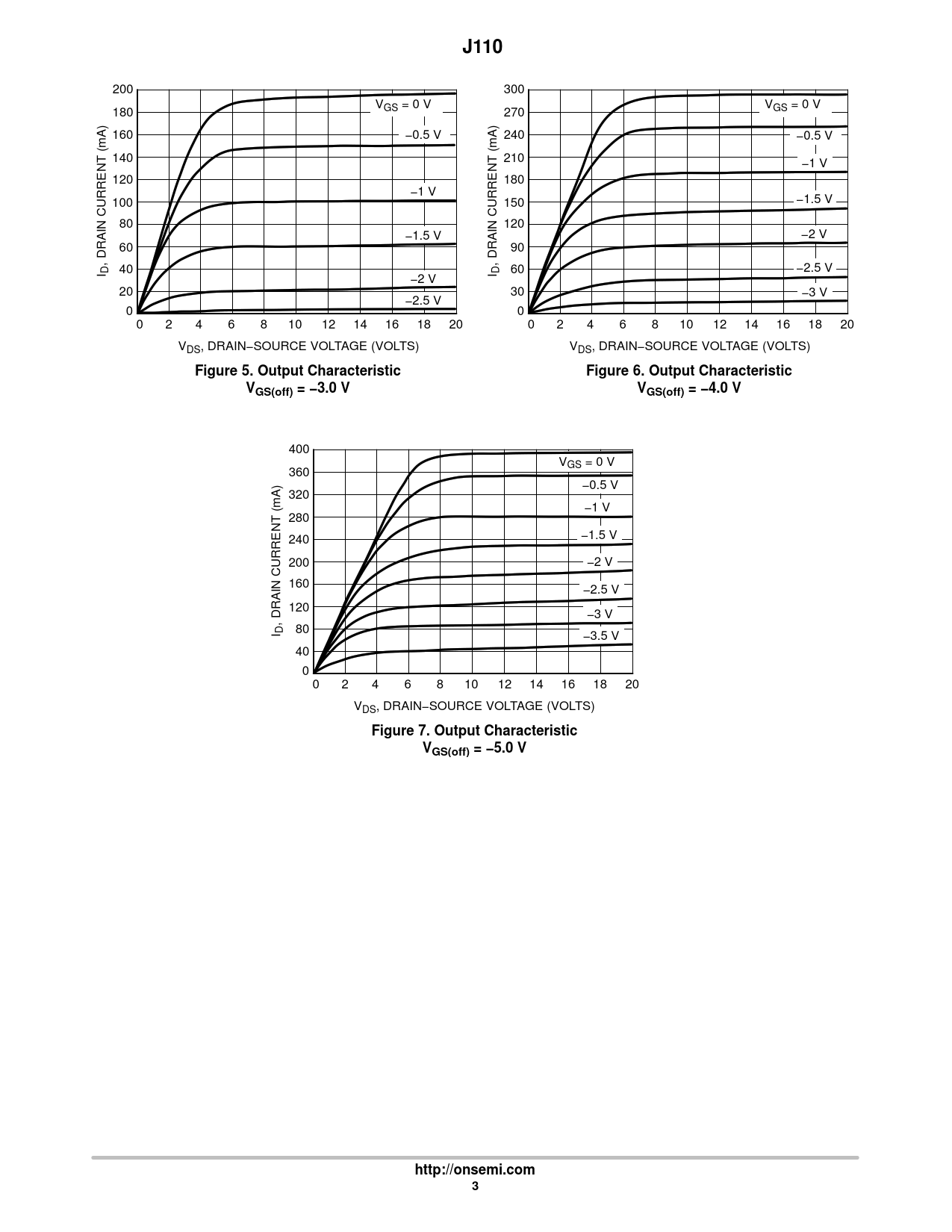

J110. Figure 5. Output Characteristic. Figure 6. Output Characteristic. VGS(off) = −3.0 V. VGS(off) = −4.0 V
J110 Figure 5 Output Characteristic Figure 6 Output Characteristic VGS(off) = −3.0 V VGS(off) = −4.0 V
J110
200 300 VGS = 0 V V 180 GS = 0 V 270 160 −0.5 V 240 −0.5 V 140 210 −1 V 120 180 −1 V 100 150 −1.5 V 80 120 −1.5 V −2 V 60 90 , DRAIN CURRENT (mA) , DRAIN CURRENT (mA) I D 40 I D 60 −2.5 V −2 V 20 30 −3 V −2.5 V 0 0 0 2 4 6 8 10 12 14 16 18 20 0 2 4 6 8 10 12 14 16 18 20 VDS, DRAIN−SOURCE VOLTAGE (VOLTS) VDS, DRAIN−SOURCE VOLTAGE (VOLTS)
Figure 5. Output Characteristic Figure 6. Output Characteristic VGS(off) = −3.0 V VGS(off) = −4.0 V
400 VGS = 0 V 360 −0.5 V 320 −1 V 280 240 −1.5 V 200 −2 V 160 −2.5 V 120 −3 V , DRAIN CURRENT (mA) I D 80 −3.5 V 40 0 0 2 4 6 8 10 12 14 16 18 20 VDS, DRAIN−SOURCE VOLTAGE (VOLTS)
Figure 7. Output Characteristic VGS(off) = −5.0 V http://onsemi.com 3
