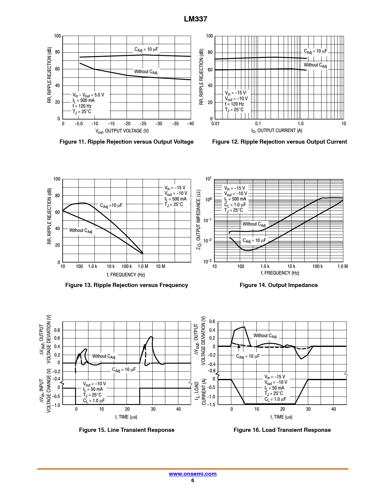

LM337. Figure 11. Ripple Rejection versus Output Voltage. Figure 12. Ripple Rejection versus Output Current
LM337 Figure 11 Ripple Rejection versus Output Voltage Figure 12 Ripple Rejection versus Output Current
LM337
100 100 C 80 Adj = 10 mF 80 CAdj = 10 mF Without CAdj 60 60 Without CAdj 40 40 V Vin = -15 V in - Vout = 5.0 V V RR, RIPPLE REJECTION (dB) out = -10 V 20 IL = 500 mA RR, RIPPLE REJECTION (dB) 20 f = 120 Hz f = 120 Hz T TJ = 25°C J = 25°C 0 0 0 -5.0 -10 -15 -20 -25 -30 -35 -40 0.01 0.1 1.0 10 Vout, OUTPUT VOLTAGE (V) IO, OUTPUT CURRENT (A)
Figure 11. Ripple Rejection versus Output Voltage Figure 12. Ripple Rejection versus Output Current
100 101 Vin = -15 V Vin = -15 V Vout = -10 V Ω 80 Vout = -10 V IL = 500 mA 100 IL = 500 mA C T C Adj =10 mF J = 25°C L = 1.0 mF 60 TJ = 25°C IMPEDANCE () 10-1 Without CAdj 40 Without CAdj C RR, RIPPLE REJECTION (dB) , OUTPUT 10-2 Adj = 10 mF 20 OZ 0 10-3 10 100 1.0 k 10 k 100 k 1.0 M 10 M 10 100 1.0 k 10 k 100 k 1.0 M f, FREQUENCY (Hz) f, FREQUENCY (Hz)
Figure 13. Ripple Rejection versus Frequency Figure 14. Output Impedance
0.6 TION (V) 0.8 TION (V) 0.4 Without C 0.6 0.2 Adj , OUTPUT , OUTPUT out 0.4 out 0 ΔV TAGE DEVIA ΔV 0.2 Without C TAGE DEVIA -0.2 Adj CAdj = 10 mF VOL 0 VOL -0.4 CAdj = 10 mF -0.2 -0.6 -0.4 0 Vin = -15 V V (A) V out = -10 V out = -10 V 0 I -0.5 IL = 50 mA , INPUT L = 50 mA in , LOAD T TJ = 25°C V -0.5 J = 25°C L -1.0 Δ I C CL = 1.0 mF TAGE CHANGE (V) L = 1.0 mF CURRENT -1.0 -1.5 0 10 20 30 40 VOL 0 10 20 30 40 t, TIME (ms) t, TIME (ms)
Figure 15. Line Transient Response Figure 16. Load Transient Response www.onsemi.com 6
