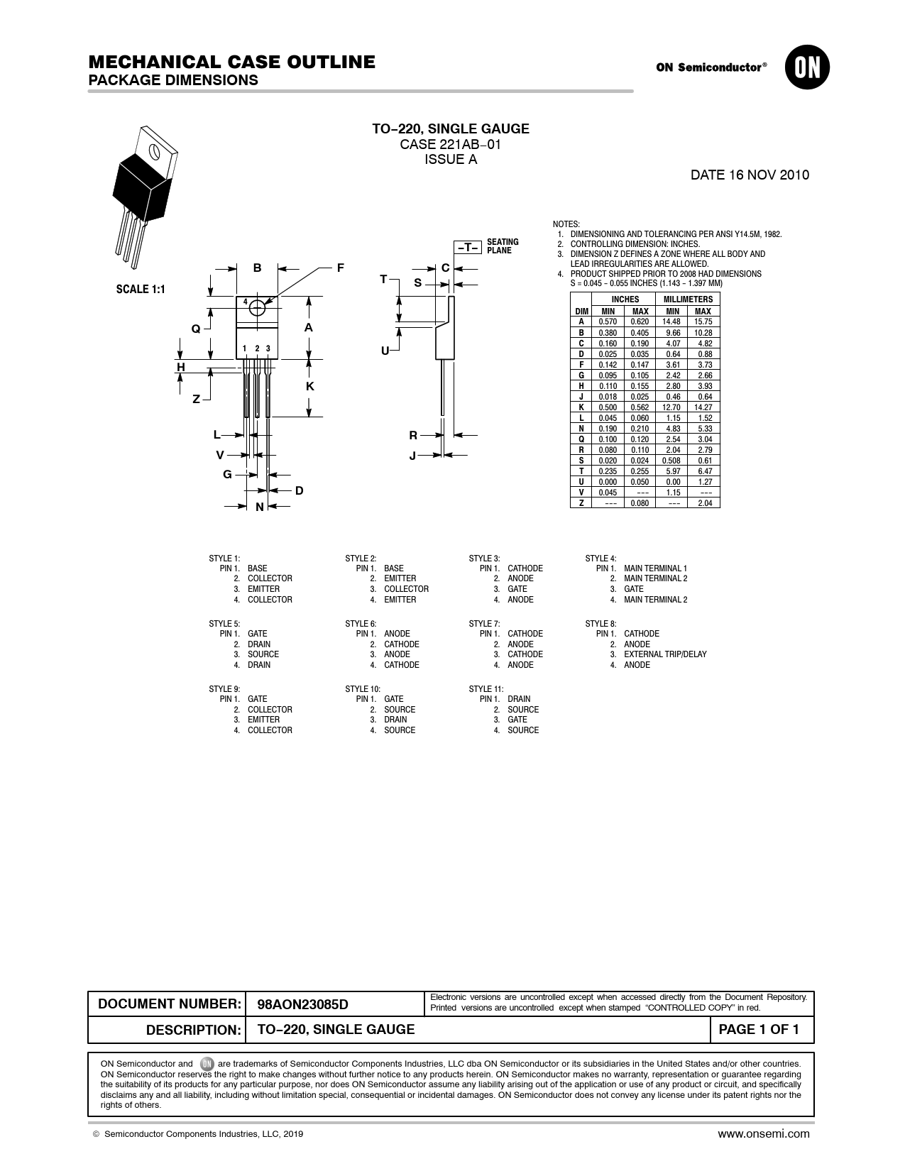

PACKAGE DIMENSIONS. TO−220, SINGLE GAUGE. SEATING. −T− PLANE. SCALE 1:1. INCHES. MILLIMETERS. DIM. MIN. MAX. 2 3
MECHANICAL CASE OUTLINE
PACKAGE DIMENSIONS TO−220, SINGLE GAUGE
CASE 221AB−01 ISSUE A DATE 16 NOV 2010 NOTES: 1. DIMENSIONING AND TOLERANCING PER ANSI Y14.5M, 1982.
SEATING
2. CONTROLLING DIMENSION: INCHES.
−T− PLANE
3. DIMENSION Z DEFINES A ZONE WHERE ALL BODY AND LEAD IRREGULARITIES ARE ALLOWED.
B F C
4. PRODUCT SHIPPED PRIOR TO 2008 HAD DIMENSIONS
T S
S = 0.045 - 0.055 INCHES (1.143 - 1.397 MM)
SCALE 1:1 INCHES MILLIMETERS 4 DIM MIN MAX MIN MAX A
0.570 0.620 14.48 15.75
Q A B
0.380 0.405 9.66 10.28
C
0.160 0.190 4.07 4.82
1 2 3 U D
0.025 0.035 0.64 0.88
F
0.142 0.147 3.61 3.73
H G
0.095 0.105 2.42 2.66
K H
0.110 0.155 2.80 3.93
J
0.018 0.025 0.46 0.64
Z K
0.500 0.562 12.70 14.27
L
0.045 0.060 1.15 1.52
N
0.190 0.210 4.83 5.33
L R Q
0.100 0.120 2.54 3.04
R
0.080 0.110 2.04 2.79
V J S
0.020 0.024 0.508 0.61
T
0.235 0.255 5.97 6.47
G U
0.000 0.050 0.00 1.27
D V
0.045 --- 1.15 ---
Z
--- 0.080 --- 2.04
N
STYLE 1: STYLE 2: STYLE 3: STYLE 4: PIN 1. BASE PIN 1. BASE PIN 1. CATHODE PIN 1. MAIN TERMINAL 1 2. COLLECTOR 2. EMITTER 2. ANODE 2. MAIN TERMINAL 2 3. EMITTER 3. COLLECTOR 3. GATE 3. GATE 4. COLLECTOR 4. EMITTER 4. ANODE 4. MAIN TERMINAL 2 STYLE 5: STYLE 6: STYLE 7: STYLE 8: PIN 1. GATE PIN 1. ANODE PIN 1. CATHODE PIN 1. CATHODE 2. DRAIN 2. CATHODE 2. ANODE 2. ANODE 3. SOURCE 3. ANODE 3. CATHODE 3. EXTERNAL TRIP/DELAY 4. DRAIN 4. CATHODE 4. ANODE 4. ANODE STYLE 9: STYLE 10: STYLE 11: PIN 1. GATE PIN 1. GATE PIN 1. DRAIN 2. COLLECTOR 2. SOURCE 2. SOURCE 3. EMITTER 3. DRAIN 3. GATE 4. COLLECTOR 4. SOURCE 4. SOURCE
