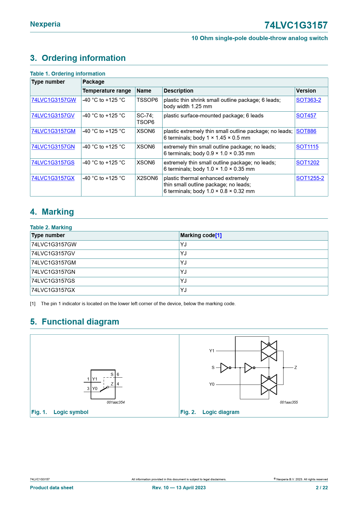

Nexperia 74LVC1G3157 10 Ohm single-pole double-throw analog switch 3. Ordering information Table 1. Ordering information Type number Package Temperature range Name Description Version
74LVC1G3157GW -40 °C to +125 °C TSSOP6 plastic thin shrink small outline package; 6 leads; SOT363-2 body width 1.25 mm 74LVC1G3157GV -40 °C to +125 °C SC-74; plastic surface-mounted package; 6 leads SOT457 TSOP6 74LVC1G3157GM -40 °C to +125 °C XSON6 plastic extremely thin small outline package; no leads; SOT886 6 terminals; body 1 × 1.45 × 0.5 mm 74LVC1G3157GN -40 °C to +125 °C XSON6 extremely thin small outline package; no leads; SOT1115 6 terminals; body 0.9 × 1.0 × 0.35 mm 74LVC1G3157GS -40 °C to +125 °C XSON6 extremely thin small outline package; no leads; SOT1202 6 terminals; body 1.0 × 1.0 × 0.35 mm 74LVC1G3157GX -40 °C to +125 °C X2SON6 plastic thermal enhanced extremely SOT1255-2 thin small outline package; no leads; 6 terminals; body 1.0 × 0.8 × 0.32 mm
4. Marking Table 2. Marking Type number Marking code[1]
74LVC1G3157GW YJ 74LVC1G3157GV YJ 74LVC1G3157GM YJ 74LVC1G3157GN YJ 74LVC1G3157GS YJ 74LVC1G3157GX YJ [1] The pin 1 indicator is located on the lower left corner of the device, below the marking code.
5. Functional diagram
Y1 S Z S 6 1 Y1 Z 4 Y0 3 Y0 001aac354 001aac355
Fig. 1. Logic symbol Fig. 2. Logic diagram
