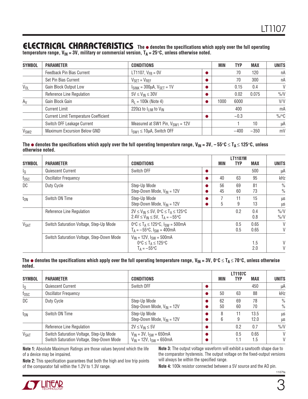

ELECTRICAL CH. ARA TERISTICS The. denotes the specifications which apply over the full operating
ELECTRICAL CH ARA TERISTICS The denotes the specifications which apply over the full operating
LT1107
ELECTRICAL CH C ARA TERISTICS The
denotes the specifications which apply over the full operating temperature range, VIN = 3V, military or commercial version, TA = 25
C, unless otherwise noted. SYMBOL PARAMETER CONDITIONS MIN TYP MAX UNITS
Feedback Pin Bias Current LT1107, VFB = 0V ● 70 120 nA Set Pin Bias Current VSET = VREF ● 70 300 nA VOL Gain Block Output Low ISINK = 300µA, VSET = 1V ● 0.15 0.4 V Reference Line Regulation 5V ≤ VIN ≤ 30V ● 0.02 0.075 %/V AV Gain Block Gain RL = 100k (Note 4) ● 1000 6000 V/V Current Limit 220Ω to ILIM to VIN 400 mA Current Limit Temperature Coefficient ● – 0.3 %/°C Switch OFF Leakage Current Measured at SW1 Pin, VSW1 = 12V 1 10 µA VSW2 Maximum Excursion Below GND ISW1 ≤ 10µA, Switch OFF – 400 – 350 mV
The
denotes the specifications which apply over the full operating temperature range, VIN = 3V, – 55
C
TA
125
C, unless otherwise noted. LT1107M SYMBOL PARAMETER CONDITIONS MIN TYP MAX UNITS
IQ Quiescent Current Switch OFF ● 500 µA fOSC Oscillator Frequency ● 40 63 95 kHz DC Duty Cycle Step-Up Mode ● 56 69 81 % Step-Down Mode, VIN = 12V ● 45 60 73 % tON Switch ON Time Step-Up Mode ● 7 11 15 µs Step-Down Mode, VIN = 12V ● 5 9 13 µs Reference Line Regulation 2V ≤ VIN ≤ 5V, 0°C ≤ TA ≤ 125°C 0.2 0.4 %/V 2.4V ≤ VIN ≤ 5V, TA = – 55°C 0.8 %/V VSAT Switch Saturation Voltage, Step-Up Mode 0°C ≤ TA ≤ 125°C, ISW = 500mA 0.5 0.65 V TA = – 55°C, ISW = 400mA 0.5 0.65 V Switch Saturation Voltage, Step-Down Mode VIN = 12V, ISW = 500mA 0°C ≤ TA ≤ 125°C 1.5 V TA = – 55°C 2.0 V
The
denotes the specifications which apply over the full operating temperature range, VIN = 3V, 0
C
TA
70
C, unless otherwise noted. LT1107C SYMBOL PARAMETER CONDITIONS MIN TYP MAX UNITS
IQ Quiescent Current Switch OFF ● 450 µA fOSC Oscillator Frequency ● 50 63 88 kHz DC Duty Cycle Step-Up Mode ● 62 69 78 % Step-Down Mode, VIN = 12V ● 50 60 70 % tON Switch ON Time Step-Up Mode ● 8 11 13.5 µs Step-Down Mode, VIN = 12V ● 6 9 12.0 µs Reference Line Regulation 2V ≤ VIN ≤ 5V ● 0.2 0.7 %/V VSAT Switch Saturation Voltage, Step-Up Mode VIN = 3V, ISW = 650mA ● 0.5 0.65 V Switch Saturation Voltage, Step-Down Mode VIN = 12V, ISW = 650mA ● 1.1 1.5 V
Note 1:
Absolute Maximum Ratings are those values beyond which the life
Note 3:
The output voltage waveform will exhibit a sawtooth shape due to of a device may be impaired. the comparator hysteresis. The output voltage on the fixed-output versions
Note 2:
This specification guarantees that both the high and low trip points will always be within the specified range. of the comparator fall within the 1.2V to 1.3V range.
Note 4:
100k resistor connected between a 5V source and the AO pin. 1107fa 3
