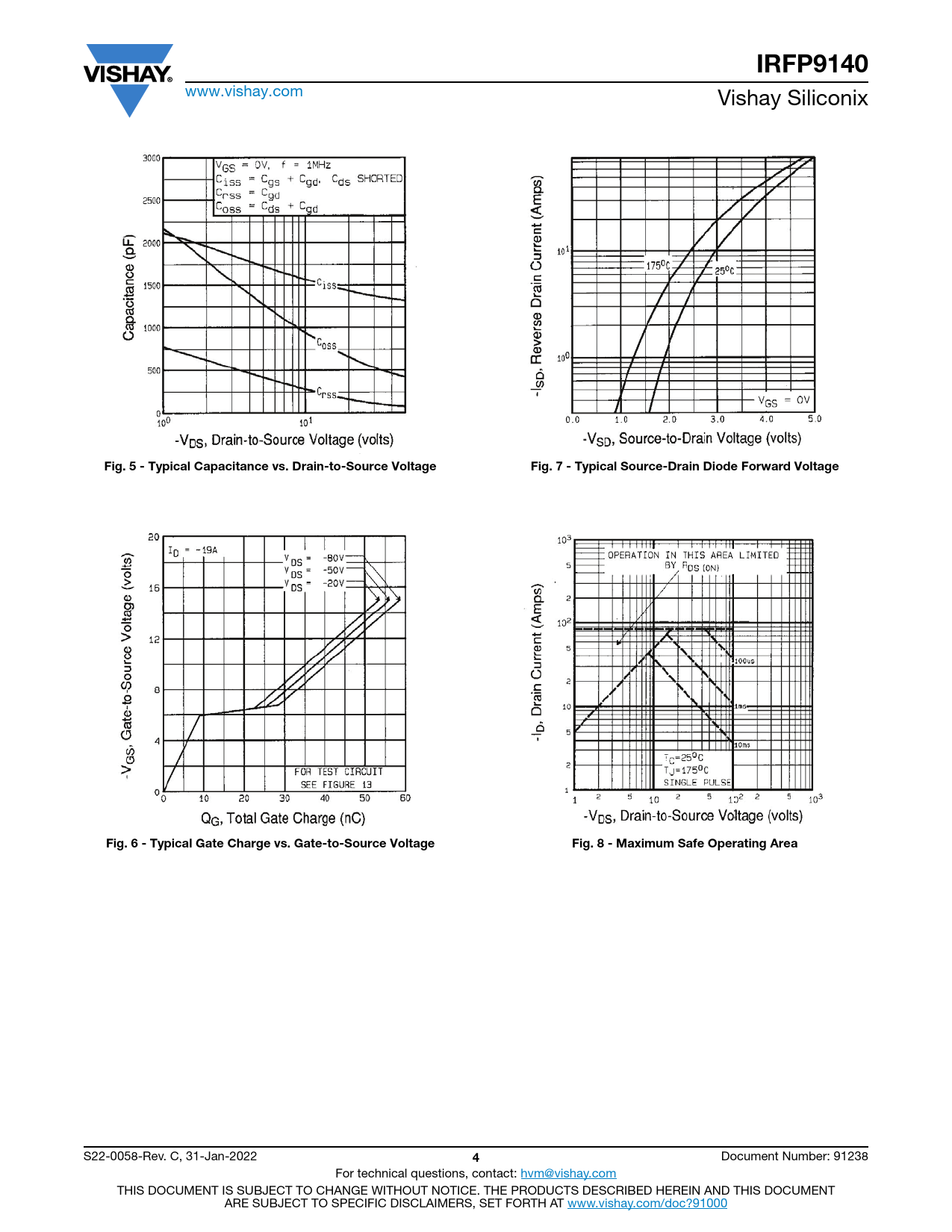

Pages / Page11 / 4 — IRFP9140. Fig. 5 - Typical Capacitance vs. Drain-to-Source Voltage. Fig. …
IRFP9140. Fig. 5 - Typical Capacitance vs. Drain-to-Source Voltage. Fig. 7 - Typical Source-Drain Diode Forward Voltage
IRFP9140 Fig 5 - Typical Capacitance vs Drain-to-Source Voltage Fig 7 - Typical Source-Drain Diode Forward Voltage
IRFP9140
Fig. 5 - Typical Capacitance vs. Drain-to-Source Voltage Fig. 7 - Typical Source-Drain Diode Forward Voltage Fig. 6 - Typical Gate Charge vs. Gate-to-Source Voltage Fig. 8 - Maximum Safe Operating Area
