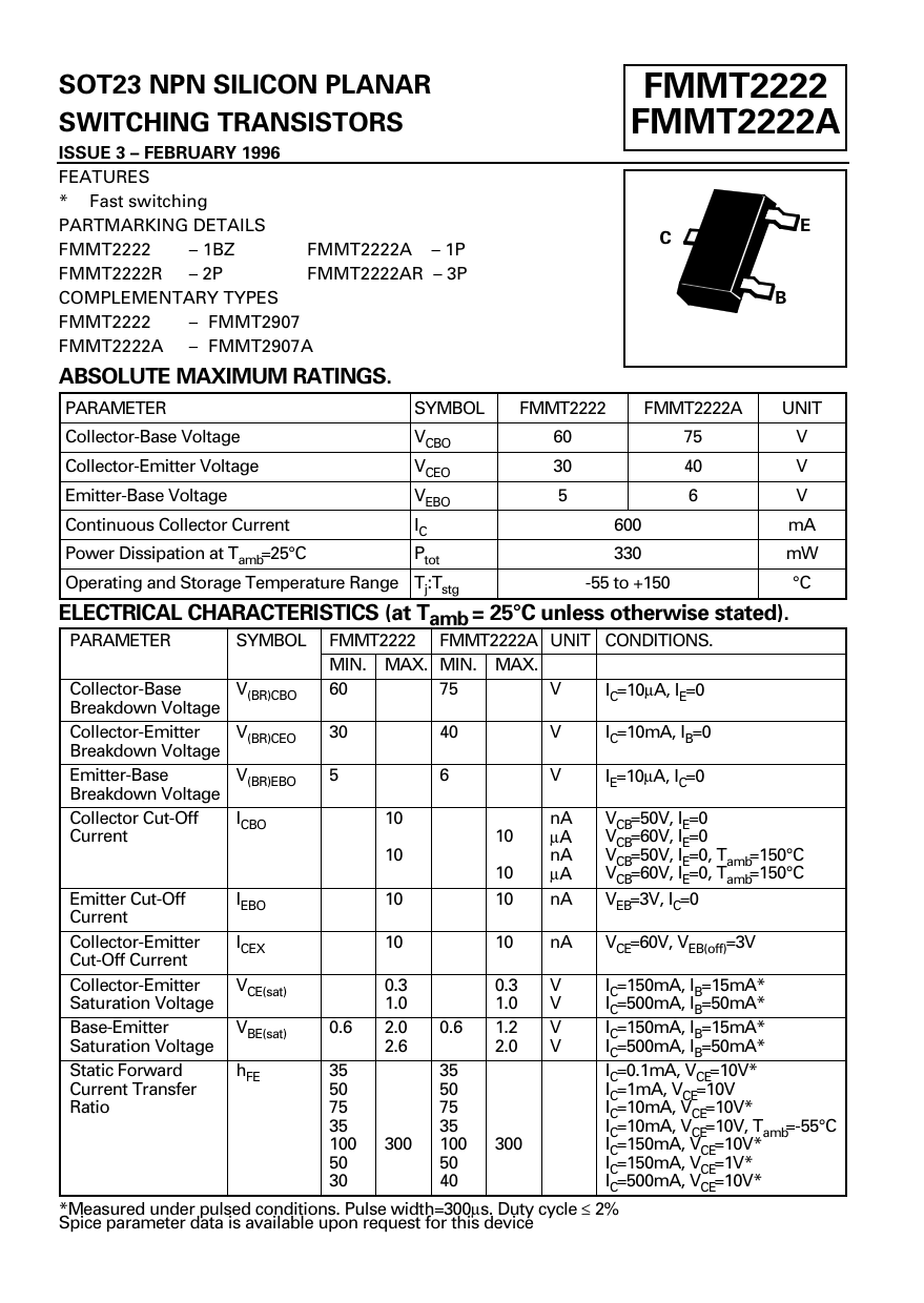

DescriptionSOT23 NPN Silicon Planar Switching Transistors

FMMT2222. SOT23. NPN. SILICON. PLANAR. FMMT2222. FMMT2222A. SWITCHING. TRANSISTORS. FMMT2222A. ISSUE. 3. –. FEBRUARY. 1996. FEATURES. ELECTRICAL
Datasheet FMMT2222,FMMT2222A Diodes
FMMT2222 SOT23 NPN SILICON PLANAR FMMT2222 FMMT2222A SWITCHING TRANSISTORS FMMT2222A ISSUE 3 – FEBRUARY 1996 FEATURES ELECTRICAL CHARACTERISTICS (at Tamb = 25°C unless otherwise stated). * Fast switching PARAMETER SYMBOL FMMT2222 FMMT2222A UNIT CONDITIONS. PARTMARKING DETAILS MIN. MAX. MIN. MAX. E C FMMT2222 – 1BZ FMMT2222A – 1P Transition fT 250 300 MHz IC=20mA, VCE=20V Frequency f=100MHz FMMT2222R – 2P FMMT2222AR – 3P Output Capacitance C COMPLEMENTARY TYPES B obo 8 8 pF VCB=10V, IE=0, f=140KHz FMMT2222 – FMMT2907 Input Capacitance Cibo 30 25 pF VEB=0.5V, IC=0 FMMT2222A – FMMT2907A f=140KHz Delay Time t ABSOLUTE MAXIMUM RATINGS. d 10 10 ns VCC=30V, VBE(off)=0.5V I Rise Time t C=150mA, IB1=15mA r 25 25 ns PARAMETER SYMBOL FMMT2222 FMMT2222A UNIT (See Delay Test Circuit) Col ector-Base Voltage V Storage Time t CBO 60 75 V s 225 225 ns VCC=30V, IC=150mA I Fall Time t B1= IB2=15mA f 60 60 ns Collector-Emitter Voltage VCEO 30 40 V (See Storage Test Circuit) Emitter-Base Voltage VEBO 5 6 V Continuous Col ector Current IC 600 mA DELAY AND RISE – TEST CIRCUIT Power Dissipation at Tamb=25°C Ptot 330 mW +30V Operating and Storage Temperature Range Tj:Tstg -55 to +150 °C Generator rise time <2ns ELECTRICAL CHARACTERISTICS (at Tamb = 25°C unless otherwise stated). PARAMETER SYMBOL FMMT2222 FMMT2222A UNIT CONDITIONS. Pulse width (t1)<200ns 200Ω MIN. MAX. MIN. MAX. Duty cycle = 2% Collector-Base V(BR)CBO 60 75 V I Breakdown Voltage C=10µA, IE=0 619Ω 9.9V Collector-Emitter V(BR)CEO 30 40 V IC=10mA, IB=0 Breakdown Voltage Scope: Emitter-Base V(BR)EBO 5 6 V I 0 Rin > 100 kΩ Breakdown Voltage E=10µA, IC=0 0.5V Cin < 12 pF Collector Cut-Off ICBO 10 nA VCB=50V, IE=0 Current 10 µA V Rise Time < 5 ns CB=60V, IE=0 10 nA VCB=50V, IE=0, Tamb=150°C 10 µA VCB=60V, IE=0, Tamb=150°C STORAGE TIME AND FALL TIME – TEST CIRCUIT Emitter Cut-Off IEBO 10 10 nA VEB=3V, IC=0 Current +30V Collector-Emitter ICEX 10 10 nA VCE=60V, VEB(off) =3V =100µs Cut-Off Current <5ns Collector-Emitter V 200Ω CE(sat) 0.3 0.3 V IC=150mA, IB=15mA* Saturation Voltage 1.0 1.0 V I +16.2 V C=500mA, IB=50mA* Base-Emitter VBE(sat) 0.6 2.0 0.6 1.2 V IC=150mA, IB=15mA* Saturation Voltage 2.6 2.0 V IC=500mA, IB=50mA* 0 Static Forward h 1KΩ FE 35 35 IC=0.1mA, VCE=10V* Current Transfer 50 50 IC=1mA, VCE=10V Scope: Ratio 75 75 IC=10mA, VCE=10V* Rin > 100 kΩ 35 35 IC=10mA, VCE=10V, Tamb=-55°C 1N916 Cin < 12 pF 100 300 100 300 IC=150mA, VCE=10V* -13.8 V Rise Time < 5 ns 50 50 IC=150mA, VCE=1V* -3V 30 40 IC=500mA, VCE=10V* =500µs *Measured under pulsed conditions. Pulse width=300µs. Duty cycle ≤ 2% Spice parameter data is available upon request for this device Duty cycle = 2%
