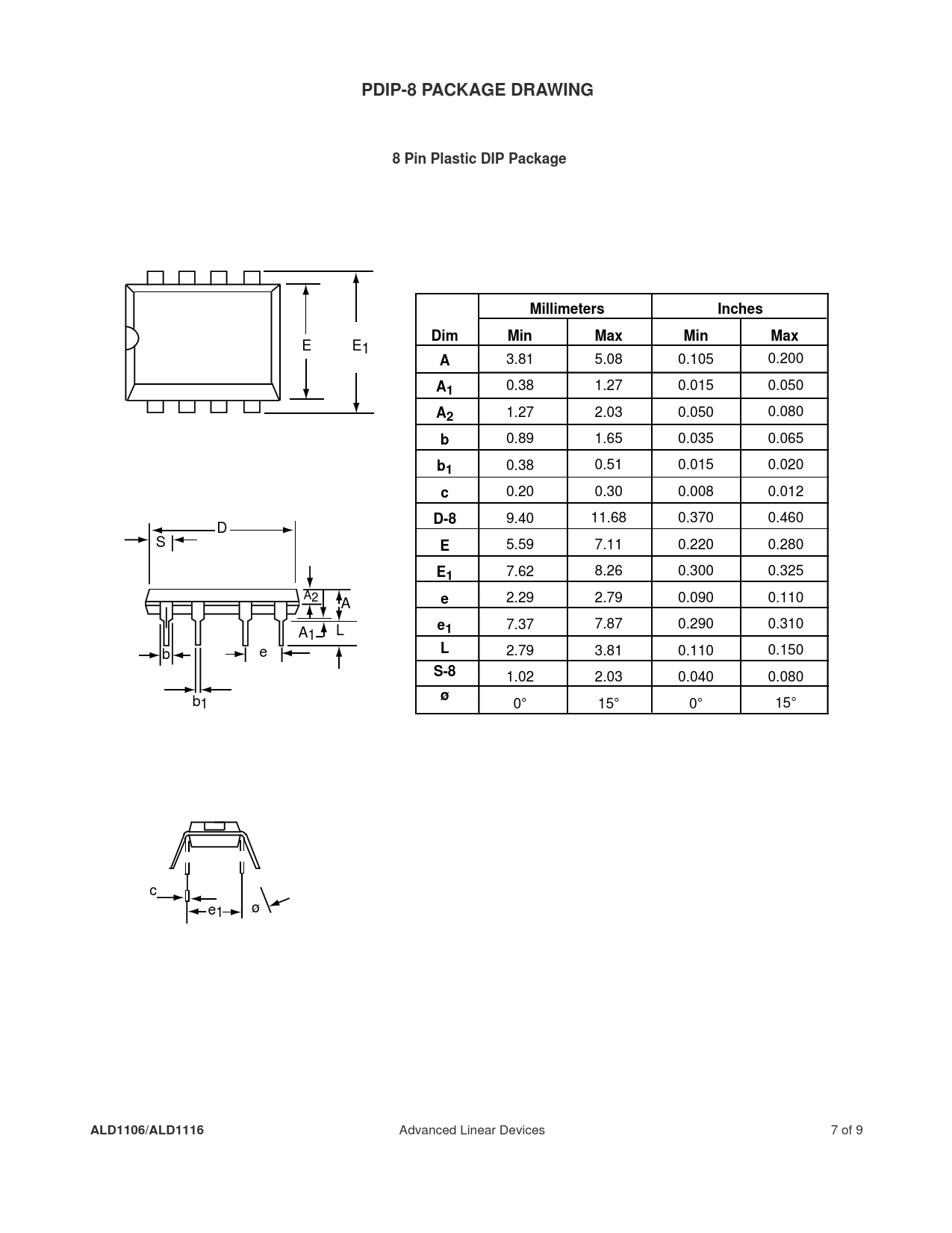

PDIP-8 PACKAGE DRAWING. 8 Pin Plastic DIP Package. Millimeters. Inches. Dim. Min. Max. D-8. S-8. ALD1106/ALD1116
PDIP-8 PACKAGE DRAWING 8 Pin Plastic DIP Package Millimeters Inches Dim Min Max Min Max
E E1
A
3.81 5.08 0.105 0.200
A1
0.38 1.27 0.015 0.050
A2
1.27 2.03 0.050 0.080
b
0.89 1.65 0.035 0.065
b1
0.38 0.51 0.015 0.020
c
0.20 0.30 0.008 0.012
D-8
9.40 11.68 0.370 0.460 D S
E
5.59 7.11 0.220 0.280
E1
7.62 8.26 0.300 0.325 A2 A
e
2.29 2.79 0.090 0.110
e
7.37 7.87 0.290 0.310 A
1
1 L b e
L
2.79 3.81 0.110 0.150
S-8
1.02 2.03 0.040 0.080 b
ø
1 0° 15° 0° 15° c e1 ø
