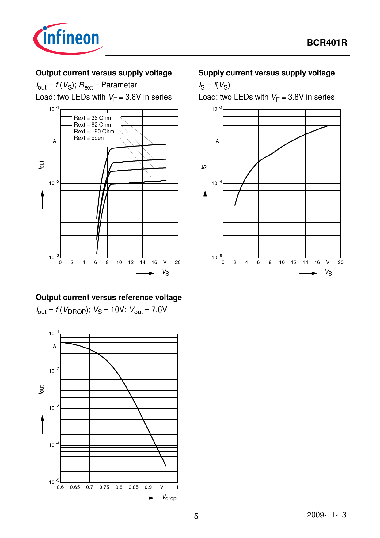

Pages / Page8 / 5 — BCR401R. Output current versus supply voltage. Supply current versus …
File Format / SizePDF / 92 Kb
BCR401R. Output current versus supply voltage. Supply current versus supply voltage. Output current versus reference voltage
BCR401R Output current versus supply voltage Supply current versus supply voltage Output current versus reference voltage
I I out = f (VS); Rext = Parameter S = f(VS) Load: two LEDs with V Load: two LEDs with V F = 3.8V in series F = 3.8V in series -1 -3 10 10 Rext = 36 Ohm Rext = 82 Ohm Rext = 160 Ohm Rext = open A A I out I S -2 -4 10 10 -3 -5 10 10 0 2 4 6 8 10 12 14 16 V 20 0 2 4 6 8 10 12 14 16 V 20 V V S S
