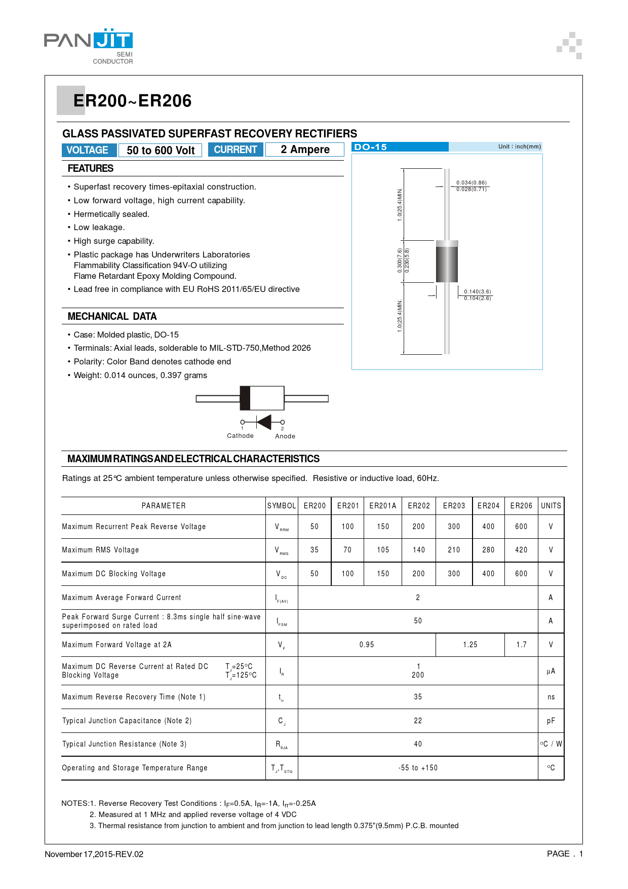

ER200~ER206. GLASS PASSIVATED SUPERFAST RECOVERY RECTIFIERS. CURRENT. 2 Ampere. VOLTAGE. 50 to 600 Volt. FEATURES. 0.034(0.86)
Datasheet ER200, ER201, ER201A, ER202, ER203, ER204, ER206 PanJit
ER200~ER206
CURRENT
2 Ampere
VOLTAGE
50 to 600 Volt
FEATURES
0.034(0.86)
0.028(0.71) 1.0(25.4)MIN. • Superfast recovery times-epitaxial construction.
• Low forward voltage, high current capability.
• Hermetically sealed.
• Low leakage. 0.300(7.6)
0.230(5.8) • High surge capability.
• Plastic package has Underwriters Laboratories
Flammability Classification 94V-O utilizing
Flame Retardant Epoxy Molding Compound.
• Lead free in compliance with EU RoHS 2011/65/EU directive
1.0(25.4)MIN. 0.140(3.6)
0.104(2.6) MECHANICAL DATA
• Case: Molded plastic, DO-15
• Terminals: Axial leads, solderable to MIL-STD-750,Method 2026
• Polarity: Color Band denotes cathode end
• Weight: 0.014 ounces, 0.397 grams 1 Cathode 2 Anode MAXIMUM RATINGS AND ELECTRICAL CHARACTERISTICS
Ratings at 25°C ambient temperature unless otherwise specified. Resistive or inductive load, 60Hz.
PA RA ME TE R S YMB OL E R2 0 0 E R2 0 1 E R2 0 1 A E R2 0 2 E R2 0 3 E R2 0 4 E R2 0 6 UNITS Ma xi mum Re curre nt P e a k Re ve rse Vo lta g e V RRM 50 100 150 200 300 400 600 V Ma xi mum RMS Vo lta g e V RMS 35 70 105 140 210 280 420 V Ma xi mum D C B lo c ki ng Vo lta g e V DC 50 100 150 200 300 400 600 V Ma xi mum A ve r a g e F o rwa rd C urr e nt IF (AV ) 2 A P e a k F o r wa rd S urg e C urre nt : 8 .3 m i ng le ha lf si ne -wa ve
sup e ri mp o se d o n ra te d lo a d IF S M 50 A Ma xi mum F o r wa rd Vo lta g e a t 2 A VF Ma xi mum D C Re ve rse C urre nt a t Ra te d D C
B lo cki ng Vo lta g e T J =2 5 O C
T J =1 2 5 O C 0 .9 5 1 .2 5 1 .7 V IR 1
200 μA Ma xi mum Re ve rse Re c o ve r y Ti me (No te 1 ) t rr 35 ns Typ i ca l Junc ti o n C a p a ci ta nce (No te 2 ) CJ 22 pF R θJA 40 T J ,T S TG -5 5 to +1 5 0 Typ i ca l Junc ti o n Re s i sta nc e ( No te 3 )
Op e ra ti ng a nd S to ra g e Te mp e ra ture Ra ng e O C / W
O C NOTES:1. Reverse Recovery Test Conditions : IF=0.5A, IR=-1A, Irr=-0.25A
2. Measured at 1 MHz and applied reverse voltage of 4 VDC
3. Thermal resistance from junction to ambient and from junction to lead length 0.375"(9.5mm) P.C.B. mounted November 17,2015-REV.02 PAGE . 1
