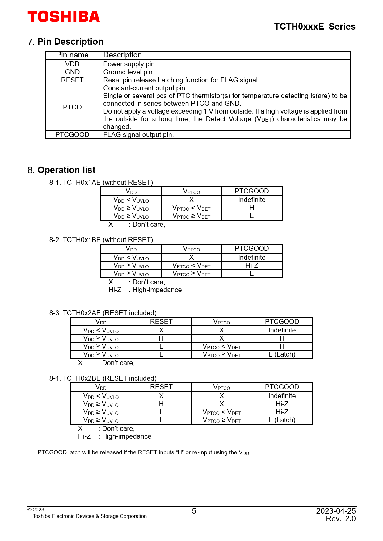

TCTH0xxxE Series. Pin Description. Operation list
TCTH0xxxE Series Pin Description Operation list
Pin name Description VDD Power supply pin. GND Ground level pin. RESET Reset pin release Latching function for FLAG signal. Constant-current output pin. Single or several pcs of PTC thermistor(s) for temperature detecting is(are) to be connected in series between PTCO and GND. PTCO Do not apply a voltage exceeding 1 V from outside. If a high voltage is applied from the outside for a long time, the Detect Voltage (VDET) characteristics may be changed. PTCGOOD FLAG signal output pin.
Operation list
8-1. TCTH0x1AE (without RESET) VDD VPTCO PTCGOOD VDD < VUVLO X Indefinite VDD ≥ VUVLO VPTCO < VDET H VDD ≥ VUVLO VPTCO ≥ VDET L X : Don’t care, 8-2. TCTH0x1BE (without RESET) VDD VPTCO PTCGOOD VDD < VUVLO X Indefinite VDD ≥ VUVLO VPTCO < VDET Hi-Z VDD ≥ VUVLO VPTCO ≥ VDET L X : Don’t care, Hi-Z : High-impedance 8-3. TCTH0x2AE (RESET included) VDD RESET VPTCO PTCGOOD VDD < VUVLO X X Indefinite VDD ≥ VUVLO H X H VDD ≥ VUVLO L VPTCO < VDET H VDD ≥ VUVLO L VPTCO ≥ VDET L (Latch) X : Don’t care, 8-4. TCTH0x2BE (RESET included) VDD RESET VPTCO PTCGOOD VDD < VUVLO X X Indefinite VDD ≥ VUVLO H X Hi-Z VDD ≥ VUVLO L VPTCO < VDET Hi-Z VDD ≥ VUVLO L VPTCO ≥ VDET L (Latch) X : Don’t care, Hi-Z : High-impedance PTCGOOD latch wil be released if the RESET inputs “H” or re-input using the VDD. © 2023 5 2023-04-25 Toshiba Electronic Devices & Storage Corporation Rev. 2.0
