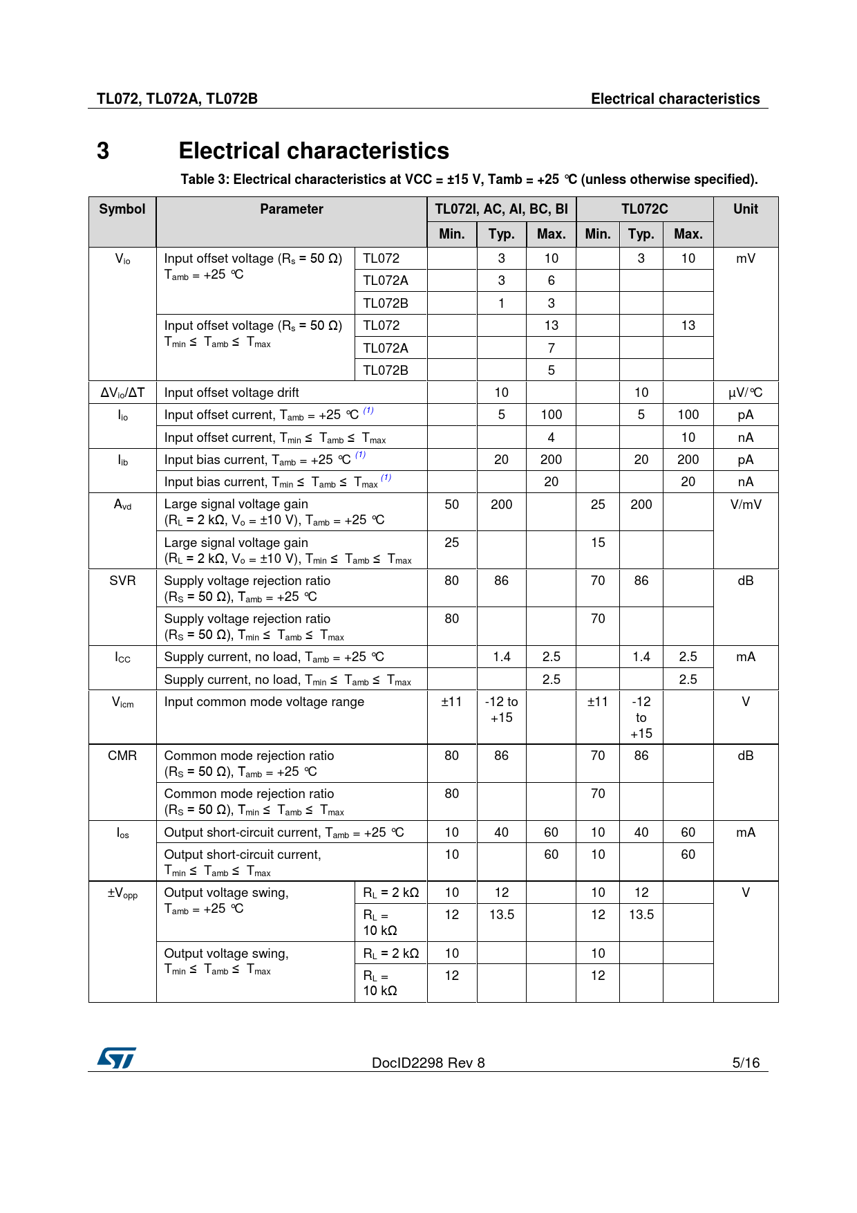

TL072, TL072A, TL072B. Electrical characteristics
link to page 6
TL072, TL072A, TL072B Electrical characteristics 3 Electrical characteristics Table 3: Electrical characteristics at VCC = ±15 V, Tamb = +25 °C (unless otherwise specified). Symbol Parameter TL072I, AC, AI, BC, BI TL072C Unit Min. Typ. Max. Min. Typ. Max.
Vio Input offset voltage (Rs = 50 Ω) TL072 3 10 3 10 mV Tamb = +25 °C TL072A 3 6 TL072B 1 3 Input offset voltage (Rs = 50 Ω) TL072 13 13 Tmin ≤ Tamb ≤ Tmax TL072A 7 TL072B 5 ΔVio/ΔT Input offset voltage drift 10 10 µV/°C Iio Input offset current, Tamb = +25 °C (1) 5 100 5 100 pA Input offset current, Tmin ≤ Tamb ≤ Tmax 4 10 nA Iib Input bias current, Tamb = +25 °C (1) 20 200 20 200 pA Input bias current, T (1) min ≤ Tamb ≤ Tmax 20 20 nA Avd Large signal voltage gain 50 200 25 200 V/mV (RL = 2 kΩ, Vo = ±10 V), Tamb = +25 °C Large signal voltage gain 25 15 (RL = 2 kΩ, Vo = ±10 V), Tmin ≤ Tamb ≤ Tmax SVR Supply voltage rejection ratio 80 86 70 86 dB (RS = 50 Ω), Tamb = +25 °C Supply voltage rejection ratio 80 70 (RS = 50 Ω), Tmin ≤ Tamb ≤ Tmax ICC Supply current, no load, Tamb = +25 °C 1.4 2.5 1.4 2.5 mA Supply current, no load, Tmin ≤ Tamb ≤ Tmax 2.5 2.5 Vicm Input common mode voltage range ±11 -12 to ±11 -12 V +15 to +15 CMR Common mode rejection ratio 80 86 70 86 dB (RS = 50 Ω), Tamb = +25 °C Common mode rejection ratio 80 70 (RS = 50 Ω), Tmin ≤ Tamb ≤ Tmax Ios Output short-circuit current, Tamb = +25 °C 10 40 60 10 40 60 mA Output short-circuit current, 10 60 10 60 Tmin ≤ Tamb ≤ Tmax ±Vopp Output voltage swing, RL = 2 kΩ 10 12 10 12 V Tamb = +25 °C RL = 12 13.5 12 13.5 10 kΩ Output voltage swing, RL = 2 kΩ 10 10 Tmin ≤ Tamb ≤ Tmax RL = 12 12 10 kΩ DocID2298 Rev 8 5/16 Document Outline 1 Schematic diagram 2 Absolute maximum ratings and operating conditions 3 Electrical characteristics 4 Parameter measurement information 5 Typical application 6 Package information 6.1 SO8 package information 7 Ordering information 8 Revision history
