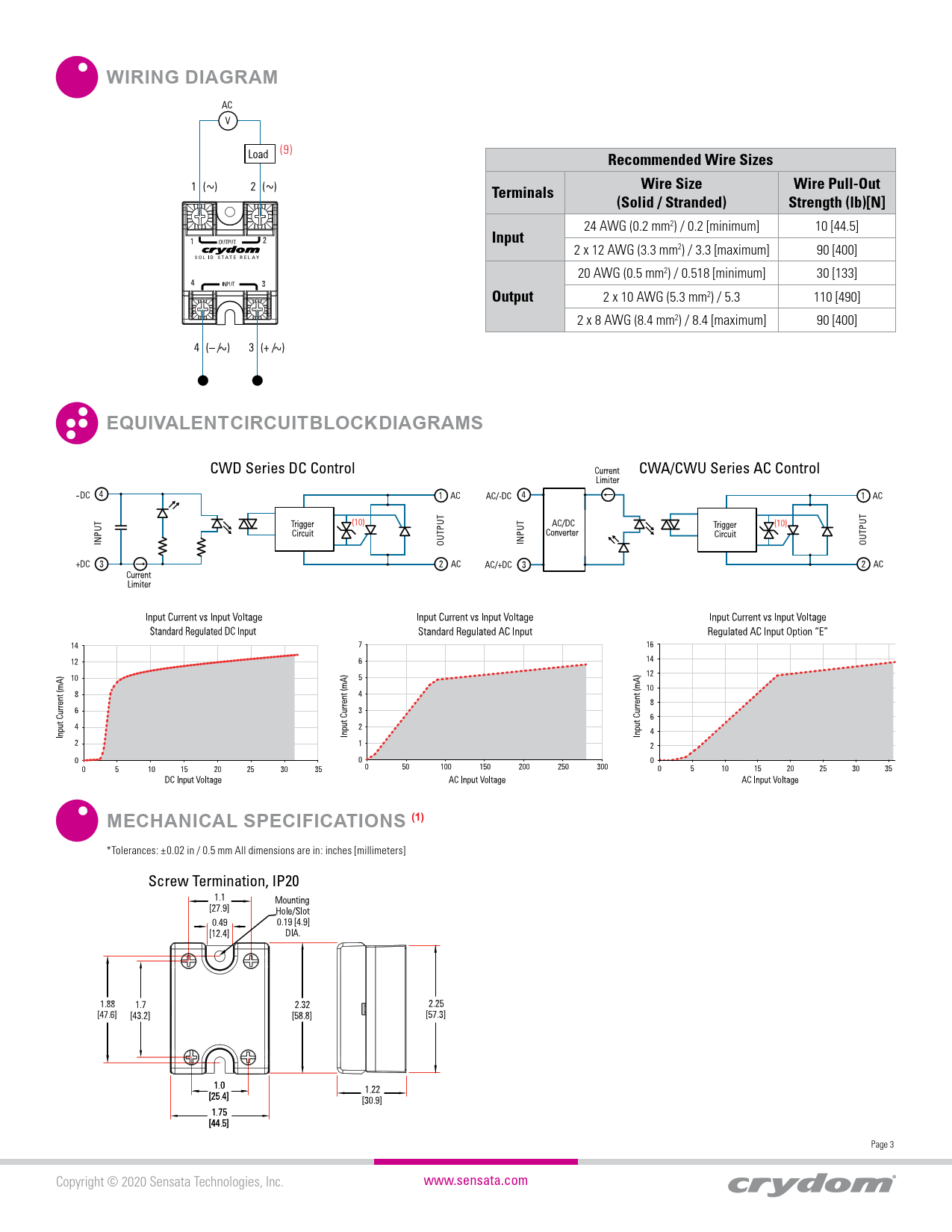

WIRING DIAGRAM. Recommended Wire Sizes. Terminals. Wire Size. Wire Pull-Out. (Solid / Stranded). Strength (lb)[N]. Input. Output
![WIRING DIAGRAM Recommended Wire Sizes Terminals Wire Size Wire Pull-Out (Solid / Stranded) Strength (lb)[N] Input Output](https://www.rlocman.ru/datasheet/img.php?di=179901&p=2)
WIRING DIAGRAM
(9)
24 AWG (0.2 mm2) / 0.2 [minimum] 10 [44.5]
Input
2 x 12 AWG (3.3 mm2) / 3.3 [maximum] 90 [400] 20 AWG (0.5 mm2) / 0.518 [minimum] 30 [133]
Output
2 x 10 AWG (5.3 mm2) / 5.3 110 [490] 2 x 8 AWG (8.4 mm2) / 8.4 [maximum] 90 [400]
EQUIVALENT CIRCUIT BLOCK DIAGRAMS
CWD Series DC Control CWA/CWU Series AC Control
