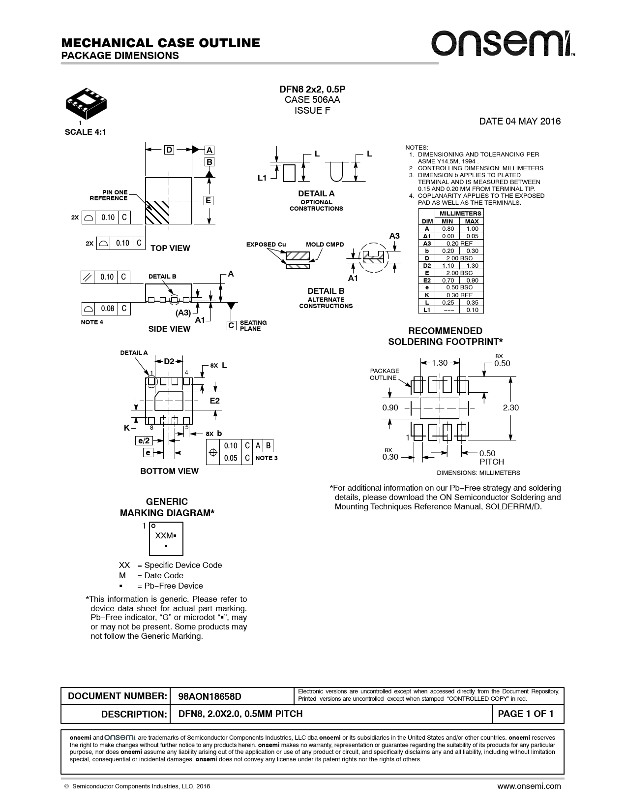

PACKAGE DIMENSIONS. DFN8 2x2, 0.5P. SCALE 4:1. PIN ONE. DETAIL A. REFERENCE. OPTIONAL. CONSTRUCTIONS. MILLIMETERS. DIM. MIN. MAX. TOP VIEW
MECHANICAL CASE OUTLINE
PACKAGE DIMENSIONS DFN8 2x2, 0.5P
CASE 506AA ISSUE F 1 DATE 04 MAY 2016
SCALE 4:1
NOTES:
D A L L
1. DIMENSIONING AND TOLERANCING PER
B
ASME Y14.5M, 1994 . 2. CONTROLLING DIMENSION: MILLIMETERS. 3. DIMENSION b APPLIES TO PLATED
L1
TERMINAL AND IS MEASURED BETWEEN 0.15 AND 0.20 MM FROM TERMINAL TIP.
PIN ONE DETAIL A
4. COPLANARITY APPLIES TO THE EXPOSED
REFERENCE E OPTIONAL
PAD AS WELL AS THE TERMINALS. ÇÇ
CONSTRUCTIONS MILLIMETERS 2X
0.10 C ÇÇ
DIM MIN MAX A
0.80 1.00
A3
ÇÇ
A1
0.00 0.05
2X
0.10 C
TOP VIEW EXPOSED Cu MOLD CMPD A3
0.20 REF ÉÉ ÉÉ
b
0.20 0.30
D
2.00 BSC ÉÉ ÇÇ ÉÉ ÇÇ
D2
1.10 1.30
DETAIL B A E
2.00 BSC 0.10 C
A1
ÇÇ
E2
0.70 0.90
e
0.50 BSC
DETAIL B K
0.30 REF
ALTERNATE L
0.25 0.35 0.08 C
CONSTRUCTIONS (A3) L1
−−− 0.10
NOTE 4 A1 SEATING SIDE VIEW C PLANE RECOMMENDED SOLDERING FOOTPRINT* DETAIL A
8X
D2 8X
1.30
L
0.50 PACKAGE 1 4 OUTLINE
E2
0.90 2.30
K
8 5
8X b
1
e/2
0.10 C A B 8X
e
0.50 0.05 C
NOTE 3
0.30 PITCH
BOTTOM VIEW
DIMENSIONS: MILLIMETERS *For additional information on our Pb−Free strategy and soldering details, please download the ON Semiconductor Soldering and
GENERIC
Mounting Techniques Reference Manual, SOLDERRM/D.
MARKING DIAGRAM*
1 XXMG G XX = Specific Device Code M = Date Code G = Pb−Free Device *This information is generic. Please refer to device data sheet for actual part marking. Pb−Free indicator, “G” or microdot “G”, may or may not be present. Some products may not follow the Generic Marking.
DOCUMENT NUMBER: 98AON18658D
Electronic versions are uncontrolled except when accessed directly from the Document Repository. Printed versions are uncontrolled except when stamped “CONTROLLED COPY” in red.
DESCRIPTION: DFN8, 2.0X2.0, 0.5MM PITCH PAGE 1 OF 1 onsemi
