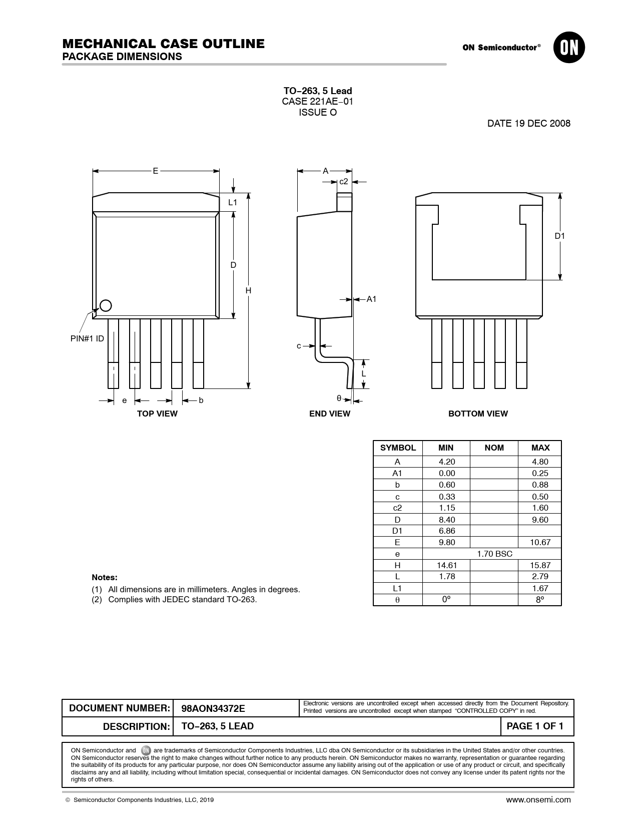

PACKAGE DIMENSIONS. TO−263, 5 Lead. TOP VIEW. END VIEW. BOTTOM VIEW. SYMBOL. MIN. NOM. MAX. Notes:. DOCUMENT NUMBER: 98AON34372E
MECHANICAL CASE OUTLINE
PACKAGE DIMENSIONS TO−263, 5 Lead
CASE 221AE−01 ISSUE O DATE 19 DEC 2008 E A c2 L1 D1 D H A1 PIN#1 ID c L e b θ
TOP VIEW END VIEW BOTTOM VIEW SYMBOL MIN NOM MAX
A 4.20 4.80 A1 0.00 0.25 b 0.60 0.88 c 0.33 0.50 c2 1.15 1.60 D 8.40 9.60 D1 6.86 E 9.80 10.67 e 1.70 BSC H 14.61 15.87
Notes:
L 1.78 2.79 (1) All dimensions are in millimeters. Angles in degrees. L1 1.67 (2) Complies with JEDEC standard TO-263. q 0º 8º
