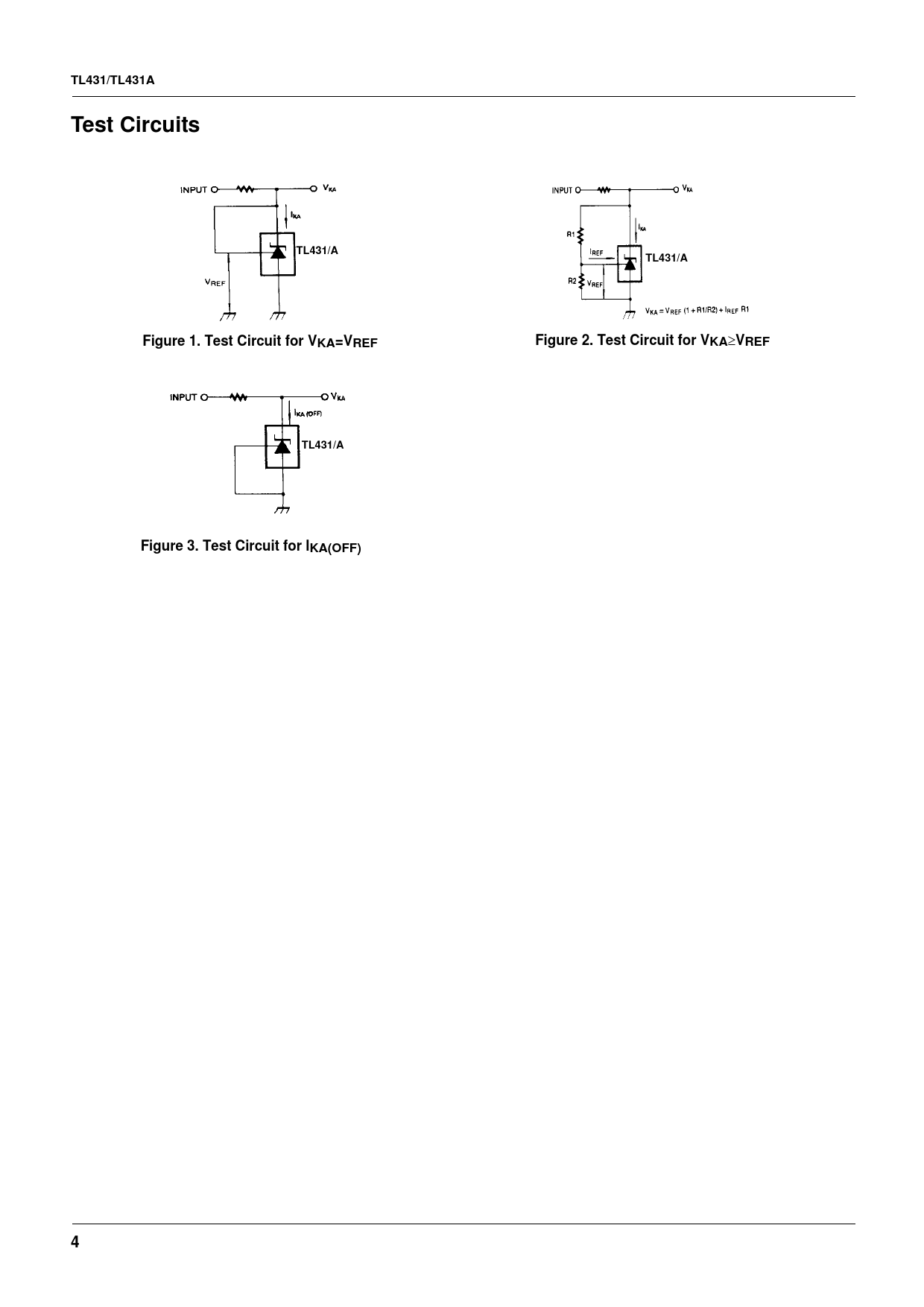

— TL431/TL431A. Test Circuits. TL431/A. Figure 1. Test Circuit for …
100 Kb
TL431/TL431A. Test Circuits. TL431/A. Figure 1. Test Circuit for VKA=VREF. Figure 2. Test Circuit for VKA. VREF

Test Circuits
TL431/A
TL431/A
VREF
TL431/A
Figure 3. Test Circuit for lKA(OFF)
