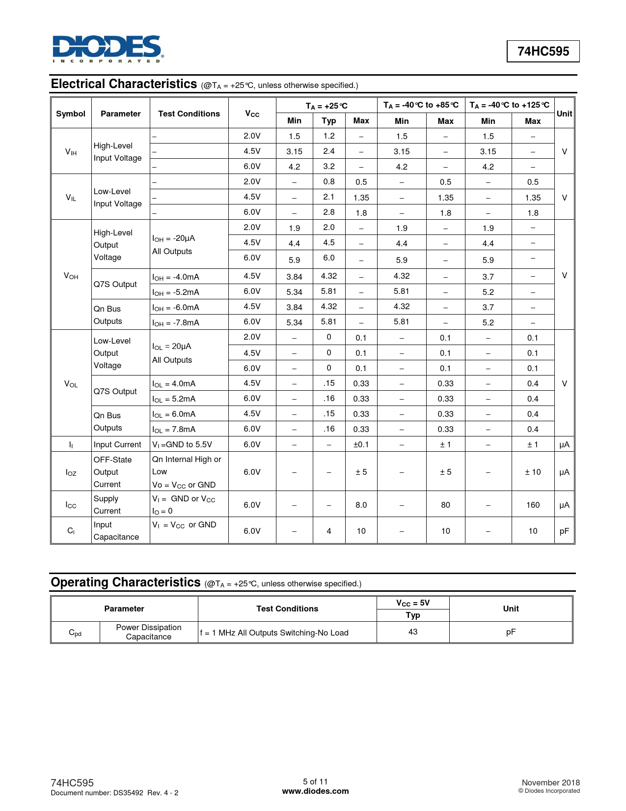

74HC595. Electrical Characteristics. TA = +25°C. TA = -40°C to +85°C. TA = -40°C to +125°C. Symbol. Parameter. Test Conditions. VCC. Unit
74HC595 Electrical Characteristics
(@TA = +25°C, unless otherwise specified.)
TA = +25°C TA = -40°C to +85°C TA = -40°C to +125°C Symbol Parameter Test Conditions VCC Unit Min Typ Max Min Max Min Max
2.0V 1.5 1.2 1.5 1.5 High-Level VIH 4.5V 3.15 2.4 3.15 3.15 V Input Voltage 6.0V 4.2 3.2 4.2 4.2 2.0V 0.8 0.5 0.5 0.5 Low-Level VIL 4.5V 2.1 1.35 1.35 1.35 V Input Voltage 6.0V 2.8 1.8 1.8 1.8 2.0V 1.9 2.0 1.9 1.9 High-Level IOH = -20μA Output 4.5V 4.4 4.5 4.4 4.4 All Outputs Voltage 6.0V 5.9 6.0 5.9 5.9 VOH I V OH = -4.0mA 4.5V 3.84 4.32 4.32 3.7 Q7S Output IOH = -5.2mA 6.0V 5.34 5.81 5.81 5.2 Qn Bus IOH = -6.0mA 4.5V 3.84 4.32 4.32 3.7 Outputs IOH = -7.8mA 6.0V 5.34 5.81 5.81 5.2 Low-Level 2.0V 0 0.1 0.1 0.1 IOL = 20μA Output 4.5V 0 0.1 0.1 0.1 All Outputs Voltage 6.0V 0 0.1 0.1 0.1 VOL IOL = 4.0mA 4.5V .15 0.33 0.33 0.4 V Q7S Output IOL = 5.2mA 6.0V .16 0.33 0.33 0.4 Qn Bus IOL = 6.0mA 4.5V .15 0.33 0.33 0.4 Outputs IOL = 7.8mA 6.0V .16 0.33 0.33 0.4 II Input Current VI =GND to 5.5V 6.0V ±0.1 ± 1 ± 1 μA OFF-State Qn Internal High or IOZ Output Low 6.0V ± 5 ± 5 ± 10 μA Current Vo = VCC or GND Supply VI = GND or VCC ICC 6.0V 8.0 80 160 μA Current IO = 0 Input VI = VCC or GND Ci 6.0V 4 10 10 10 pF Capacitance
Operating Characteristics
VCC = 5V Parameter Test Conditions Unit Typ
Power Dissipation Cpd f = 1 MHz All Outputs Switching-No Load 43 pF Capacitance 74HC595 5 of 11 November 2018 Document number: DS35492 Rev. 4 - 2
