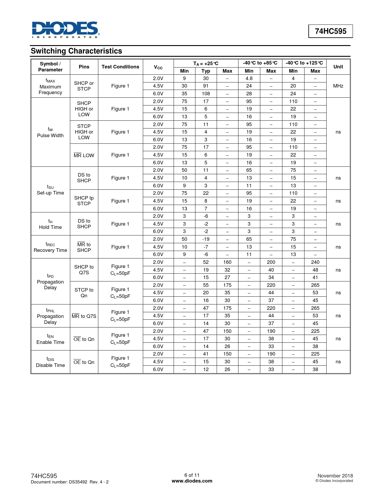

| Manufacturer | Diodes |
| Description | 8-bit Shift Register With 8-bit Output Register |
| Pages / Page | 11 / 6 — 74HC595. Switching Characteristics. Symbol /. TA = +25°C. -40°C to +85°C. … |
| File Format / Size | PDF / 608 Kb |
74HC595. Switching Characteristics. Symbol /. TA = +25°C. -40°C to +85°C. -40°C to +125°C. Pins. Test Conditions. Unit. Parameter. Min. Typ
74HC595 Switching Characteristics Symbol / TA = +25°C -40°C to +85°C -40°C to +125°C Pins Test Conditions V Unit Parameter CC Min Typ Max Min Max Min Max
f 2.0V 9 30 4.8 4 MAX SHCP or Maximum Figure 1 4.5V 30 91 24 20 MHz STCP Frequency 6.0V 35 108 28 24 SHCP 2.0V 75 17 95 110 HIGH or Figure 1 4.5V 15 6 19 22 LOW 6.0V 13 5 16 19 STCP 2.0V 75 11 95 110 tW HIGH or Figure 1 4.5V 15 4 19 22 ns Pulse Width LOW 6.0V 13 3 16 19 2.0V 75 17 95 110 LOW Figure 1 4.5V 15 6 19 22 6.0V 13 5 16 19 2.0V 50 11 65 75 DS to Figure 1 4.5V 10 4 13 15 ns SHCP t 6.0V 9 3 SU 11 13 Set-up Time 2.0V 75 22 95 110 SHCP tp Figure 1 4.5V 15 8 19 22 ns STCP 6.0V 13 7 16 19 2.0V 3 -6 3 3 tH DS to Figure 1 4.5V 3 -2 3 3 ns Hold Time SHCP 6.0V 3 -2 3 3 2.0V 50 -19 65 75 tREC to Figure 1 4.5V 10 -7 13 15 ns Recovery Time SHCP 6.0V 9 -6 11 13 2.0V 52 160 200 240 SHCP to Figure 1 4.5V 19 32 40 48 ns Q7S t CL=50pF PD 6.0V 15 27 34 41 Propagation 2.0V 55 175 220 265 Delay STCP to Figure 1 4.5V 20 35 44 53 ns Qn CL=50pF 6.0V 16 30 37 45 t 2.0V 47 175 220 265 PHL Figure 1 Propagation to Q7S 4.5V 17 35 44 53 ns C Delay L=50pF 6.0V 14 30 37 45 2.0V 47 150 190 225 tEN Figure 1 E to Qn 4.5V 17 30 38 45 ns Enable Time CL=50pF 6.0V 14 26 33 38 2.0V 41 150 190 225 tDIS Figure 1 E to Qn 4.5V 15 30 38 45 ns Disable Time CL=50pF 6.0V 12 26 33 38 74HC595 6 of 11 November 2018 Document number: DS35492 Rev. 4 - 2
