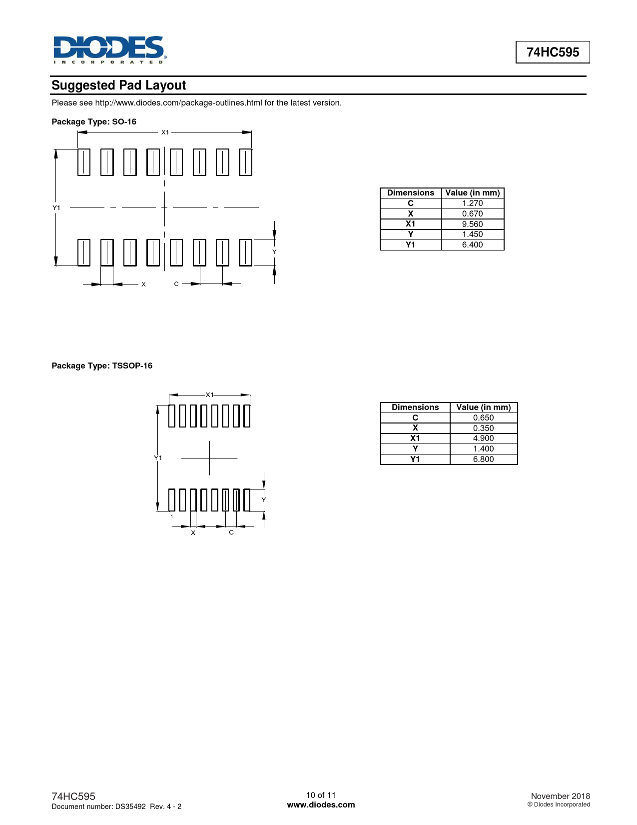

| Pages / Page | 11 / 10 — 74HC595. Suggested Pad Layout. Package Type: SO-16. Dimensions. Value (in … |
| File Format / Size | PDF / 608 Kb |
74HC595. Suggested Pad Layout. Package Type: SO-16. Dimensions. Value (in mm). Package Type: TSSOP-16. www.diodes.com
74HC595 Suggested Pad Layout
Please see http://www.diodes.com/package-outlines.html for the latest version.
Package Type: SO-16
X1
Dimensions Value (in mm) C
1.270
X
0.670
X1
9.560
Y
1.450
Y1
6.400 Y X C
X1
0.650
X
0.350
X1
4.900
Y
1.400 Y1
Y1
6.800 Y 1 X C 74HC595 10 of 11 November 2018 Document number: DS35492 Rev. 4 - 2
