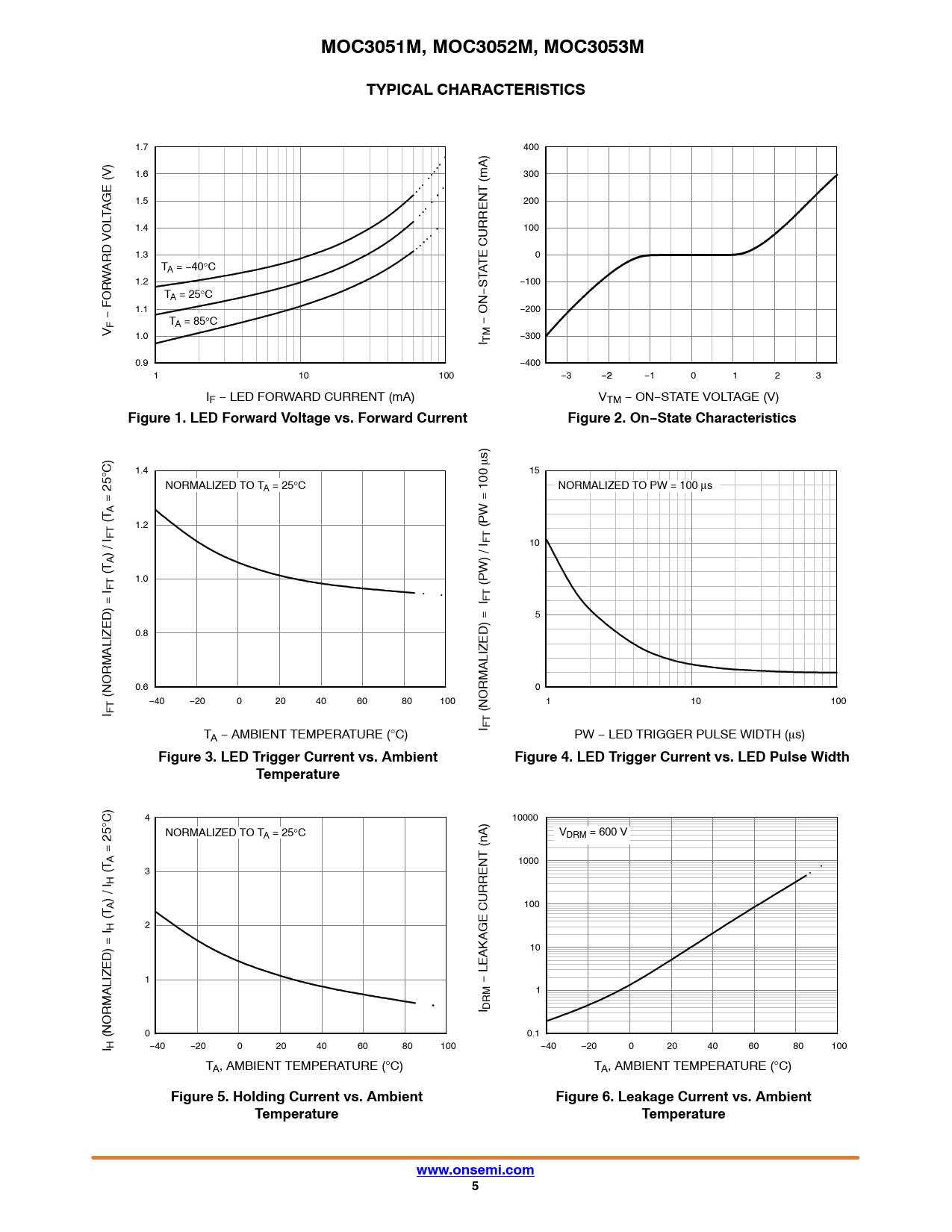

MOC3051M, MOC3052M, MOC3053M. TYPICAL CHARACTERISTICS. Figure 1. LED Forward Voltage vs. Forward Current
MOC3051M, MOC3052M, MOC3053M TYPICAL CHARACTERISTICS Figure 1 LED Forward Voltage vs Forward Current
1.7 400 (V) 1.6 300 1.5 200 TAGE 1.4 100 1.3 0 ARD VOL TA = −40°C W TATE CURRENT (mA) R 1.2 −100 O −S TA = 25°C 1.1 −200 − F TA = 85°C − ON V F 1.0 I TM −300 0.9 −400 1 10 100 −3 −2 − −1 0 1 2 3 IF − LED FORWARD CURRENT (mA) VTM − ON−STATE VOLTAGE (V)
Figure 1. LED Forward Voltage vs. Forward Current Figure 2. On−State Characteristics
ms) °C) 1.4 15 NORMALIZED TO TA = 25°C NORMALIZED TO PW = 100 μs = 25 A (T 1.2 (PW = 100 FT FT 10 ) / I A (T 1.0 FT (PW) / I FT 5 0.8 0.6 0 (NORMALIZED) = I −40 −20 0 20 40 60 80 100 1 10 100 I FT (NORMALIZED) = I I FT TA − AMBIENT TEMPERATURE (°C) PW − LED TRIGGER PULSE WIDTH (ms)
Figure 3. LED Trigger Current vs. Ambient Figure 4. LED Trigger Current vs. LED Pulse Width Temperature
°C) 4 10000 NORMALIZED TO TA = 25°C VDRM = 600 V = 25 A 1000 (T 3 H ) / I A 100 (T H 2 10 1 − LEAKAGE CURRENT (nA) 1 I DRM (NORMALIZED) = I 0 0.1 I H −40 −20 0 20 40 60 80 100 −40 −20 0 20 40 60 80 100 TA, AMBIENT TEMPERATURE (°C) TA, AMBIENT TEMPERATURE (°C)
