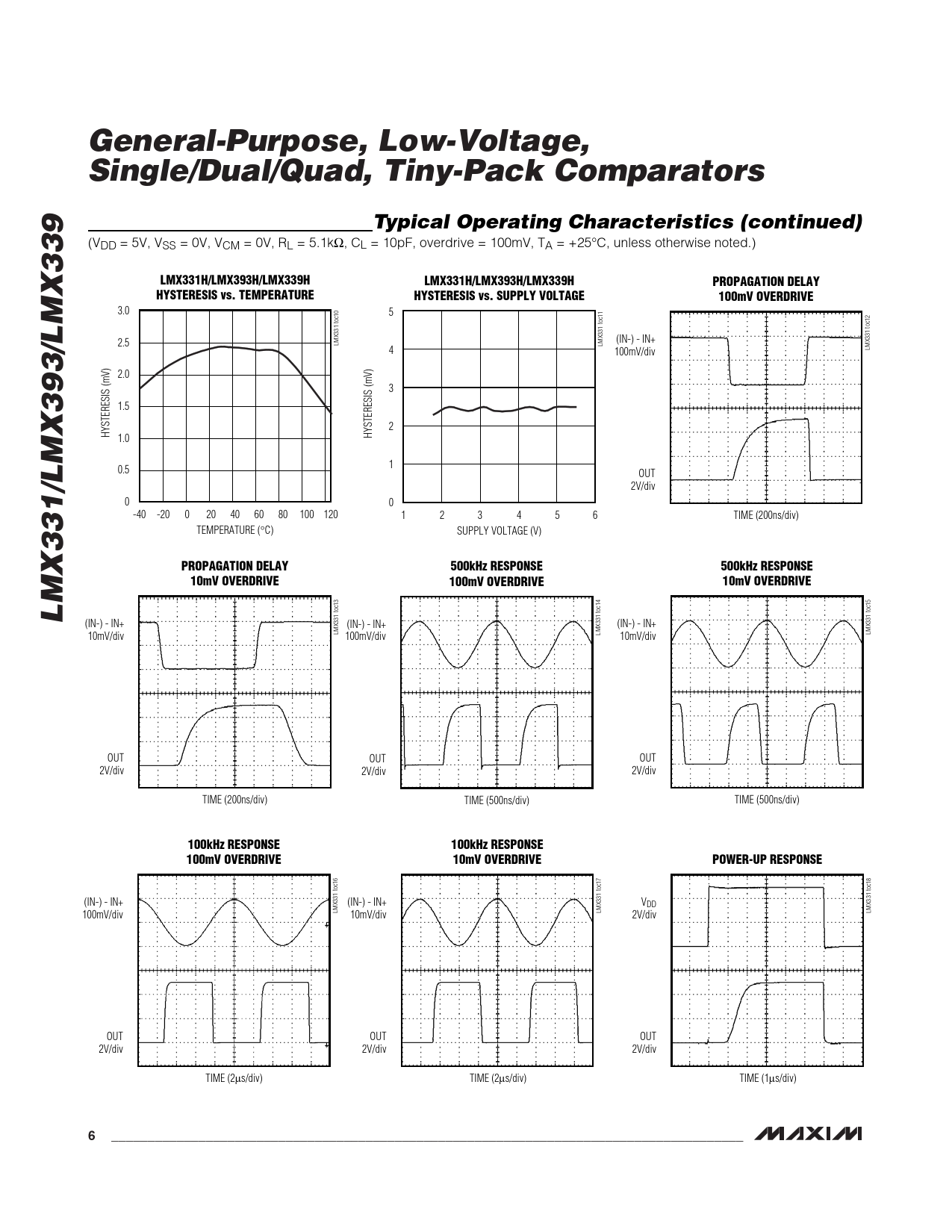

General-Purpose, Low-Voltage, Single/Dual/Quad, Tiny-Pack Comparators. Typical Operating Characteristics (continued)
General-Purpose, Low-Voltage, Single/Dual/Quad, Tiny-Pack Comparators Typical Operating Characteristics (continued)
(VDD = 5V, VSS = 0V, VCM = 0V, RL = 5.1kΩ, CL = 10pF, overdrive = 100mV, TA = +25°C, unless otherwise noted.)
LMX331H/LMX393H/LMX339H LMX331H/LMX393H/LMX339H PROPAGATION DELAY HYSTERESIS vs. TEMPERATURE HYSTERESIS vs. SUPPLY VOLTAGE 100mV OVERDRIVE
3.0 5 2.5 (IN-) - IN+ LMX331 toc10 LMX331 toc11 4 100mV/div LMX331 toc12 2.0 3 1.5 2 HYSTERESIS (mV) 1.0 HYSTERESIS (mV) 1 0.5 OUT 2V/div 0 0 -40 -20 0 20 40 60 80 100 120 1 2 3 4 5 6 TIME (200ns/div) TEMPERATURE (°C) SUPPLY VOLTAGE (V)
PROPAGATION DELAY 500kHz RESPONSE 500kHz RESPONSE 10mV OVERDRIVE 100mV OVERDRIVE 10mV OVERDRIVE LMX331/LMX393/LMX339
(IN-) - IN+ (IN-) - IN+ (IN-) - IN+ 10mV/div LMX331 toc13 100mV/div LMX331 toc14 10mV/div LMX331 toc15 OUT OUT OUT 2V/div 2V/div 2V/div TIME (200ns/div) TIME (500ns/div) TIME (500ns/div)
100kHz RESPONSE 100kHz RESPONSE 100mV OVERDRIVE 10mV OVERDRIVE POWER-UP RESPONSE
(IN-) - IN+ (IN-) - IN+ VDD 100mV/div LMX331 toc16 10mV/div LMX331 toc17 2V/div LMX331 toc18 OUT OUT OUT 2V/div 2V/div 2V/div TIME (2μs/div) TIME (2μs/div) TIME (1μs/div)
