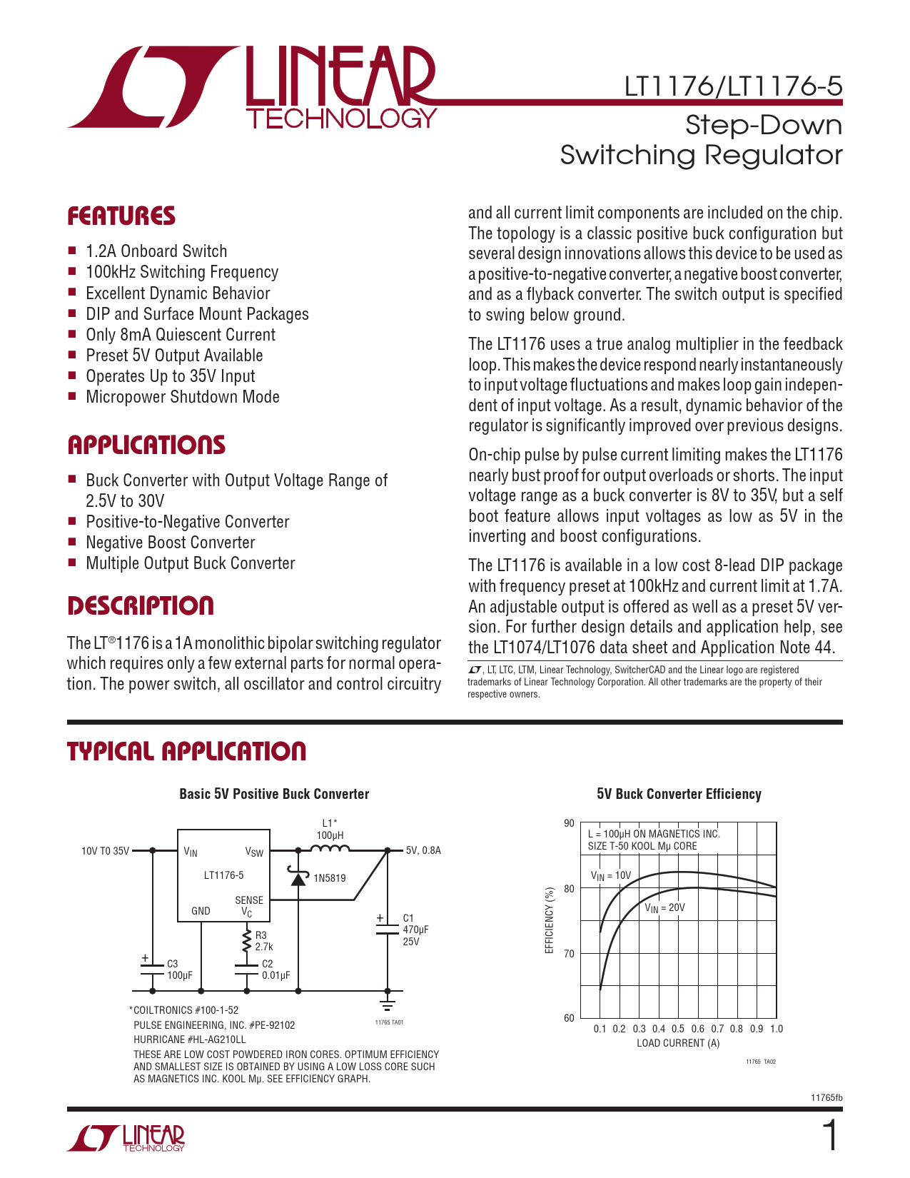

TYPICAL APPLICATION Basic 5V Positive Buck Converter 5V Buck Converter Efficiency
L1* 90 100µH L = 100µH ON MAGNETICS INC. 10V T0 35V V 5V, 0.8A SIZE T-50 KOOL Mµ CORE IN VSW LT1176-5 1N5819 VIN = 10V 80 SENSE GND V V C + IN = 20V C1 R3 470µF 2.7k 25V + EFFICIENCY (%) 70 C3 C2 100µF 0.01µF *COILTRONICS #100-1-52 60 11765 TA01 PULSE ENGINEERING, INC. #PE-92102 0.1 0.2 0.3 0.4 0.5 0.6 0.7 0.8 0.9 1.0 HURRICANE #HL-AG210LL LOAD CURRENT (A) THESE ARE LOW COST POWDERED IRON CORES. OPTIMUM EFFICIENCY AND SMALLEST SIZE IS OBTAINED BY USING A LOW LOSS CORE SUCH 11765 TA02 AS MAGNETICS INC. KOOL Mµ. SEE EFFICIENCY GRAPH. 11765fb 1 Document Outline Features Applications Description Typical Application Absolute Maximum Ratings Pin Configuration Order Information Electrical Characteristics Block Diagram Package Description Revision History Package Description
