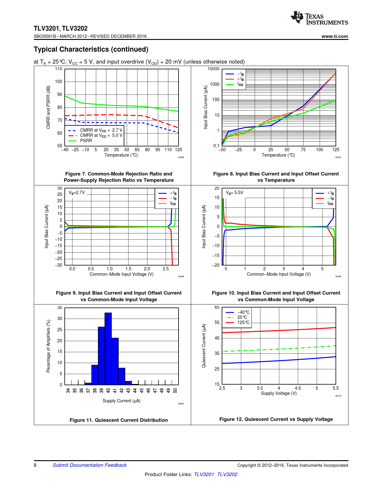

TLV3201,. TLV3202. www.ti.com. Typical Characteristics (continued). Figure 7. Common-Mode Rejection Ratio and
TLV3201, TLV3202
SBOS561B – MARCH 2012 – REVISED DECEMBER 2016
www.ti.com Typical Characteristics (continued)
at TA = 25°C, VCC = 5 V, and input overdrive (VOD) = 20 mV (unless otherwise noted) 110 10000 − I
B
+ I 100
B
1000 I
OS
90 100 80 10 70 CMRR and PSRR (dB) Input Bias Current (pA) CMRR at V 1 60
CC
= 2.7 V CMRR at V
CC
= 5.0 V PSRR 50 0.1 −40 −25 −10 5 20 35 50 65 80 95 110 125 −50 −25 0 25 50 75 100 125 Temperature (°C) Temperature (°C) G006 G002
Figure 7. Common-Mode Rejection Ratio and Figure 8. Input Bias Current and Input Offset Current Power-Supply Rejection Ratio vs Temperature vs Temperature
30 20 V V
S
= 5.5V +
S
=2.7V + 25 I
B
I
B
− I 15 − I 20
B B
I
OS
I
OS
15 10 10 5 5 0 0 −5 −5 −10 −15 Input Bias Current (pA) −10 Input Bias Current (pA) −20 −15 −25 −30 −20 0.0 0.5 1.0 1.5 2.0 2.5 0 1 2 3 4 5 Common−Mode Input Voltage (V) Common−Mode Input Voltage (V) G006 G006
Figure 9. Input Bias Current and Input Offset Current Figure 10. Input Bias Current and Input Offset Current vs Common-Mode Input Voltage vs Common-Mode Input Voltage
35 65 −40°C 30 25°C 55 125°C 25 45 20 15 35 10 Quiescent Current (µA) 25 Pecentage of Amplifiers (%) 5 0 152.5 3 3.5 4 4.5 5 5.5 34 35 36 37 38 39 40 41 42 43 44 45 46 47 48 49 50 Supply Voltage (V) G018 Supply Current (µA) G000
Figure 11. Quiescent Current Distribution Figure 12. Quiescent Current vs Supply Voltage
