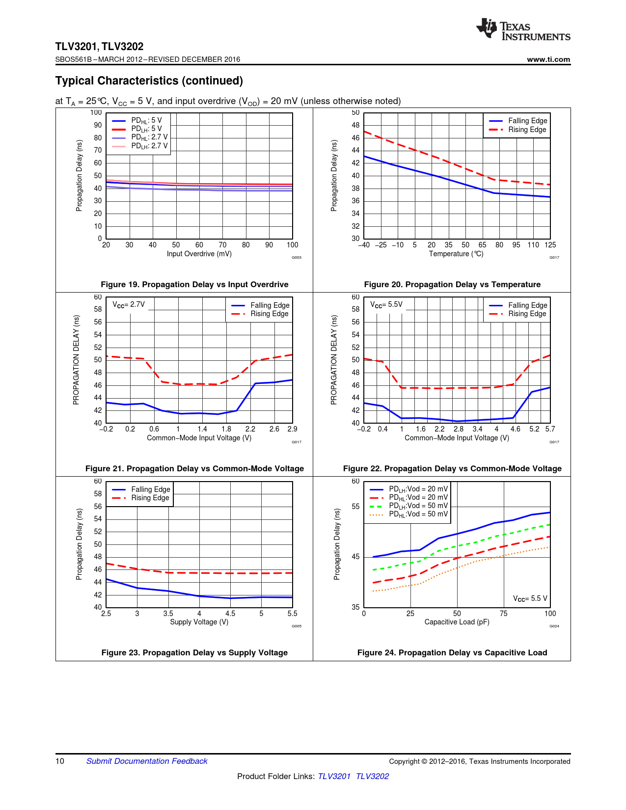

TLV3201,. TLV3202. www.ti.com. Typical Characteristics (continued). Figure 19. Propagation Delay vs Input Overdrive
TLV3201, TLV3202 www.ti.com Typical Characteristics (continued) Figure 19 Propagation Delay vs Input Overdrive
TLV3201, TLV3202
SBOS561B – MARCH 2012 – REVISED DECEMBER 2016
at TA = 25°C, VCC = 5 V, and input overdrive (VOD) = 20 mV (unless otherwise noted) 100 50 PD Falling Edge 90 HL: 5 V 48 PDLH: 5 V Rising Edge 80 PDHL: 2.7 V 46 PD 70 LH: 2.7 V 44 60 42 50 40 40 38 30 36 Propagation Delay (ns) Propagation Delay (ns) 20 34 10 32 0 30 20 30 40 50 60 70 80 90 100 −40 −25 −10 5 20 35 50 65 80 95 110 125 Input Overdrive (mV) Temperature (°C) G003 G017
Figure 19. Propagation Delay vs Input Overdrive Figure 20. Propagation Delay vs Temperature
60 60 V
CC
= 2.7V Falling Edge V
CC
= 5.5V Falling Edge 58 58 Rising Edge Rising Edge 56 56 54 54 52 52 50 50 48 48 46 46 44 44 PROPAGATION DELAY (ns) PROPAGATION DELAY (ns) 42 42 40 40 −0.2 0.2 0.6 1 1.4 1.8 2.2 2.6 2.9 −0.2 0.4 1 1.6 2.2 2.8 3.4 4 4.6 5.2 5.7 Common−Mode Input Voltage (V) Common−Mode Input Voltage (V) G017 G017
Figure 21. Propagation Delay vs Common-Mode Voltage Figure 22. Propagation Delay vs Common-Mode Voltage
60 60 Falling Edge PD 58 LH:Vod = 20 mV Rising Edge PDHL:Vod = 20 mV 56 55 PDLH:Vod = 50 mV PD 54 HL:Vod = 50 mV 52 50 48 45 46 Propagation Delay (ns) Propagation Delay (ns) 44 42 V
CC
= 5.5 V 40 35 2.5 3 3.5 4 4.5 5 5.5 0 25 50 75 100 Supply Voltage (V) Capacitive Load (pF) G005 G024
Figure 23. Propagation Delay vs Supply Voltage Figure 24. Propagation Delay vs Capacitive Load
