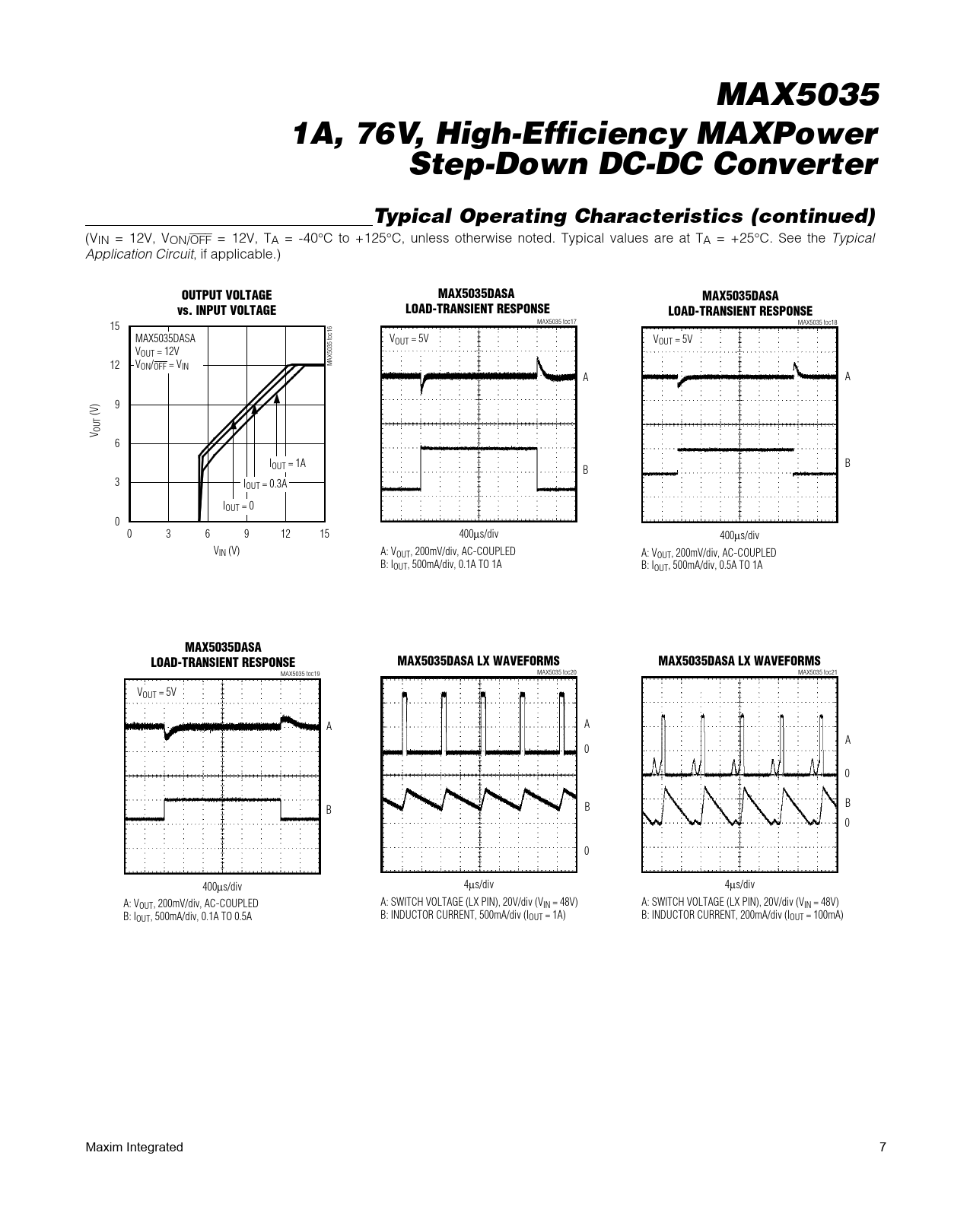

1A, 76V, High-Efficiency MAXPower. Step-Down DC-DC Converter. Typical Operating Characteristics (continued). OUTPUT VOLTAGE
MAX5035
1A, 76V, High-Efficiency MAXPower Step-Down DC-DC Converter Typical Operating Characteristics (continued)
(VIN = 12V, VON/OFF = 12V, TA = -40°C to +125°C, unless otherwise noted. Typical values are at TA = +25°C. See the Typical Application Circuit, if applicable.)
OUTPUT VOLTAGE MAX5035DASA MAX5035DASA vs. INPUT VOLTAGE LOAD-TRANSIENT RESPONSE LOAD-TRANSIENT RESPONSE
15 MAX5035 toc17 MAX5035 toc18 MAX5035DASA VOUT = 5V VOUT = 5V VOUT = 12V MAX5035 toc16 12 VON/OFF = VIN A A 9 (V) V OUT 6 IOUT = 1A B B 3 IOUT = 0.3A IOUT = 0 0 0 3 6 9 12 15 400µs/div 400µs/div VIN (V) A: VOUT, 200mV/div, AC-COUPLED A: VOUT, 200mV/div, AC-COUPLED B: IOUT, 500mA/div, 0.1A TO 1A B: IOUT, 500mA/div, 0.5A TO 1A
MAX5035DASA LOAD-TRANSIENT RESPONSE MAX5035DASA LX WAVEFORMS MAX5035DASA LX WAVEFORMS
MAX5035 toc19 MAX5035 toc20 MAX5035 toc21 VOUT = 5V A A A 0 0 B B B 0 0 400µs/div 4µs/div 4µs/div A: VOUT, 200mV/div, AC-COUPLED A: SWITCH VOLTAGE (LX PIN), 20V/div (VIN = 48V) A: SWITCH VOLTAGE (LX PIN), 20V/div (VIN = 48V) B: IOUT, 500mA/div, 0.1A TO 0.5A B: INDUCTOR CURRENT, 500mA/div (IOUT = 1A) B: INDUCTOR CURRENT, 200mA/div (IOUT = 100mA) Maxim Integrated 7
