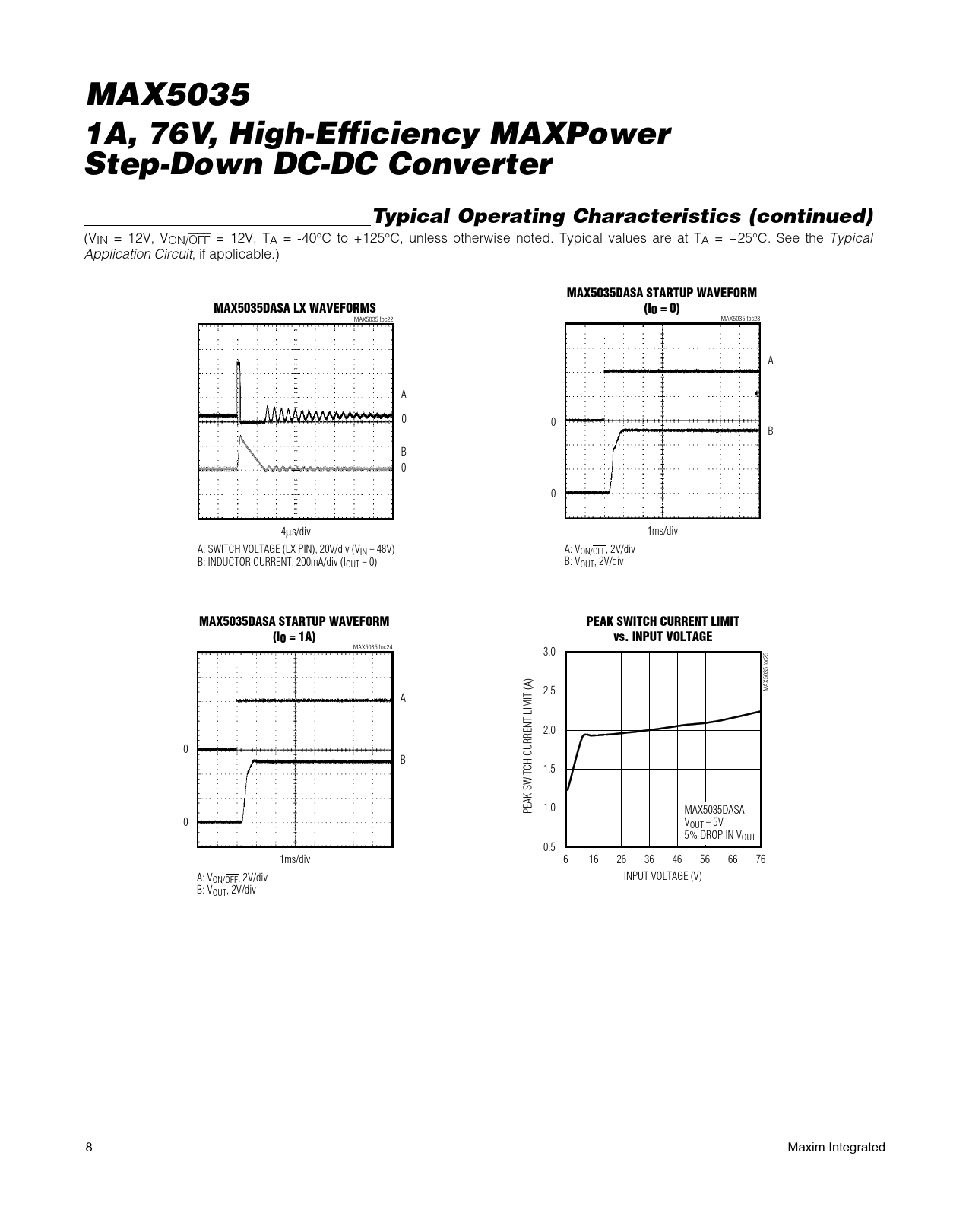

1A, 76V, High-Efficiency MAXPower Step-Down DC-DC Converter. Typical Operating Characteristics (continued)
MAX5035
1A, 76V, High-Efficiency MAXPower Step-Down DC-DC Converter Typical Operating Characteristics (continued)
(VIN = 12V, VON/OFF = 12V, TA = -40°C to +125°C, unless otherwise noted. Typical values are at TA = +25°C. See the Typical Application Circuit, if applicable.)
MAX5035DASA STARTUP WAVEFORM MAX5035DASA LX WAVEFORMS (IO = 0)
MAX5035 toc22 MAX5035 toc23 A A 0 0 B B 0 0 4µs/div 1ms/div A: SWITCH VOLTAGE (LX PIN), 20V/div (VIN = 48V) A: VON/OFF, 2V/div B: INDUCTOR CURRENT, 200mA/div (IOUT = 0) B: VOUT, 2V/div
MAX5035DASA STARTUP WAVEFORM PEAK SWITCH CURRENT LIMIT (IO = 1A) vs. INPUT VOLTAGE
MAX5035 toc24 3.0 MAX5035 toc25 2.5 A 2.0 0 B 1.5 PEAK SWITCH CURRENT LIMIT (A) 1.0 MAX5035DASA 0 VOUT = 5V 5% DROP IN VOUT 0.5 1ms/div 6 16 26 36 46 56 66 76 A: VON/OFF, 2V/div INPUT VOLTAGE (V) B: VOUT, 2V/div 8 Maxim Integrated
