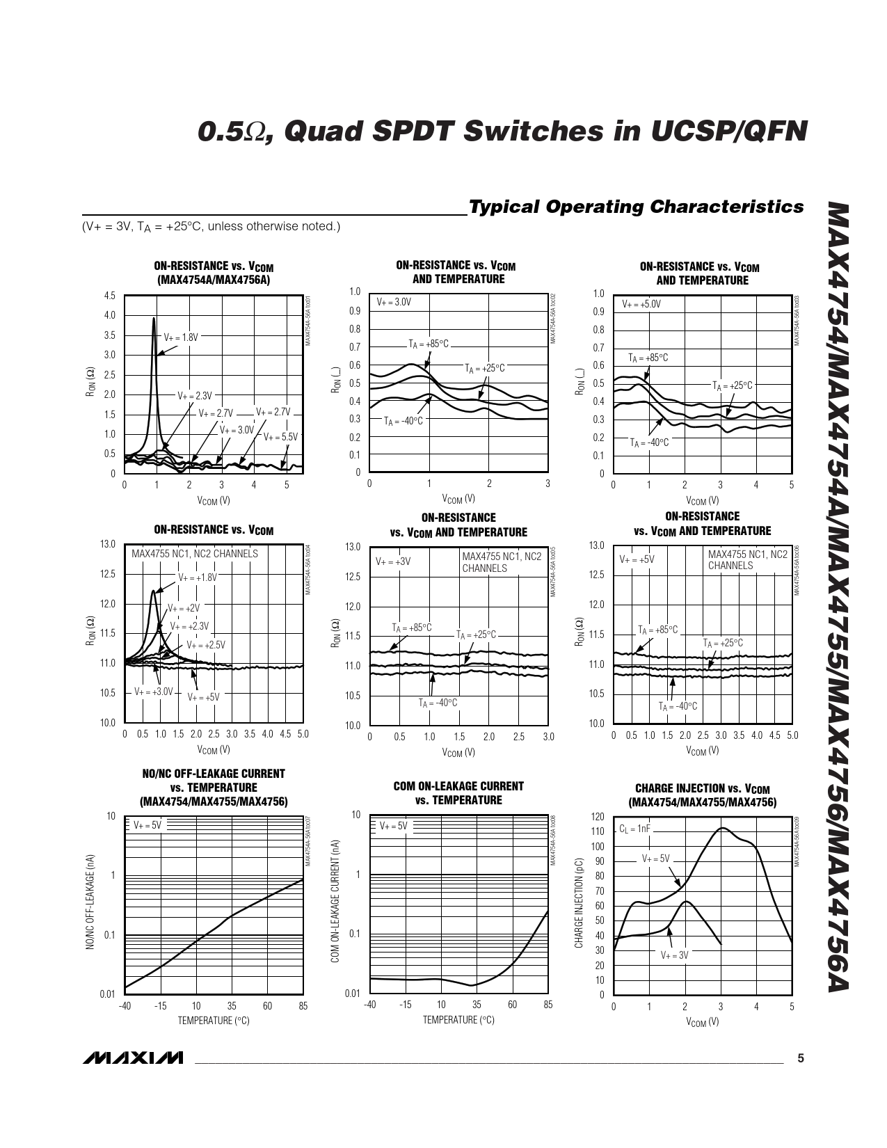

0.5. , Quad SPDT Switches in UCSP/QFN. MAX4754/MAX4754A/MAX4755/MAX4756/MAX4756A. Typical Operating Characteristics
0.5
Ω
, Quad SPDT Switches in UCSP/QFN MAX4754/MAX4754A/MAX4755/MAX4756/MAX4756A Typical Operating Characteristics
(V+ = 3V, TA = +25°C, unless otherwise noted.)
ON-RESISTANCE vs. VCOM ON-RESISTANCE vs. VCOM ON-RESISTANCE vs. VCOM (MAX4754A/MAX4756A) AND TEMPERATURE AND TEMPERATURE
4.5 1.0 1.0 V+ = 3.0V V+ = +5.0V 4.0 0.9 0.9 0.8 0.8 3.5 V+ = 1.8V MAX4754A-56A toc01 MAX4754A-56A toc02 0.7 TA = +85°C 0.7 MAX4754A-56A toc03 3.0 TA = +85°C ) 0.6 0.6 Ω T 2.5 A = +25°C ( (_) (_) 0.5 0.5 TA = +25°C R ON R ON 2.0 V+ = 2.3V R ON 0.4 0.4 1.5 V+ = 2.7V V+ = 2.7V 0.3 TA = -40°C 0.3 1.0 V+ = 3.0V V+ = 5.5V 0.2 0.2 TA = -40°C 0.5 0.1 0.1 0 0 0 0 1 2 3 4 5 0 1 2 3 0 1 2 3 4 5 VCOM (V) VCOM (V) VCOM (V)
ON-RESISTANCE ON-RESISTANCE ON-RESISTANCE vs. VCOM vs. VCOM AND TEMPERATURE vs. VCOM AND TEMPERATURE
13.0 13.0 13.0 MAX4755 NC1, NC2 CHANNELS MAX4755 NC1, NC2 V+ = +3V MAX4755 NC1, NC2 V+ = +5V CHANNELS CHANNELS 12.5 V+ = +1.8V 12.5 12.5 MAX4754A-56A toc04 MAX4754A-56A toc05 MAX4754A-56A toc06 12.0 V+ = +2V 12.0 12.0 ) Ω ) ( V+ = +2.3V Ω T Ω ( 11.5 ( A = +85°C T 11.5 T A = +85°C A = +25°C 11.5 R ON V+ = +2.5V R ON R ON TA = +25°C 11.0 11.0 11.0 10.5 V+ = +3.0V V+ = +5V 10.5 10.5 TA = -40°C TA = -40°C 10.0 10.0 10.0 0 0.5 1.0 1.5 2.0 2.5 3.0 3.5 4.0 4.5 5.0 0 0.5 1.0 1.5 2.0 2.5 3.0 0 0.5 1.0 1.5 2.0 2.5 3.0 3.5 4.0 4.5 5.0 VCOM (V) VCOM (V) VCOM (V)
NO/NC OFF-LEAKAGE CURRENT vs. TEMPERATURE COM ON-LEAKAGE CURRENT CHARGE INJECTION vs. VCOM (MAX4754/MAX4755/MAX4756) vs. TEMPERATURE (MAX4754/MAX4755/MAX4756)
10 10 120 V+ = 5V V+ = 5V 110 CL = 1nF 100 V+ = 5V MAX4754A-56A toc07 MAX4754A-56A toc08 90 MAX4754A-56A toc09 1 1 80 70 60 50 0.1 0.1 40 NO/NC OFF-LEAKAGE (nA) CHARGE INJECTION (pC) 30 COM ON-LEAKAGE CURRENT (nA) V+ = 3V 20 10 0.01 0.01 0 -40 -15 10 35 60 85 -40 -15 10 35 60 85 0 1 2 3 4 5 TEMPERATURE (°C) TEMPERATURE (°C) VCOM (V)
