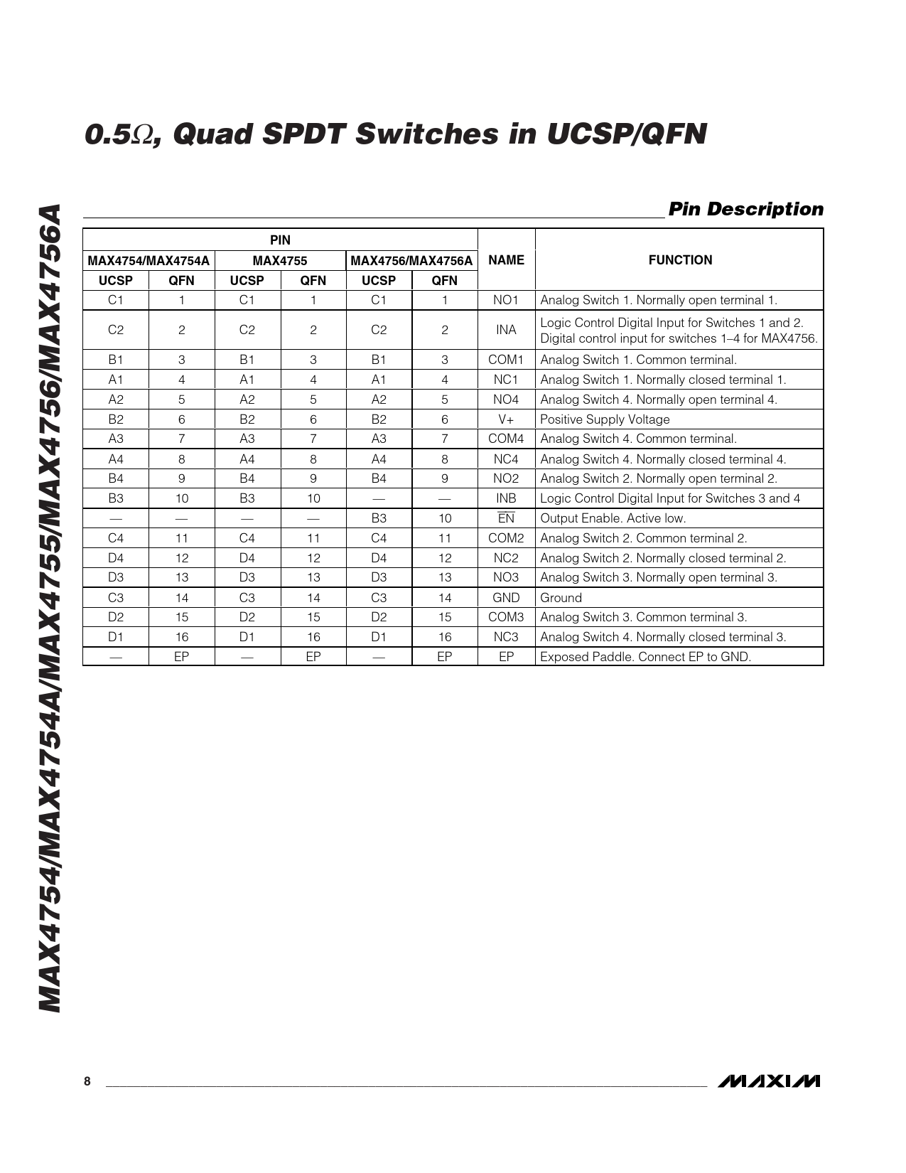

0.5. , Quad SPDT Switches in UCSP/QFN. Pin Description. PIN. MAX4754/MAX4754A. MAX4755. MAX4756/MAX4756A. NAME. FUNCTION. UCSP. QFN
0.5
Ω
, Quad SPDT Switches in UCSP/QFN Pin Description PIN MAX4754/MAX4754A MAX4755 MAX4756/MAX4756A NAME FUNCTION UCSP QFN UCSP QFN UCSP QFN
C1 1 C1 1 C1 1 NO1 Analog Switch 1. Normally open terminal 1. Logic Control Digital Input for Switches 1 and 2. C2 2 C2 2 C2 2 INA Digital control input for switches 1–4 for MAX4756. B1 3 B1 3 B1 3 COM1 Analog Switch 1. Common terminal. A1 4 A1 4 A1 4 NC1 Analog Switch 1. Normally closed terminal 1. A2 5 A2 5 A2 5 NO4 Analog Switch 4. Normally open terminal 4. B2 6 B2 6 B2 6 V+ Positive Supply Voltage A3 7 A3 7 A3 7 COM4 Analog Switch 4. Common terminal. A4 8 A4 8 A4 8 NC4 Analog Switch 4. Normally closed terminal 4. B4 9 B4 9 B4 9 NO2 Analog Switch 2. Normally open terminal 2. B3 10 B3 10 — — INB Logic Control Digital Input for Switches 3 and 4 — — — — B3 10 EN Output Enable. Active low. C4 11 C4 11 C4 11 COM2 Analog Switch 2. Common terminal 2. D4 12 D4 12 D4 12 NC2 Analog Switch 2. Normally closed terminal 2. D3 13 D3 13 D3 13 NO3 Analog Switch 3. Normally open terminal 3. C3 14 C3 14 C3 14 GND Ground D2 15 D2 15 D2 15 COM3 Analog Switch 3. Common terminal 3. D1 16 D1 16 D1 16 NC3 Analog Switch 4. Normally closed terminal 3. — EP — EP — EP EP Exposed Paddle. Connect EP to GND.
