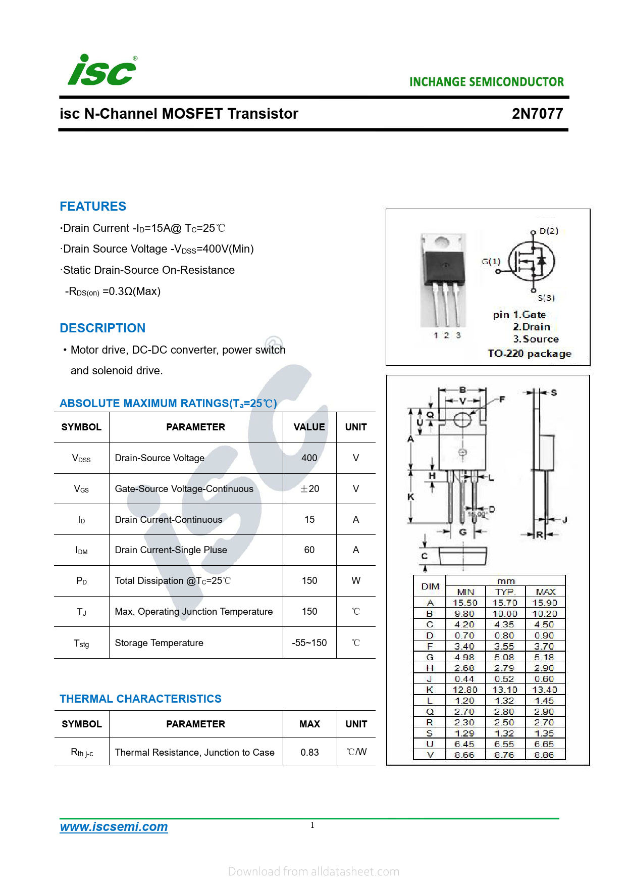

isc N-Channel MOSFET Transistor. 2N7077. FEATURES ·. DESCRIPTION. ABSOLUTE MAXIMUM RATINGS(Ta=25. SYMBOL. PARAMETER. VALUE. UNIT
isc N-Channel MOSFET Transistor 2N7077 FEATURES ·
Drain Current -ID=15A@ TC=25℃ ·Drain Source Voltage -VDSS=400V(Min) ·Static Drain-Source On-Resistance -RDS(on) =0.3Ω(Max)
DESCRIPTION
·Motor drive, DC-DC converter, power switch and solenoid drive.
) SYMBOL PARAMETER VALUE UNIT
VDSS Drain-Source Voltage 400 V VGS Gate-Source Voltage-Continuous ±20 V ID Drain Current-Continuous 15 A IDM Drain Current-Single Pluse 60 A PD Total Dissipation @TC=25℃ 150 W TJ Max. Operating Junction Temperature 150 ℃ Tstg Storage Temperature -55~150 ℃
THERMAL CHARACTERISTICS SYMBOL PARAMETER MAX UNIT
Rth j-c Thermal Resistance, Junction to Case 0.83 ℃/W
