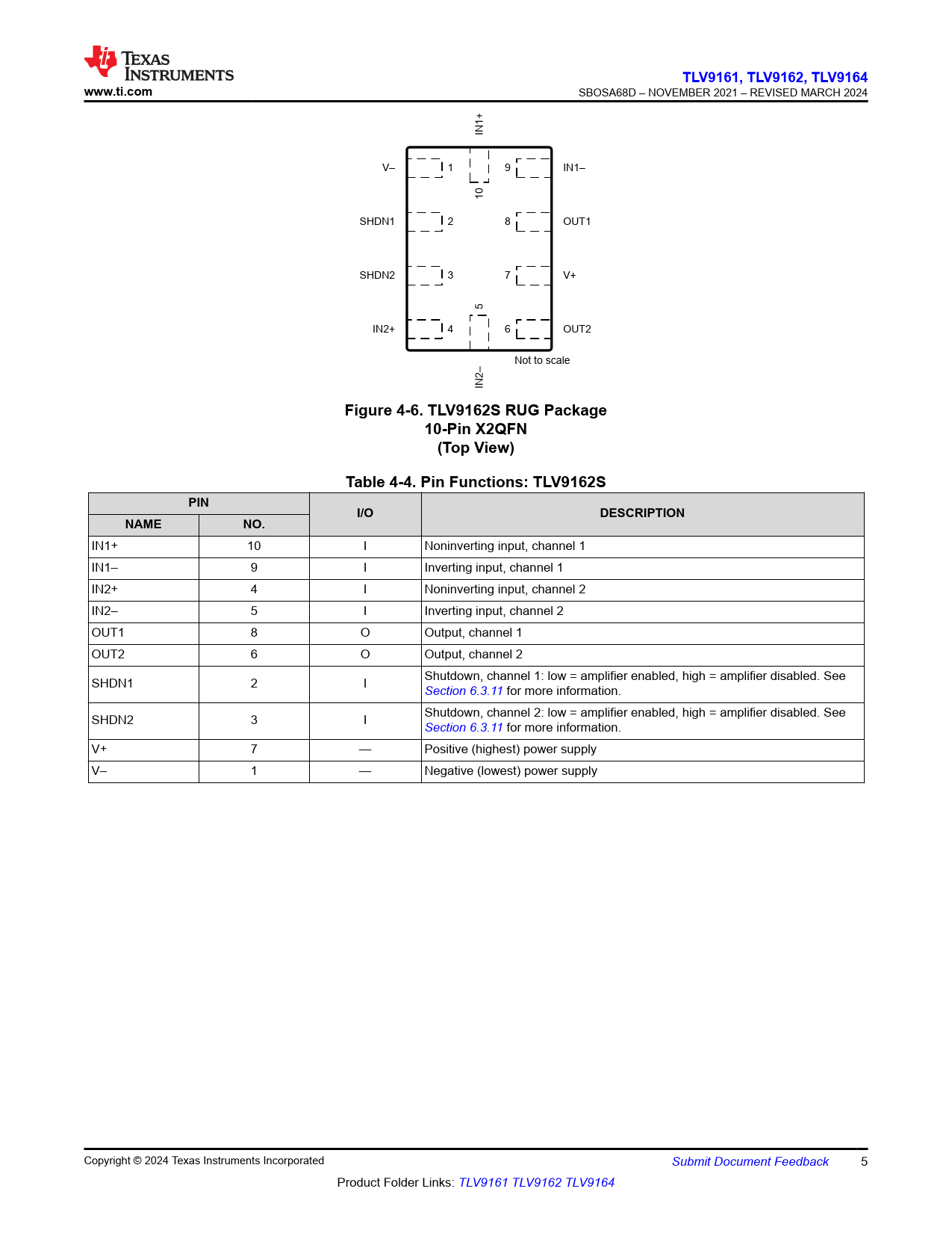

TLV9161,. TLV9162, TL. V9164. www.ti.com. Figure 4-6. TLV9162S RUG Package. 10-Pin X2QFN. (Top View)
link to page 26 link to page 26
TLV9161, TLV9162, TL V9164 www.ti.com
SBOSA68D – NOVEMBER 2021 – REVISED MARCH 2024 IN1+ V– 1 9 IN1– 10 SHDN1 2 8 OUT1 SHDN2 3 7 V+ 5 IN2+ 4 6 OUT2 Not to scale IN2–
Figure 4-6. TLV9162S RUG Package 10-Pin X2QFN (Top View) Table 4-4. Pin Functions: TLV9162S PIN I/O DESCRIPTION NAME NO.
IN1+ 10 I Noninverting input, channel 1 IN1– 9 I Inverting input, channel 1 IN2+ 4 I Noninverting input, channel 2 IN2– 5 I Inverting input, channel 2 OUT1 8 O Output, channel 1 OUT2 6 O Output, channel 2 Shutdown, channel 1: low = amplifier enabled, high = amplifier disabled. See SHDN1 2 I Section 6.3.11 for more information. Shutdown, channel 2: low = amplifier enabled, high = amplifier disabled. See SHDN2 3 I Section 6.3.11 for more information. V+ 7 — Positive (highest) power supply V– 1 — Negative (lowest) power supply Copyright © 2024 Texas Instruments Incorporated Submit Document Feedback 5 Product Folder Links: TLV9161 TLV9162 TLV9164 Document Outline 1 Features 2 Applications 3 Description Table of Contents 4 Pin Configuration and Functions 5 Specifications 5.1 Absolute Maximum Ratings 5.2 ESD Ratings 5.3 Recommended Operating Conditions 5.4 Thermal Information for Single Channel 5.5 Thermal Information for Dual Channel 5.6 Thermal Information for Quad Channel 5.7 Electrical Characteristics 5.8 Typical Characteristics 6 Detailed Description 6.1 Overview 6.2 Functional Block Diagram 6.3 Feature Description 6.3.1 Input Protection Circuitry 6.3.2 EMI Rejection 6.3.3 Thermal Protection 6.3.4 Capacitive Load and Stability 6.3.5 Common-Mode Voltage Range 6.3.6 Phase Reversal Protection 6.3.7 Electrical Overstress 6.3.8 Overload Recovery 6.3.9 Typical Specifications and Distributions 6.3.10 Packages With an Exposed Thermal Pad 6.3.11 Shutdown 6.4 Device Functional Modes 7 Application and Implementation 7.1 Application Information 7.2 Typical Applications 7.2.1 Low-Side Current Measurement 7.2.1.1 Design Requirements 7.2.1.2 Detailed Design Procedure 7.2.1.3 Application Curve 7.2.2 Buffered Multiplexer 7.3 Power Supply Recommendations 7.4 Layout 7.4.1 Layout Guidelines 7.4.2 Layout Example 8 Device and Documentation Support 8.1 Device Support 8.1.1 Development Support 8.1.1.1 TINA-TI™ (Free Software Download) 8.2 Documentation Support 8.2.1 Related Documentation 8.3 Receiving Notification of Documentation Updates 8.4 Support Resources 8.5 Trademarks 8.6 Electrostatic Discharge Caution 8.7 Glossary 9 Revision History 10 Mechanical, Packaging, and Orderable Information
